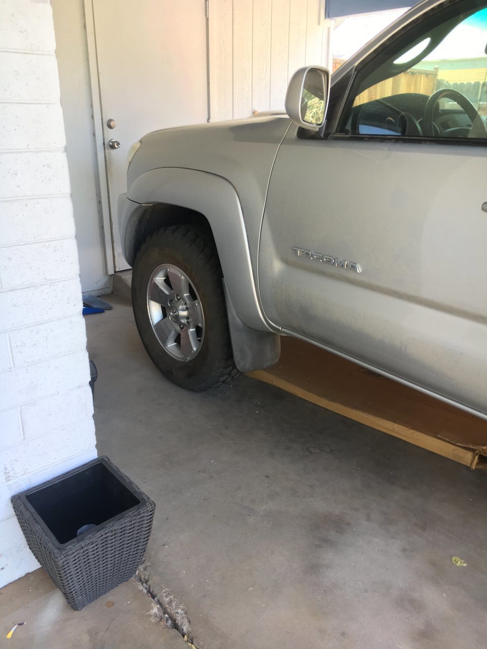

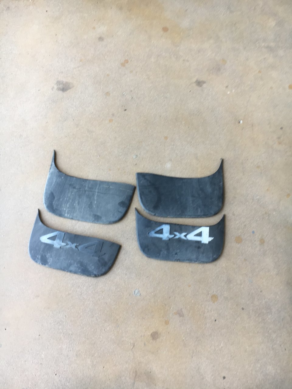

    20 mins, no science. Traced template on cardboard. R on one side, flipped it L on the other. Went around truck tracing onto the flaps with template. Cut them with 6$ ace hardware tin snips. Sanded with 600 then 320
    Front bottom of flap to ground- 9 in
    Rear bottom of flap to ground- 11 in
    Hoping the rocks and dust polish them off further.
