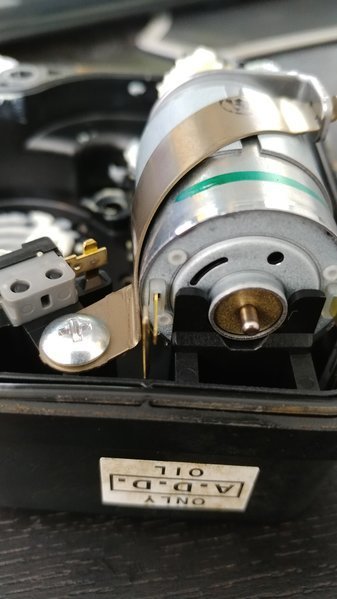

    Sorry guys I used the wrong lingo here...
    Yes the fork goes left and right...
    My question is, while the add actuator is in your hand before installing, is there and wiggle in the fork up and down??

    '12 t|x pro
    well here is the inside of my original add actuator....

    for anyone who is installing a New ADD actuator.
    might be worth opening it up and sealing it properly, as you can see from the pictures I have provided the factory sealing job is less than stellar.
    I also bent the prongs and soldered the points on my new one before installing.

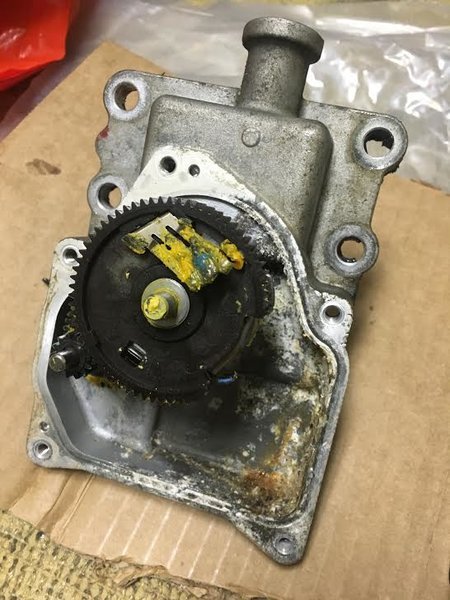

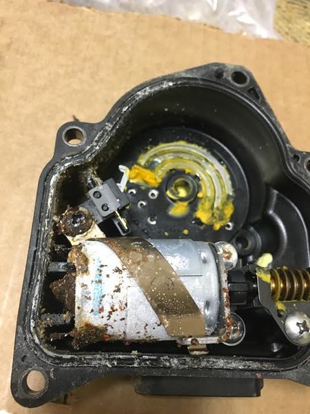

    Just wanna bump this. Thanks again @blackhawke88 for posting this. Just regeared and afterwords my 4x4 wouldn't turn on, the light just kept blinking. The ADD actuator on the transfer case engaged and driveshaft was spinning but I couldn't get the front diff to engage and didn't hear anything happening from the actuator. Just now pulled mine off and found this-
    .jpg
    Threw some solder on all the electrical connections just for shits n giggles, waiting on RTV to firm up before I add oil and take it for a spin.
    That upper most bolt is a bitch to get in and out, even pulling the diff bolts to drop it a bit lol
    blackhawke88[OP] likes this.

    Front- Camburg 4x4 Long Travel 2.5" King Coilovers 2.5" King Triple Bypasses Wheelers Superbumps Rear- DMZ SUA 16" 3.0 King Triple Bypasses 3" 2.0 Fox bumps Wheels and Tires- 295/75/16 Toyo ATII XTREME SCS SR8 Dark Matte Bronze 16" Lighting- (2) 30" Combo light bars (4) Iggycorp diffused pods Tepui Ayer TRD Supercharger URD Mark III 3" Exhaust URD 4x4 Y Pipe URD CAI URD 2.85 Stealth Pulley Hurst Core Shifter with Hurst T URD Stage 3 clutch URD Lightweight flywheel URD Throw out bearing upgrade AEM Wideband AFR Gauge Speedhut Boost Gauge Craven Speed Flex Pod mount Weathertech Floor Liners BAMF Sliders Ultragauge sPod SE ARB CKMTA12 Hella Supertone horns Relentless Tailgate Reinforcement
    Yeah I'm probably gonna pick up a spare someday soon for if mine goes out again. everything looks brand new inside the actuator..the prongs were so far apart it wasn't even arcing at all. Just shoddy design right there. Save thousands of dollars in warranty work and put a spot of solder on it at the factory. jeez.
