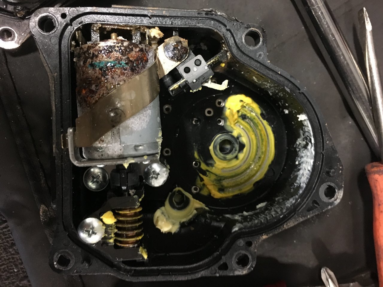

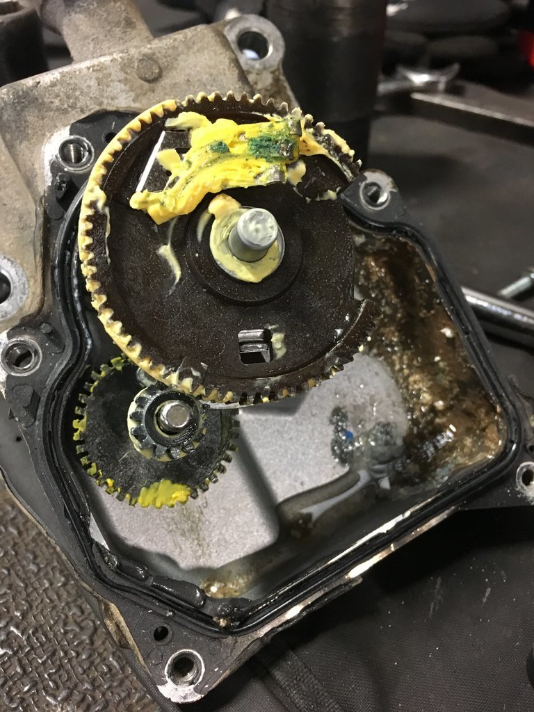

    alright well my 2012 off road tacoma with manual transmission has these pesky bull shit 4wd problems again.... yes, again, already, after going through all this earlier in the year...
    below are pictures taken today by me from the front actuator I pulled off my truck... Please note this was installed back in March of this year and has only been on the truck for roughly 5k miles... Prior to installing I opened the black cover and soldered all the points as well as sealed the cover with rtv. This was a brand new factory toyota part purchased from a toyota dealerhsip off ebay.
    I do NOT drive in deep water frequently, in fact I have really only crossed deep water one or two times in the past 5k miles....
    There was a puddle inside this thing... My local mechanic is throwing blame here at the factory breather that sits in the engine bay at the same hight as the plastic engine cover... I have a hard time accepting that this much water is getting in from that breather given its location and my lack of frequency driving through water any deeper than what us found on a typical street puddle or just your typical rainy weather & pavement pounding commutes...
    GilbertOz and CapeBretonExo like this.

    So here is the kicker.... Before removing the actuator pictured above please note my following symptoms:
    I did Not have the blinking 4hi light issue while in 2wd.
    I did have a rotary dial that would go from 2wd into 4hi, confirming I was indeed in 4hi by way of feeling the binding in the steering wheel while turning, however though I was confirmed in 4hi my dash indicator light would not stay on solid but in fact stay blinking....
    At this time (4hi engaged with 4hi light flashing) the rotary dial would not work in taking me back into 2wd. I would now have to turn the truck off and then go with (key on engine off) with rotary dial back in 2wd position, and "clank" you would hear the truck fall back into 2wd...
    Today I installed a used but confirmed functioning front actuator.... Removed from another member and friends truck here on TW (ruling out possible shady used parts here lol)
    I turn the truck on and guess what....
    Yep, you guessed it... NOTHING
    not only do I now have the constant 4hi flashing while in 2wd.... I also now have the LO dash light flashing simultaneously with the 4hi light...
    and yes, you guessed it... Now I have zero function from the rotary dial, so I can not even go from 2wd into 4hi... as I was able to get even with the actuaor I just removed pictured above...
    aside from the breather hose, I do not see any possible way that water let alone moisture would be getting inside this thing so easily... I have inspected the hose and it seems fine, not even some dry rot nothing...
    I know I should have probably cooled down before ranting away my problems here, so if I make little sense here please note I am heated and my thoughts do not always translate into typed word as well as I had thought them up :anonymous:
    Huzie11 likes this.

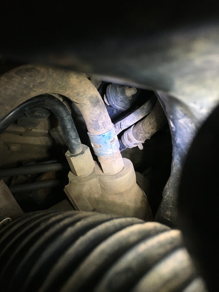

    alright well upon closer inspection I found a nice slice in the rubber hose that leads up to the breather
    this is most deffinetly a point of entry for water and moisture into the front ADD actuator.
    for anyone who is repair and or replacing theirs, do yourself a favor and inspect the rubber hoses leading to the breather!!!!!
    I say hoses because there are two different ones, one leads directly off the actuator that mates to a metal tube that runs across the bottom on the engine that then gets picked up by the second and longer hose of the two that leads directly up on the drivers side ending around the hight of the plastic engine cover with the littler breather fitting on the end!
    new actuator ordered, will replace the hose and install actuator next week.
    fingers crossed for the time being.
    tomwil likes this.

    Any idea how that hose got sliced?
    uurx[QUOTED] likes this.

    Yes! It seems like it made contact with a metal hose clamp. There are two breather tubes that run up together, one is larger than the other, the slice I have is in the smaller diameter hose, the larger of the two is the one with the metal clamp.
    will try and take some pics shortly
    tomwil[QUOTED] likes this.

    this picture really does Not do justice
    in person if you move the hose you can see a much bigger gap that cut right through
    as well this picture does not show the sharp edges of that blue clamp that I believe had been the culprit
