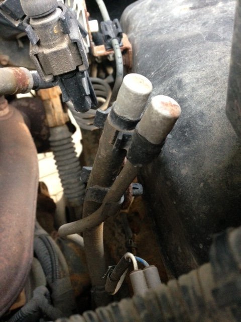

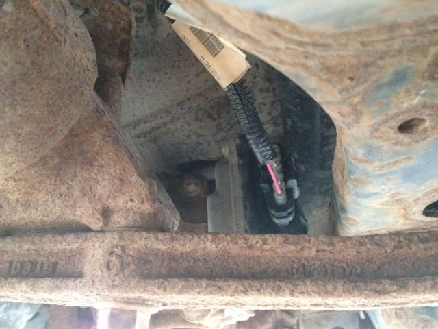

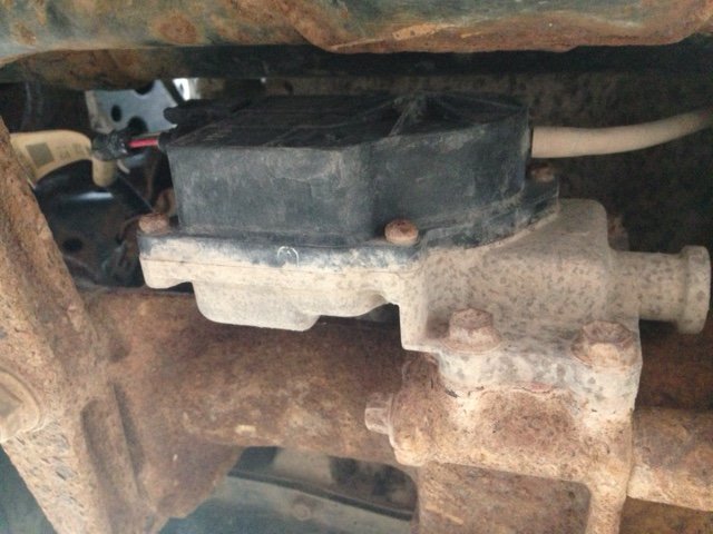

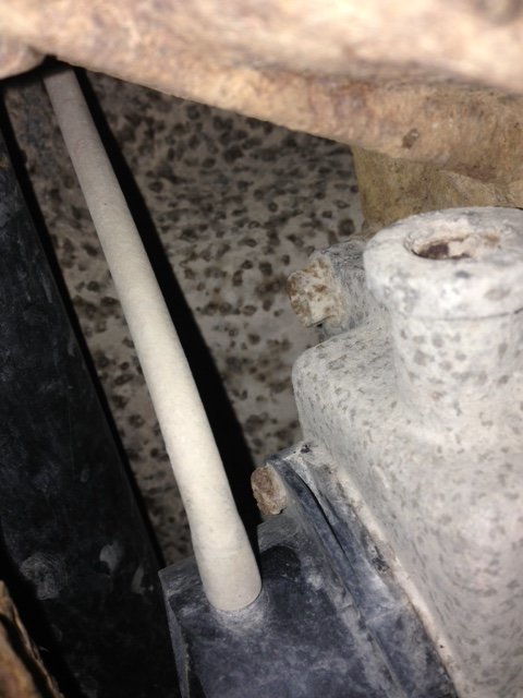

    Hello All
    I have a 2011 Toyota Tacoma TRD sport 4x4 crew.
    My 4 wheel drive light is blinking, won't go into 4Hi or Low
    The transfer case shaft is turning ok.
    It was working recently. 6 weeks ago and stopped working 4.5 weeks ago.
    I washed the engine one day with the pressure washer. reason why i'm adding this info is because I think I got water in the front diff actuator vent while spraying the engine. why else would it stop working, this is the only thing I have done before it stopped working.
    I'm thinking of just ordering a new one part# 41400-35033. and just replacing it. if there is water in there then it's good and corroded by now. The dealer wants $880. found one online at Rock Auto for $270 US. should I order from this crowd or are they iffy.
    thanks for the help.

  9. Oct 17, 2018 at 7:41 PM
    #389
    dborrer
    dborrer Well-Known Member
    Apr 28, 2018
    #251944
    549
    Mr. Dan
    St. Augustine, FL
    2006 Tacoma TRD Sport 4x MT
    2018 new Frame (thank you Rust!), FJ T-case swap. SPC(LR) UCAs, Bilstein 5100s front - rear, OME 883 at 0, HeadStrongOffRoad 3 leaf progressive AAL, MESO custom 2nd gen (Red/White) LED dome & Ultimate Maps, Spyder Halo Projector w LEDs (which SUCK), Spyder LED tails
    Rock auto is great for parts, I'll be curious to see what TW has to say about which brand is better:Aisin or Standard motor products.
    How do you know it's the front Dif Actuator vs the Transfercase Actuator (rear one)?
    Are you Manual Trans? Or Automatic?
    I have a similar problem, but not sure really which one is the culprit. Or both.
    Good luck, the front Dif Actuator looks difficult to remove ( the top 2 bolts anyway).... take video!
