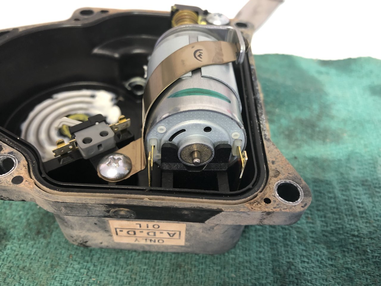

    I’m also dealing with the flashing 4WD light.
    Front shaft turns when 4 Hi is selected.
    Pulled my actuator today, the contacts were pristine and the motor worked in both directions. Soldered things while I was in there.
    Re-assemble, and no 4WD.
    Took it apart again to make sure everything worked. I can power the actuator off the battery, it works. Fork moves back and forth no problem.
    Re-assemble again, this time making absolutely sure that the actuator engages the collar.
    Still nothing.
    Ideas?
    Would the front shaft still turn if the T-case actuator has an issue?
    My actuator contacts after 35K miles
  16. Jan 22, 2019 at 2:04 PM
    #456
    93yotasr5
    93yotasr5 Well-Known Member
    Jan 5, 2018
    #240388
    494
    Sacramento
    Damn that thing looks super clean inside though!!!
    uurx likes this.
  17. Jan 22, 2019 at 2:06 PM
    #457
    uurx
    uurx Well-Known Member
    Mar 12, 2015
    #150723
    9,895
    long island, new york
    '12 t|x pro
    this picture was taken before the soldering I hope...!?
  18. Jan 22, 2019 at 2:10 PM
    #458
    GroupW
    GroupW Well-Known Member
    Oct 12, 2012
    #88863
    278
    Mark
    Arizona
    Red TX
    3 inch lift with Toytec Boss and All Pro UCA's up front. AP expedition leafs with Bilstien 5100 shocks in the back. 255/85/16 Cooper S/T Max tires. All Pro skids, rear bumper and sliders, Hidden winch mount with XRC 8000 winch. Dual Optima batteries with IBS combiner/isolator and solar. CMC. Auto sliding rear window mod, hidden CB, CVJ axles and plenty of other little mods.
    Yeah, it looked new - which actually worried me. I was hoping for an obvious problem there.
    Anyway, since I had it apart I soldered it up and tested it. Works fine.
    Been reading about the T case and front being out of sync. It just doesn’t seem that the front actuator is getting power.
