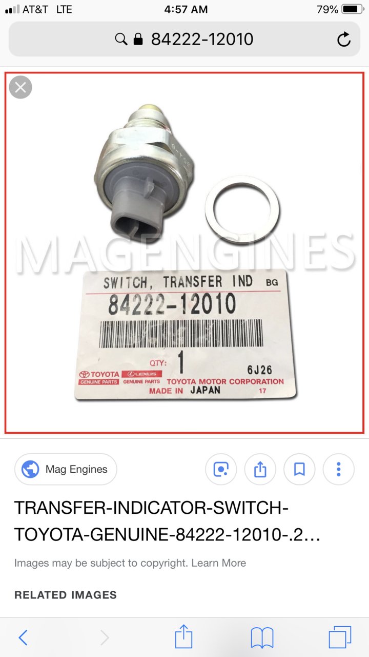

    Does anyone know the part number for the 4lo switch/sensor? I’ve googled it and I get conflicting part numbers with no correct picture of the part. This is the if that I am NOT looking for. I’m looking for the larger plug that goes on the transfer case closest to the driveshaft.

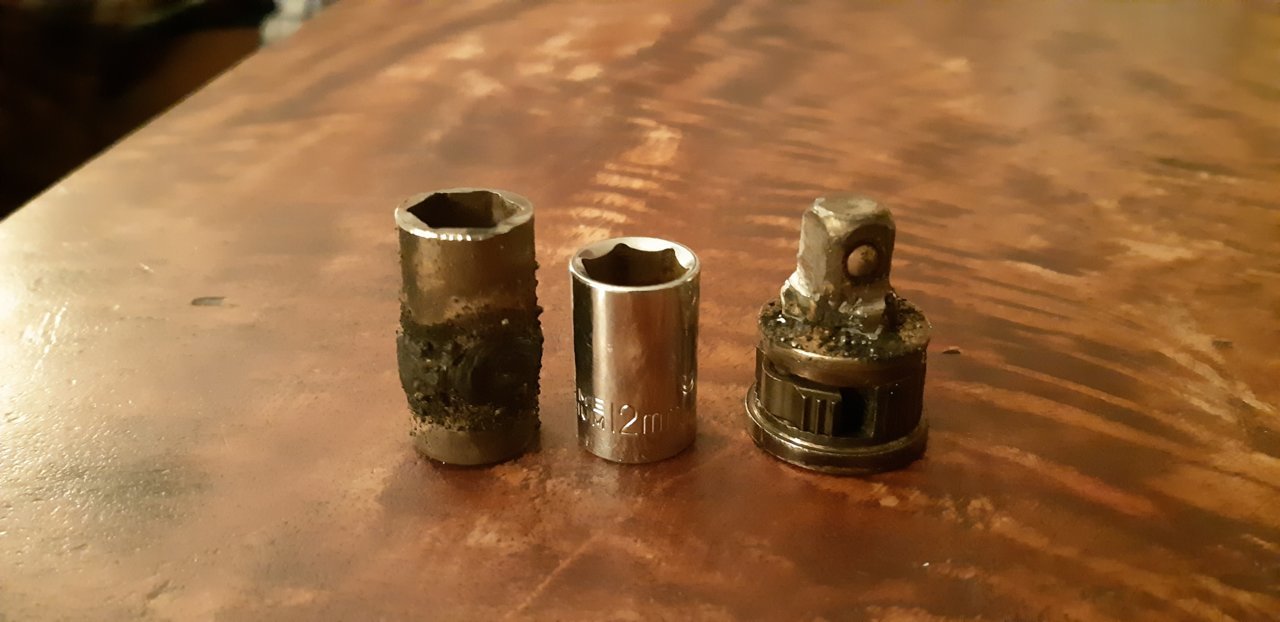

    Just adding my two cents. I also had a hell of a time getting the actuator off. I couldn't see getting to the to two bolts any of the other ways described in this thread, going in from below seemed to be my only option but a regular socket was too short to reach the bolts and a deep socket was too long as my steering rack is right there. Enter SST no.1! I figured all I needed was a socket in between the regular and the deep so I cut the drive off a spare extension I had laying around and welded it on to a spare 12mm. Then I realised that was still slightly too long so I had to cut some off (left ugly in the pic). Once the bolts were loose of course the ratchet wouldn't engage but I couldn't get my fingers on to the bolt or turn the socket so enter SST no.2 (right ugly in the pic) - I cut the gear head out of an old ratchet and welded on the other end of the extension I cut up earlier. Viola! Something to get a grip of :)
    Also found out, NAPA brake clean is awesome for getting rid of old RTV - not sure if that's been mentioned and pro tip - disconnect the electrical connector before going doing anything else because it's real hard to do once the actuator is hanging down dripping gear oil everywhere. Oh and drain your diff, it deserves a fresh fill.
