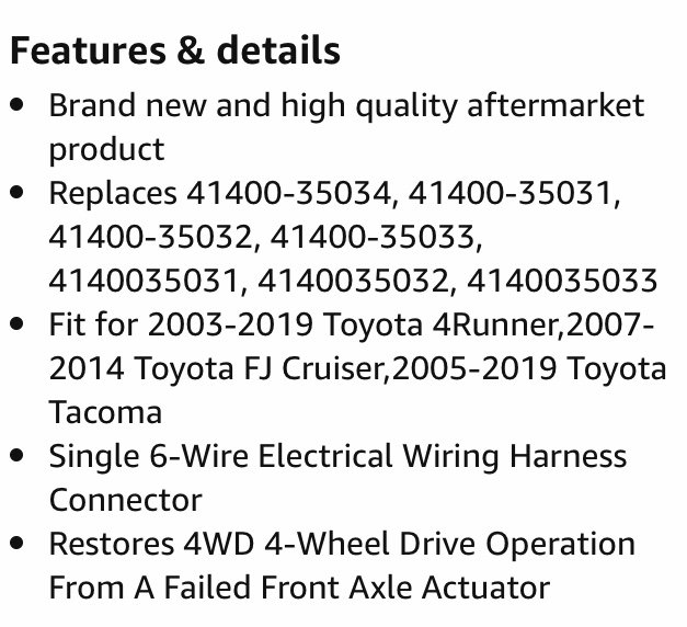

    I found this guy but when i check part fitment it says it doesnt fit fot 2016
    TOYOTA 4RUNNER FJ TACOMA GENUINE 4WD DIFFERENTIAL VACUUM ACTUATOR 41400-35034 or part number 35033. Is this the same model for 3rd gen ?
  6. Jul 19, 2019 at 6:36 PM
    #566
    uurx
    uurx Well-Known Member
    Mar 12, 2015
    #150723
    9,933
    long island, new york
    '12 t|x pro
    my guess is that its the same but I would do some more research on that one just to be sure
