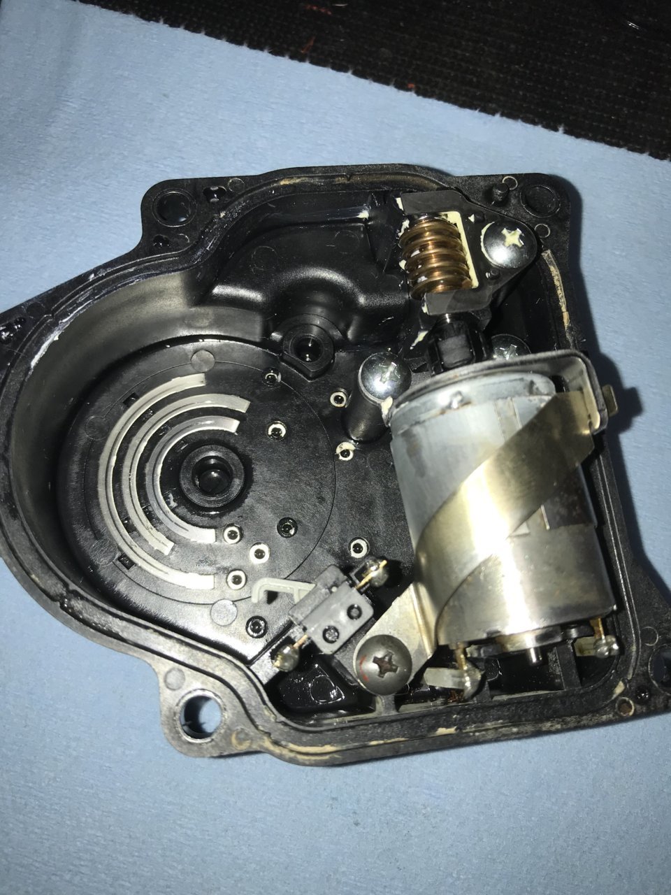

    It looks to me like maybe the solder joint on the far right is questionable. ???

    Idk might just be the angle but it was working perfectly fine before I put it in & then once it was in it was good for a week
    Purchased a new aftermarket one & still no luck

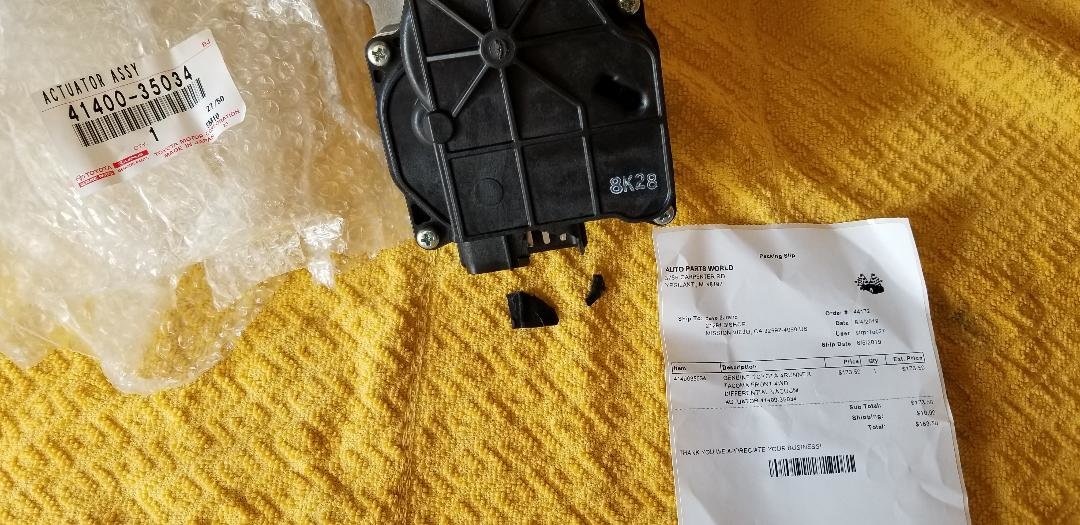

    Update! Dealer told me warranty is void due to the lift witch caused the hose to be pulled off Actuator. That is a lie because i checked the hose prior to dropping my truck off! I told them the lift did nothing to to the actuator or front diff to make it move to it pull off! Then he said i had modified the trucks electrical wiring and that voids warranty. I have not touched a single OEM wire on the truck except for a battery cable. So to make repair they would have to drop the front diff out of the truck and replace the actuator at a cost of $2300 i told them no thank you and would be calling corporate office. I then ordered a new actuator got 2 days ago and this is how it came to me!
    I think i can make it work. As the Auto parts guy i bought it from doesnt have anymore in stock and i need to get this fixed! :angrygirl::annoyed:

    Comato$e
    Comato$e Well-Known Member
    Aug 27, 2018
    #264222
    704
    Joshua
    Chicago,Il
    18' MGM OR DCSB
    That’s so weird ..... I’m lifted an have electrical upgrades . Depends on dealer I guess . So mine was done in 1 day under warranty , does the diff really need to come out to replace this ?
