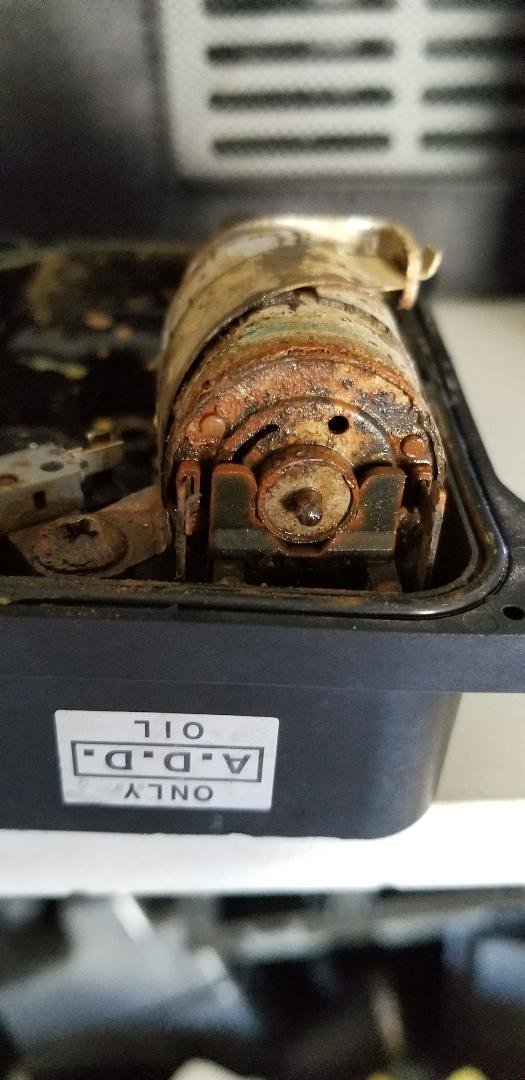

  3. Aug 13, 2019 at 7:42 PM
    #623
    TWTaco
    TWTaco Well-Known Member
    Dec 19, 2015
    #172601
    5,963
    Dave
    So this is what mine looks like inside ! Not good!:eek::eek::eek::eek::eek:
    Replaced with a entire new unit and it works great now.:bananadance:
    Carl_z33 likes this.
  4. Aug 13, 2019 at 7:43 PM
    #624
    TWTaco
    Dec 19, 2015
    #172601
    5,963
    Dave
    Can the motor be replaced? Or is this just trash?
  5. Aug 29, 2019 at 3:38 PM
    #625
    Carl_z33
    Carl_z33 Well-Known Member
    Jul 28, 2016
    #193141
    443
    Carl
    2014 Toyota Tacoma TRD OR 4x4 DCSB
    Clean it up or buy a new oem one

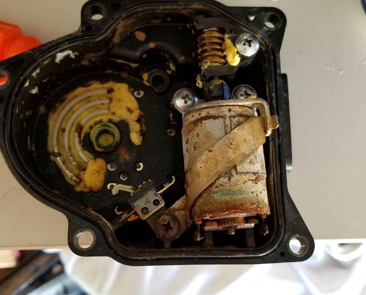

  10. Nov 17, 2019 at 3:44 PM
    #630
    TxFireman
    TxFireman Factory Pilot
    Sep 7, 2013
    #112051
    1,158
    San Antonio, Texas
    2013 DC-SB TRD-OR, tow package, entune/nav
    I got the dreaded blinking when I tried to shift into 4hi the other day. Symptoms were, would not engage in 4 hi or 4 lo, light blinking and once I put the selector back into 2 hi it would continue to blink until the ignition was shut off. No noises of any kind, just no 4wd engagement. My truck is a TRD OR 2013 w/ 50K miles. I have the extended warranty, so I took it in to the dealership. Spent some hours looking at 4runners and tacomas while they diagnosed it. They said it was covered, and I brought it in once the part arrived and they made the swap. I have a buddy who is a tech there, and asked if I could keep the old one, and he said as long as it's an extended warranty repair, they should be able to give me the part (which they did) but that under the factory warranty, they have to keep them and maybe even return them to toyota. So, when I get a chance I will take the old one apart and see about soldering the connections etc to keep is as a spare/back up. With the trips my wife and I take, alone, pulling our scout trailer into forest roads and trails, 1000 plus miles from home with almost always no cell service, it's not too comforting knowing it just might not work again some day. I know anything can fail, but when it has a history of going out like this does, with no warning, that isn't cool. Hopefully, the back up will work and be an option if needed.
