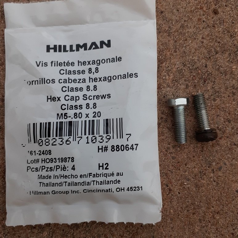

    This thread helped me recently with my 4x4 blinky-light issue; when checking my ADD i had to drill out 3 screws; ended up replacing them all with bolts - here's what i used:
    I got these at Lowe's - bolt pictured beside upside-down factory screw.
    Here's my thread - https://www.tacomaworld.com/threads/flashing-4x4-and-4lo-diagnosis-help-2008-sr5.727677/
    tl;dr: Ended up cleaning out the TCase actuator and sanding away some grime and things started working.

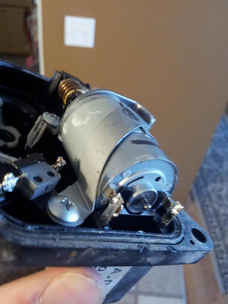

    I’ve been dealing with my 4wd not engaging.I could hear the transfer case actuator running when I turned the switch, but didn’t hear anything in the front diff actuator. After taking apart the actuators and beefing up the connections and testing the motors, the 4wd light was still blinking. Finally gave up and brought it to the stealership to have them diagnose it. They said the transfer detection switches were bad.

    Both of my actuators were clean with no corrosion. I beef’d up the motor terminals and the terminals for the detection switch inside there. After taking the actuators out multiple times with no luck I brought it to the dealership. They’re saying it’s the 4wd-H and 4wd-L detection sensors. I hope that’s it. I wanna change them out myself but don’t want to find out that wasn’t the problem and need to bring it back. If I have them do it, I’m thinking the parts and labor will be under warranty.
