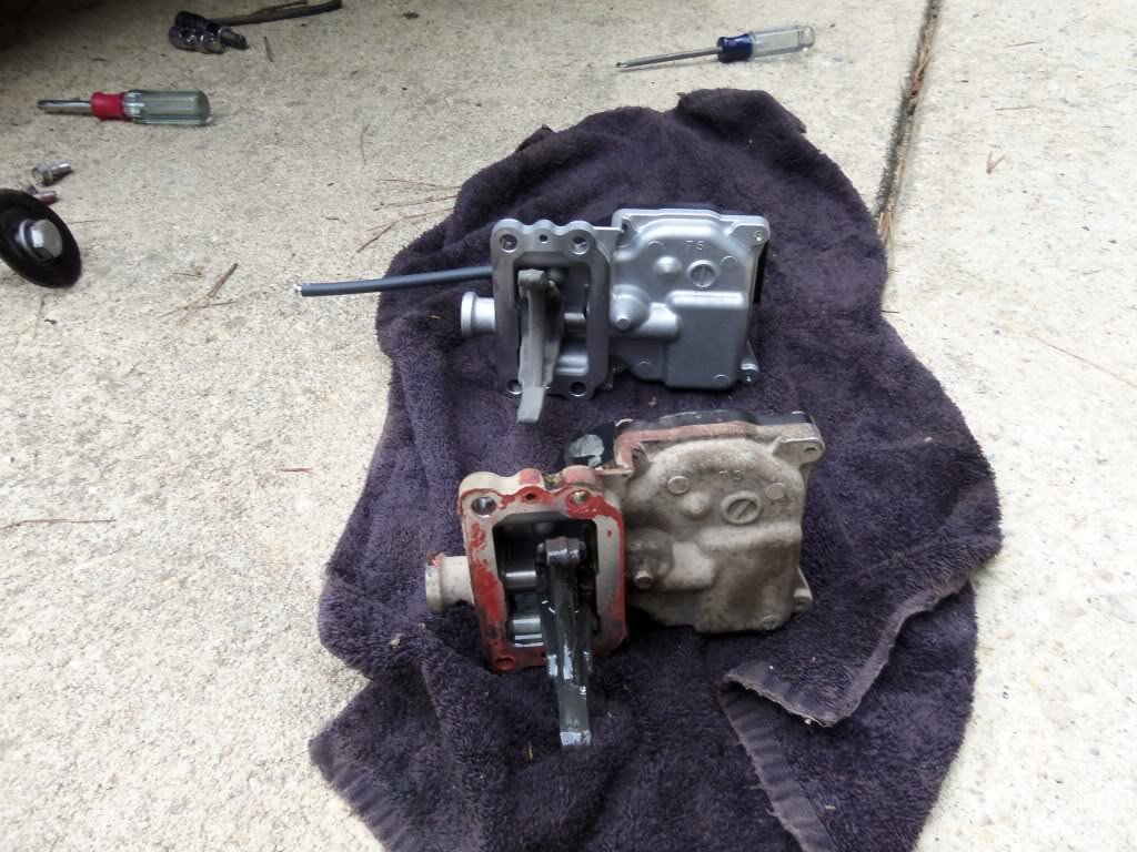

    My actuator came in yesterday. I ordered it from a dealer in Massachusetts. I got it for $280 with second day air. Local dealer wanted $435. I was moving the vehicles around this morning to set up to do the work, and I threw it in four hi and WAMO, it worked! IDK what the hell is going on. Four hi and low are working. I'm going to wait for the time being on swapping out the part. I'll keep you posted.

    UPDATE: Since it's sunny and 70 degrees, I installed the actuator today. All went well and for the first time I got to put the truck in 4 lo with the locking rear working. I'm glad that I got a chance to put it on before the weather changes and its freezing cold out.

    Did the ADD last night and........we're back!!!!!!
    You don't know how bad I wanted to rip open the new ADD pn 35033 to see what they changed/ why the part was rev'd at least 2x since the original!! But I decided against it ;-p .
    Thanks for all the help TacomaWorld!!!!
