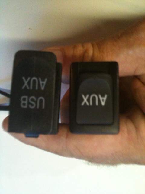

    First, I have to say thanks to all those who developed and demonstrated the means to adapt the 86190-0C020 using altered cords and dremel-cut ports. I tried it, got frustrated, got it to work, tried to make it better, then looked for an easier way. In Japan, I found a device already made; and we installed one in our 83 Land Cruiser and planned another for our 07 Tacoma. Works perfectly, and was a neat installation even in an old truck.
    If you're about to undertake this adventure, consider the easy way. The cost works out to be about the same but with many fewer headaches. I'll get a couple more next time I'm in Japan.

    mr.plus usb/aux
    helps if you can read / speak Japanese
    Amazon . jp $39.36 us
    http://tinyurl.com/q8usutl
    or $30.92 rakuten
    http://global.rakuten.com/en/store/creer/item/street_nv-3/
    also check here
    http://www.street-automotive.com/mr_plus_nv/
    more info on minkara (Jp only)
    http://minkara.carview.co.jp/userid/184192/car/73871/4802426/parts.aspx
    Don't forget you have to pay shipping and customs to get one here

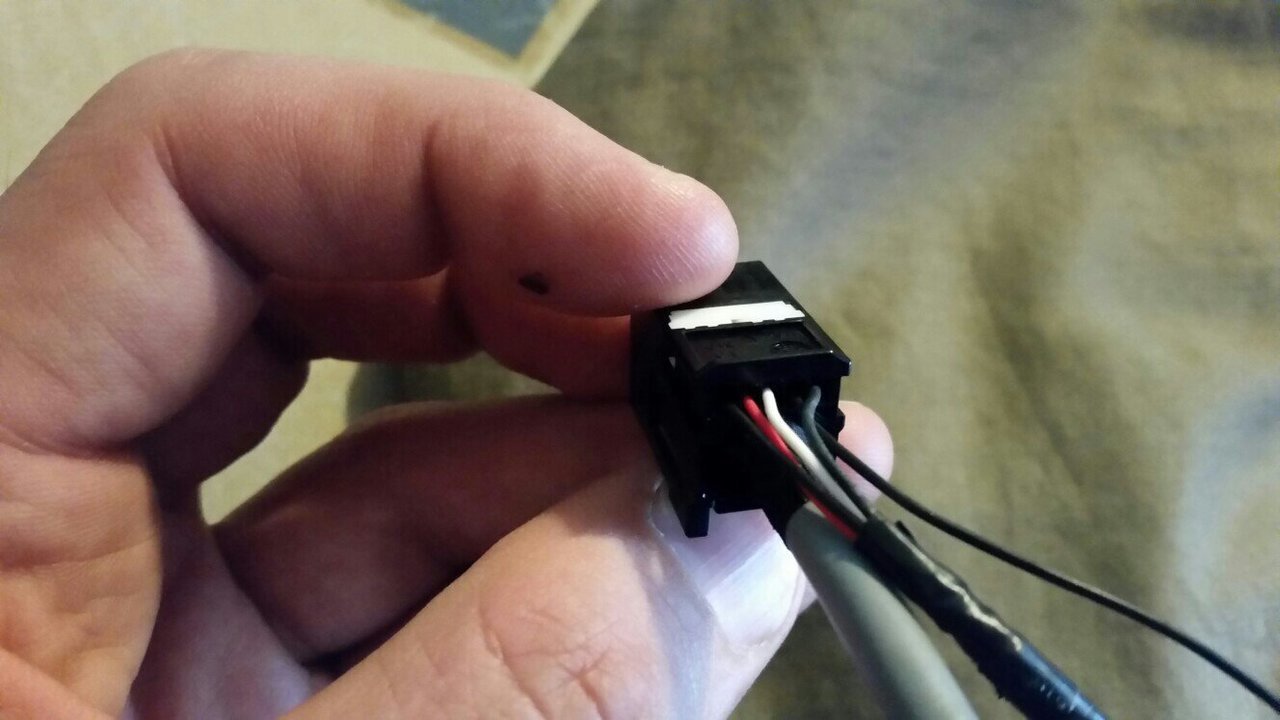

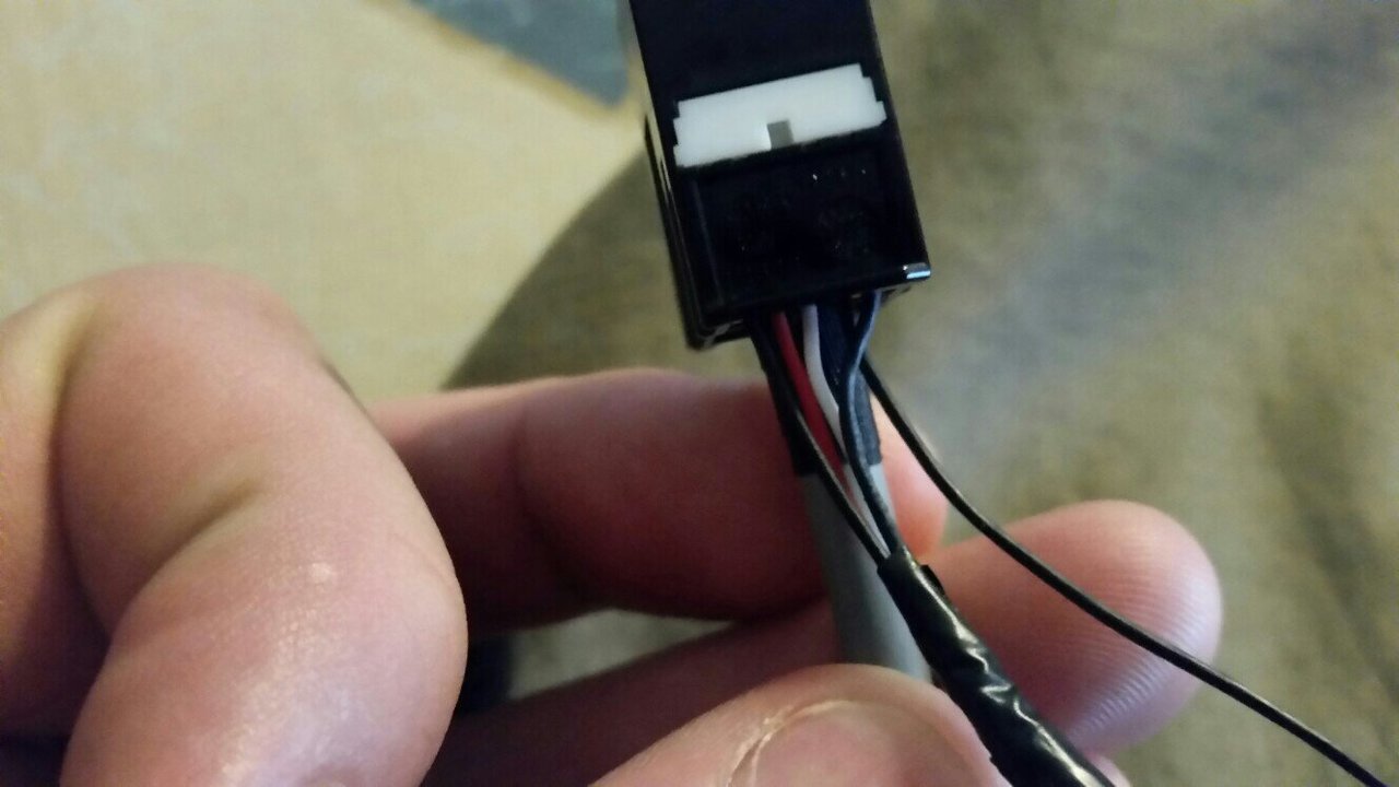

    Here is a couple pics. Hope it helps someone.
    qy3yseby_1a17f4554fae68a6690c8d0ce5496aeb94c23a4e.jpg7a9ahu3e_8da2c793b4fd3cdaa0aaaa2e3e0b65c4e013f585.jpg
  12. Apr 21, 2014 at 2:23 PM
    #72
    skygear
    skygear                    
    Nov 6, 2011
    #66558
    8,414
    From left to right.
    Black, red, white, black (remote?), black shielded/ heat shrunk ground,

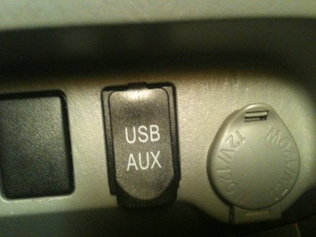

    I just installed an aftermarket head unit in my 2011, and I thought I would post up a less expensive alternative I found on eBay. Here's a link:
    http://www.ebay.com/itm/171259515443?ssPageName=STRK:MEWNX:IT&_trksid=p3984.m1497.l2649
    In case the link changes, the seller's name is "California Supplier", and the listing is titled "Flush Mount USB Aux 3.5mm Headphone Jack Mounting Panel Dashboar Dock Input Lead". I paid $18.94 with free shipping.
    Here are a few photos:
    As you can see, it is almost a perfect fit. I say almost, because the factory unit has clips that hold it in place in the dash, and this unit does not. I'm not sure what the best solution to this is, but I used some thin double-sided tape (placed where the clips are on the factory unit), which seems to hold it in place just fine.
    The unit has a male USB end and a male 3.5mm end, and the wires are just about 30" long. Other than needing a female-to-female 3.5mm connector, this connected directly to my aftermarket head unit and works just as you would expect.
