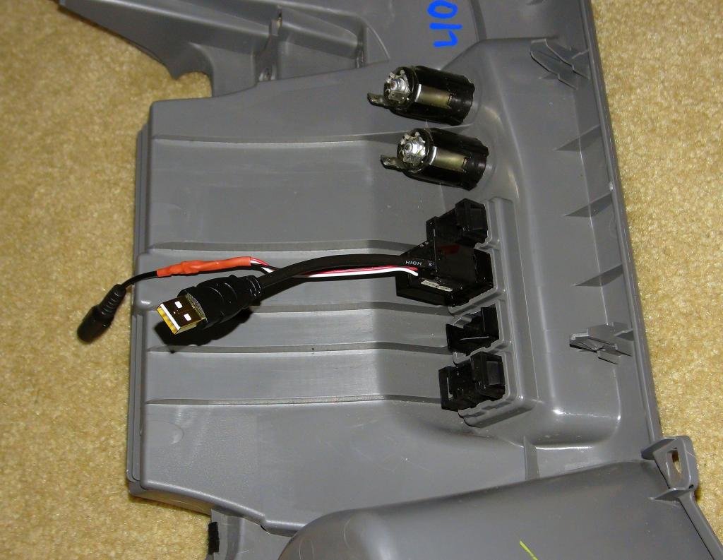

    Well...this didn't go exactly as planned. I got the USB/AUX plug modified and thought I did a good job on the USB cable, but It is not working. I haven't bent the pins up on the USB yet. What did y'all use to bend them?
    Does anyone have any tips or pointers for making the modified USB cable work? Is there a specific method that you used to remove the metal surround? Is there any other alternative other than removing the metal surround on the USB cable (such as a different type of cable)?
    Thanks!

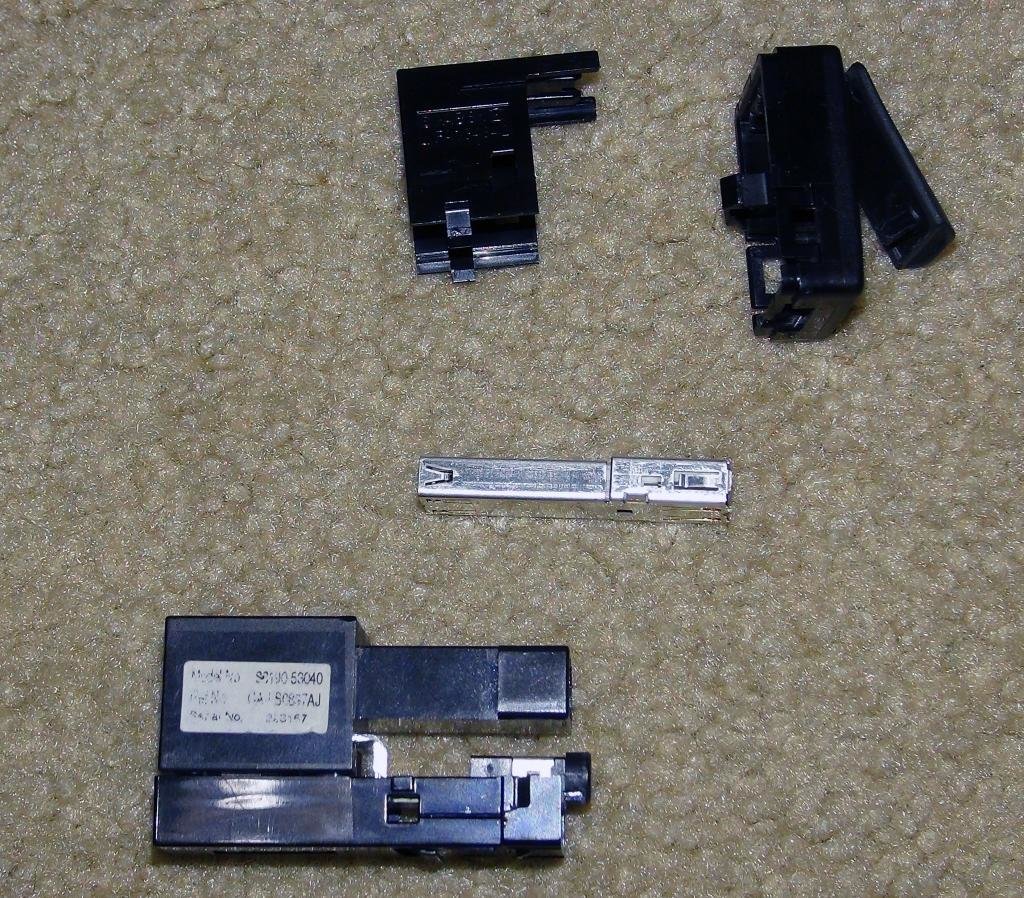

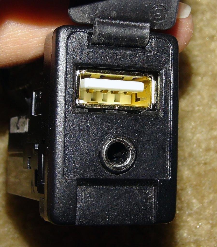

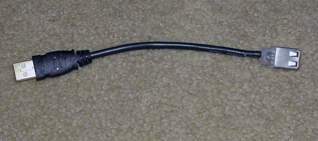

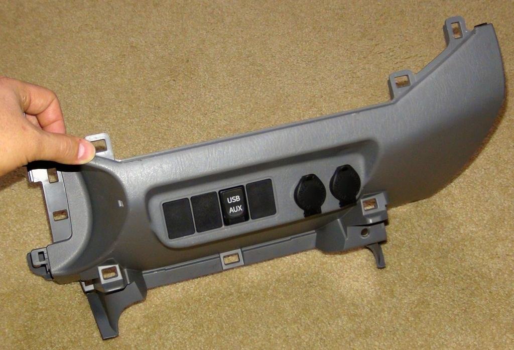

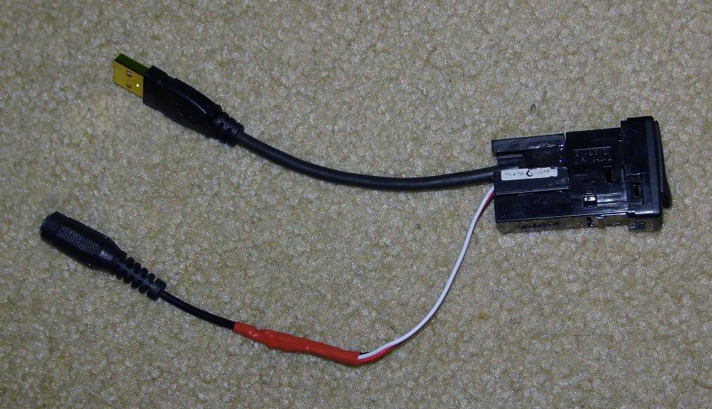

    Here is my own take on this mod. I went a little further with the USB part and completely gutted the original USB pass-through. I did this so that shielding is not compromised. It also ensures a good connection. No worries about bending pins here! Also, I suggest looking for this part on ebay under names such as "Venza USB AUX" for example. All of these are the same part in the newer Toyotas and will fit in all Toyota vehicles. Anyone paying $65 for this part is getting burned. I picked this one up for $20.

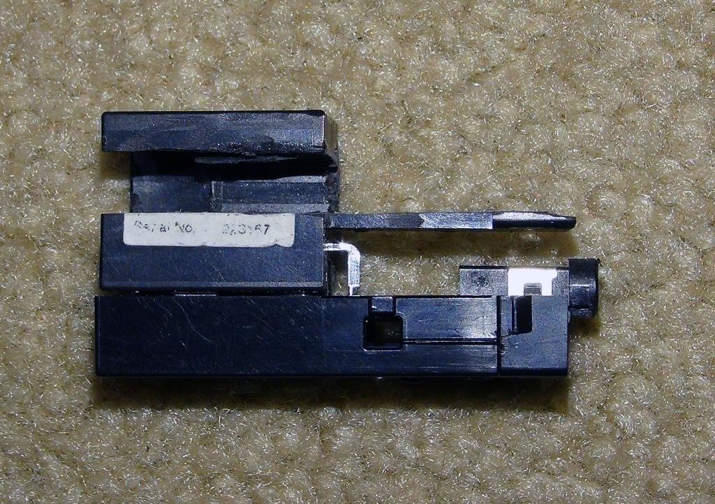

    It all starts with disassembling the part and removing the USB pass-through.
    Next, obtain a short USB cable with at least one female end. I used one with male and female ends. You need at least one female end so that you can remove the plastic covering and put that end at the front of the part.

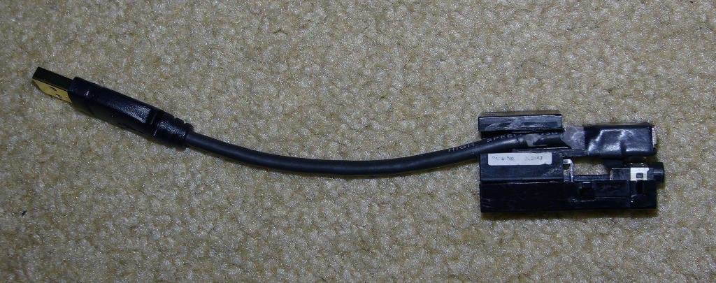

    Use a Dremel or similar cutting tool to cut out the part for fitment of the USB cable.

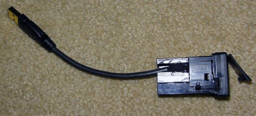

    Drop in the USB cable and secure the front end with electrical tape. This will hold it in place while JB Weld cures.
    Use quick setting JB Weld to lock the USB cable in place. Apply it all the way up to the electrical tape, and leave the electrical tape in place permanently. The USB cable won't be going anywhere after this.
    Put it all back together.
    This is your new interface, completely shielded for the entire run of the cable and much more structurally sound than the previous methods.
    Finish off by hooking up the servo-to-3.mm wire discussed earlier in this thread. I recommend using short 3ft long USB and 3.mm wires to run from the back of this part to behind the radio, then hook the radio up to those. Some radios come with the USB and/or 3.5mm wires already connected. You don't want to drop those wires down and connect to this part directly because unhooking the radio will be a pain in the future.
    Ready for installation in my 07 DC.

    Agreed, and as one who has done your process, it was simple and effective. It does not however offer a 4 conductor aux cable solution. That's the only reason I'm thinking of switching. My Pioneer requires that in order to interface with the app mode on an iPad/iPhone.
    They are for left/right audio, video and common ground. The three conductor route only passes audio.

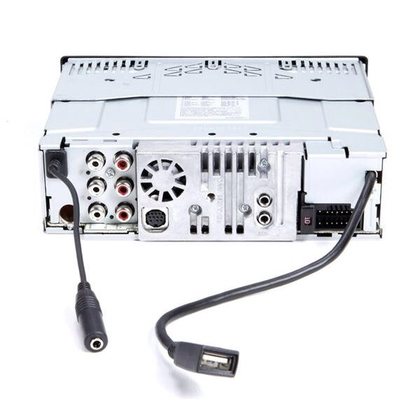

    This is a great write-up. But I keep thinking there has to be a better way to make it factory look and finish.
    I'm installing a Pioneer 8000NEX that has two USB inputs. I want a factory look using factory USB ports in the factory knock-out ports in the dash.
    The first USB will be easy to connect using the factory USB port. I ordered two cables from Crutchfield. One of these cables will plug into the end that was plugged into the factory stereo. In other words, I'll remove the factory stereo, unplug the USB harness from the back of the factory stereo, plug this adapter into the USB harness, and finally plug into the Pioneer. I ordered both cables because I'm not sure which one is the correct adapter.
    http://www.crutchfield.com/p_120TOYUSB/Metra-AX-TOYUSB-USB-Port-Cable.html
    http://www.crutchfield.com/p_120TOYUSB2/Metra-AX-TOYUSB-2-USB-Port-Cable.html
    Adding the second factory looking USB port is proving more difficult. I've read through this write-up but I don't really like all the modifications required. Worries me about loose connections over time. I've seen this unit on ebay: http://www.ebay.com/itm/FLUSH-MOUNT-AUX-USB-3-5MM-HEADPHONE-JACK-MOUNTING-PANEL-DASHBOAR-DOCK-INPUT-LEAD-/281313872095?pt=LH_DefaultDomain_0&hash=item417f9d08df but it doesn't look like it will be a factory fit in a factory knock-out port. Has anyone tried this and can say it fits and looks factory?
    Here's what I'm trying to do. So far I have ordered the factory port: http://www.ebay.com/itm/New-OEM-Toyota-AUX-USB-Adapter-86190-0C020-Avalaon-tacoma-tundra-Sienna-ETC-/161634584904?hash=item25a22c0948&vxp=mtr
    Next I'm trying to find the factory cable that plugs into the back of this factory USB port. This has been a very elusive search. Once I find this cable, I can plug it into my new factory port and then use the same cable I mention above from Crutchfield. Has anyone found this cable that plugs into the back of the factory port?
    Near as I can tell in all my internet searching, the cable I need is 86203H as shown in this link: http://www.villagetoyotaparts.com/showAssembly.aspx?ukey_assembly=1102054&ukey_product=8454192. The problem is there is no picture so I can't tell for sure. I may just order it to see.
    For my arrangement, I'm only interested in getting the USB ports working. I have no need for the aux. port so I'm not doing anything to keep the aux. port working.
