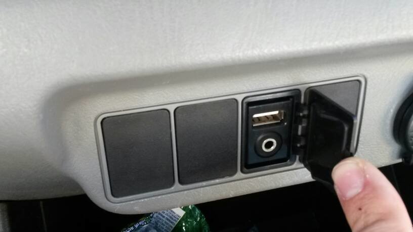

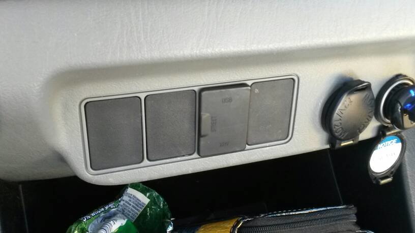

    Well as promised but a little late on timing. Here is the aftermarket kit. Again my reasoning for installing it is for the 4 conductor aux jack. The stock cover flap looks better, but this isn't a bad option. Hope the images work.

    Looks good. :thumbsup:
