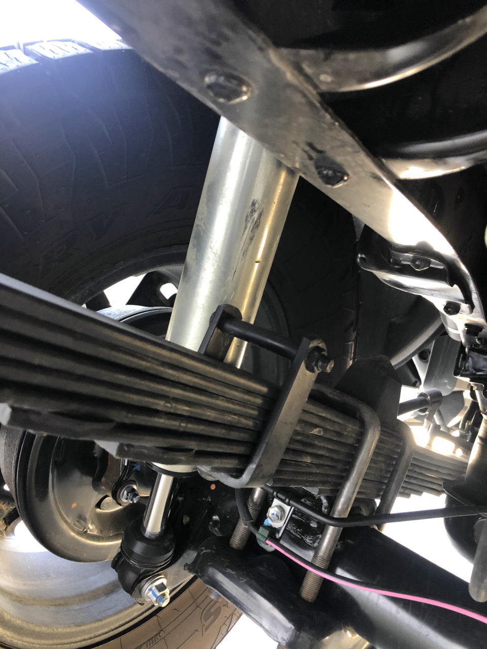

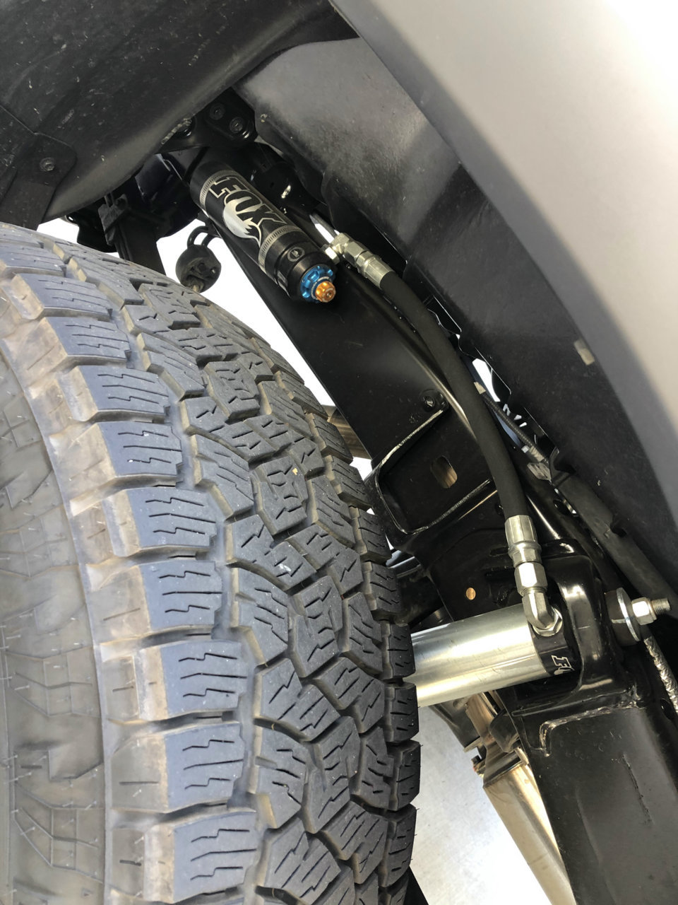

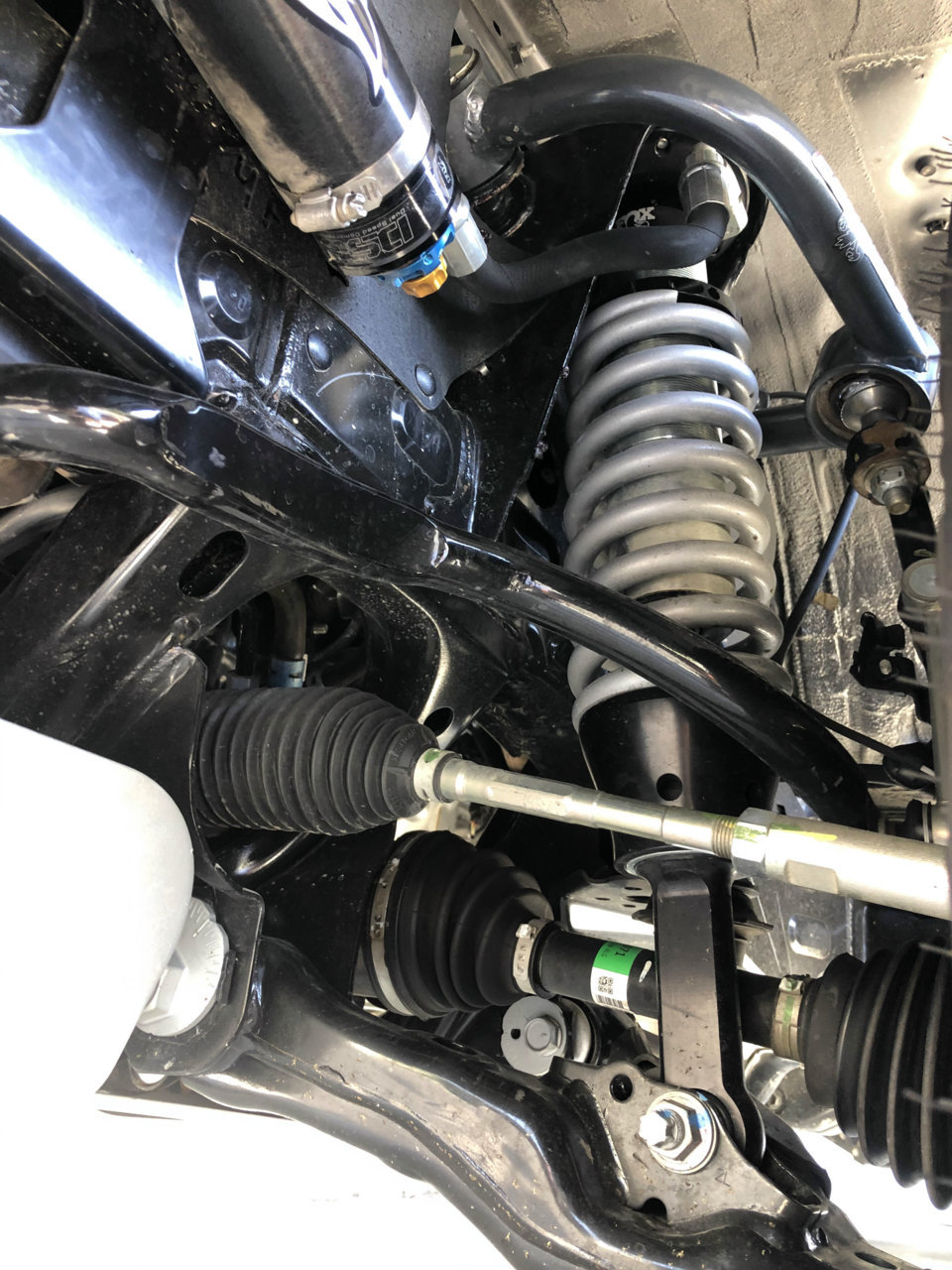

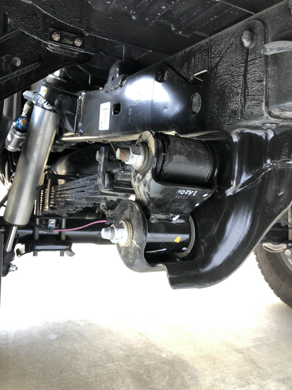

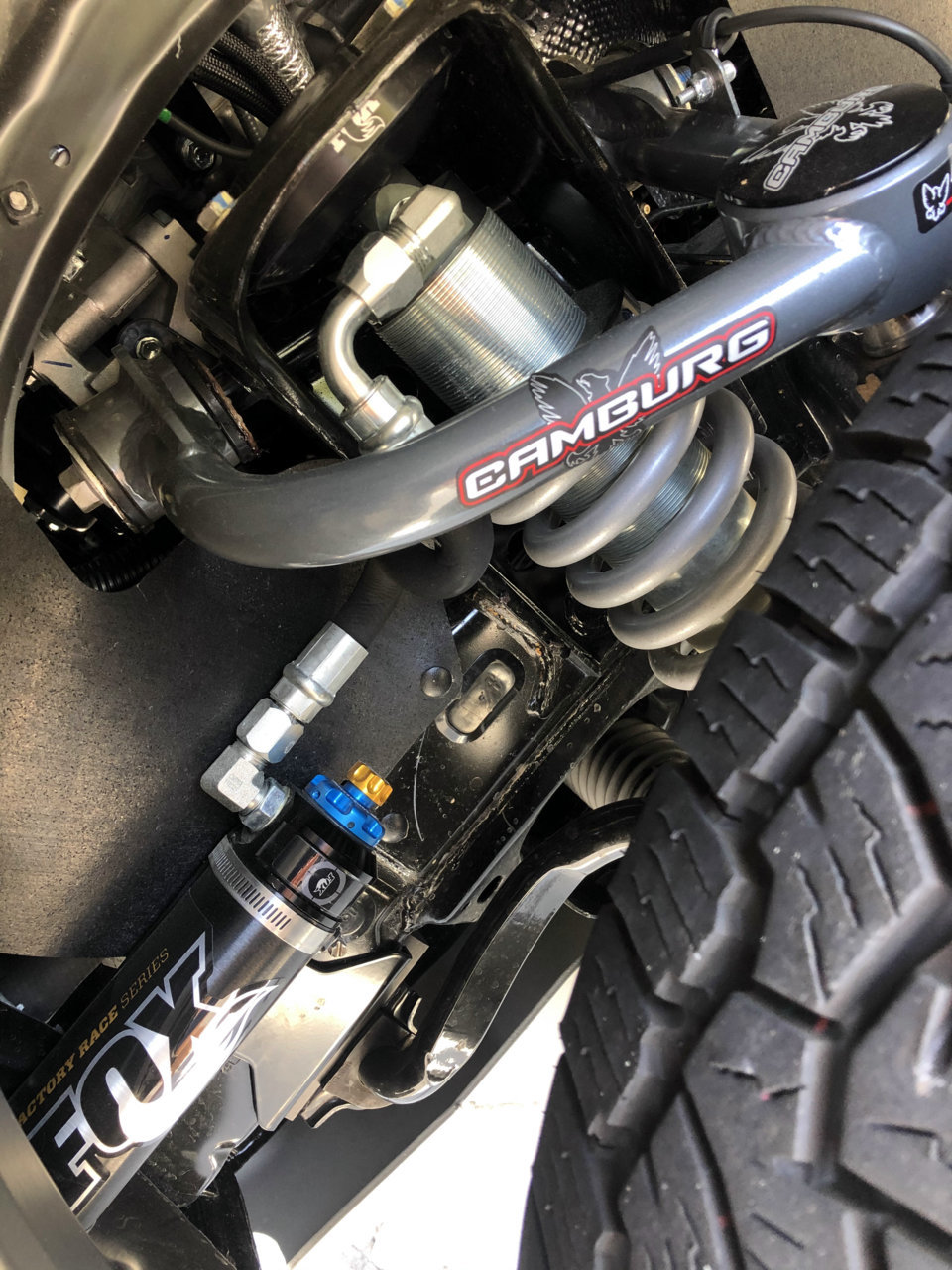

    Hey guys:
    Simply put I want more travel without cutting through the bed? lol
    Wondering on what particular components I have to add [or subtract] to upgrade my current mid travel kit to either a stage 5 mid travel or as much travel I can get without going long travel lol
    (After doing some research its basically a stage 4 mid travel kit??).
    Front end:
    Fox 2.5 Factory series coil overs with DSC
    1.25 uniball Camburg UCAs
    Stock Lower control arms
    Rear:
    Fox 2.5 Factory Series Rear Reservoirs with DSC
    J66 series Deaver progressive leaf springs (10-pack)
    Stock/Factor shackle hangers
    Stock/Factory bump stop
    What would I have to do add or replace?
    After market Lower control arms - 2.0-3.0 bypasses in the front?
    Archive garage hammer hangers?
    Rear Shock relocation kit?
    Thanks for the feedback!!!

    In the front you are kind of limited unless you go Long travel. +2 inches over stock seems to be the sweet spot for mid travel upfront. Not much more you can do honestly. The rear however you could get up to as much as you need but you'll be sacrificing bump travel and ground clearance with anything really over 12 inches. @ARCHIVE can help you. He's the local expert lol.

    If you do all Archive stuff, daily driving comfort and handling gets better, while increasing travel. There's no negative charachteristics
    You can get 12-14" travel out back without going through the bed or losing bump travel with the Archive 2.5" shock Relocation kit.
    Hammer hangers are a key component in ride quality, handling, increasing chassis composure so you can go faster. The stock hangers are atrocious, and flex so much they inhibit chassis composure so it becomes uncontrollable.
    Then you want our Stealth HD Ubolt flip option 3, our Archive bumpstop has soft engagement, and slows weight down over a greater distance.
    For speed with SOA, you need more rear lift than the J66 provide. Unfortunately, there isn't a light duty leaf that has 2.5-3" lift, so maybe have Deaver add arch to J66 and throw in an extra leaf

    In the 4th pic, is that shackle rubbing on your shock body?
