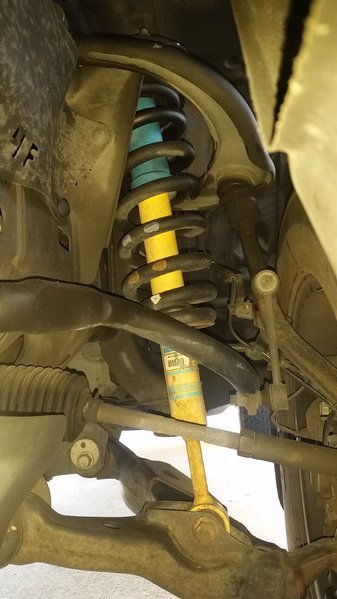

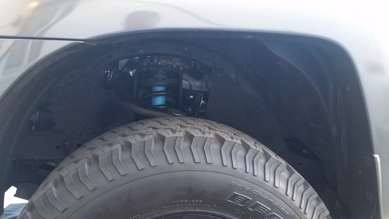

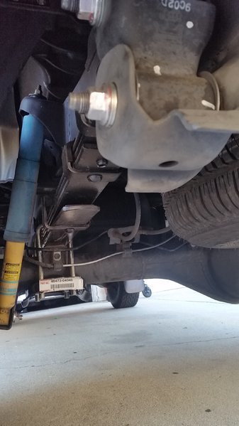

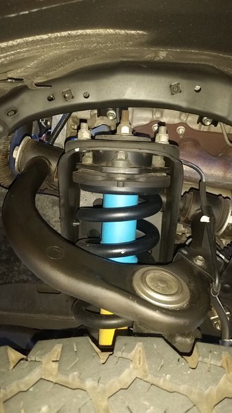

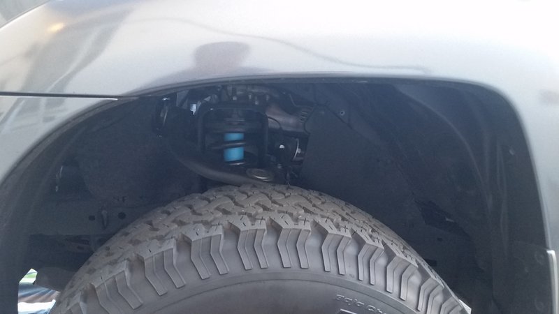

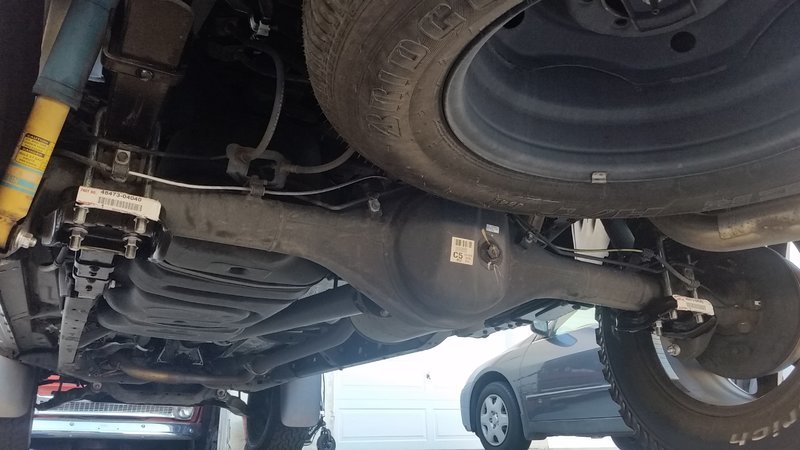

    Been told I have a lift on the front of my 09 dclb trd sport. How can I tell what parts actually lifted it? I also included a picture of the rear end. Looks like a new set of leafs and brackets and u bolts was put in. Any reason in particular could you guys think of? Everything looks stock to me as far I can see but I'm new to tacomas and wouldn't know a stock part from a aftermarket unless it was marked

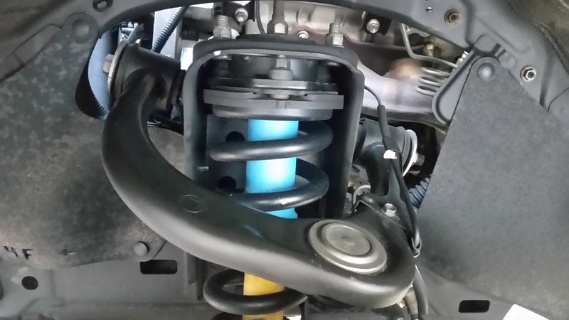

    Looks like a spacer in the front. As for the rear looks like a add a leaf

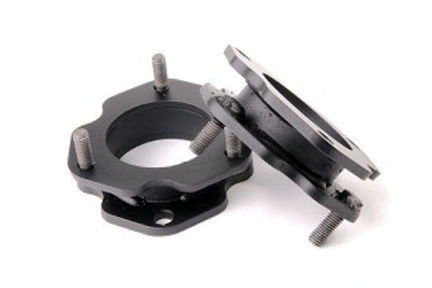

    Spacer lift. Also called leveling spacers. If you look closely, they are the parts that are bolted to the top of your front struts (image added below for reference). The rear looks like new leafs and u-bolt/plates. Probably from TSB because of the barcode stickers on the u-bolt plates. Toyota techs are lazy.

    Looks like you got a 1 1/2 to 2 inch strut spacer on the front and the rear is the new recalled leaf springs.
