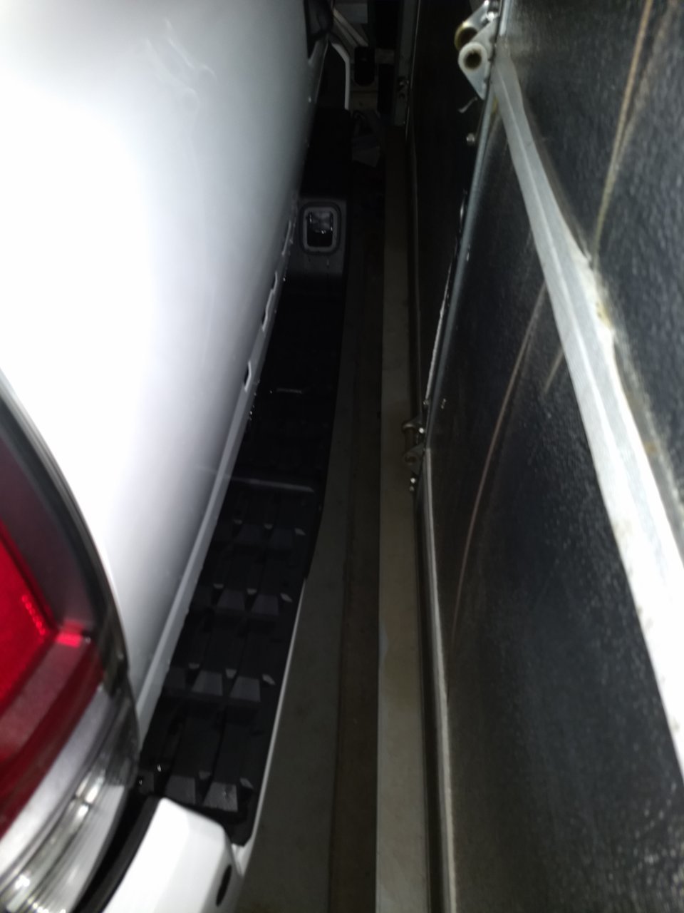

    My tacoma just barely fits in the garage. I want it back as far as possible so we can get around the front of it. That means the garage door is extemely close to scratching the bumper every time I close the door.
    I have a laser to put a dot on the dash when I'm in the right spot, but I wanted something a little more difinitive.
    The sensors that keep the door from coming down on a small child could be moved up and out, but then they wouldn't protect a kid...
    From what I've read, those sensors are transmitting and receiving an oscillating signal, so we can't just add another pair of standard garage door sensors. People report attempting to add sensors in serial and parallel without success.
    But - there are photobeam sensors that operate on 12 volts DC and provide a normally open or normally closed relay. That makes it easy - just set the relay to normally closed cut one of the wires for the existing sensors and run it through the relay.
    Any time the new sensor's beam is broken, it turns off the OEM sensor.
    I screwed a scrap of aluminium to the track to hold the sensors:
    Now it will let the door come down this close, but if the truck is back another inch, it won't let the door come down.
    Supplies required for isntalling the sensors:
    - One set of sensors
    - 50 feet or so of thermostat wire
    - a 12volt DC power transformer (it can be very small, total draw is 45 ma for both)
    - a few staples for the wire
    - whatever you're using as a bracket to mount the sensors (or put them on the wall)
    Now I have the laser to tell me if I'm about where I want to be, and if I'm not paying attention, the door still can't come down on the taco.

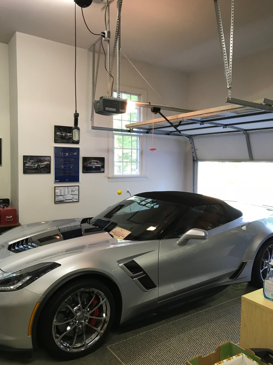

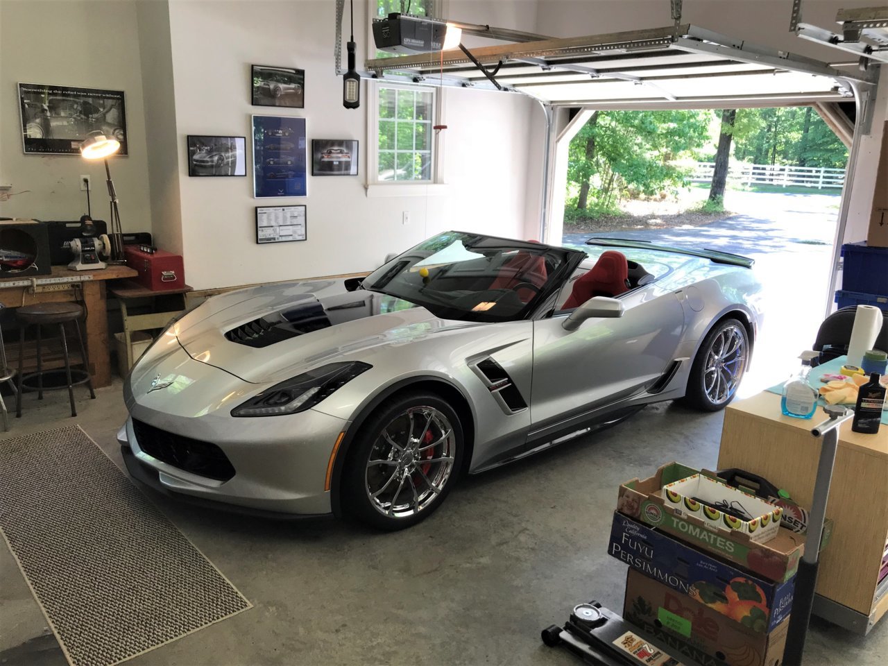

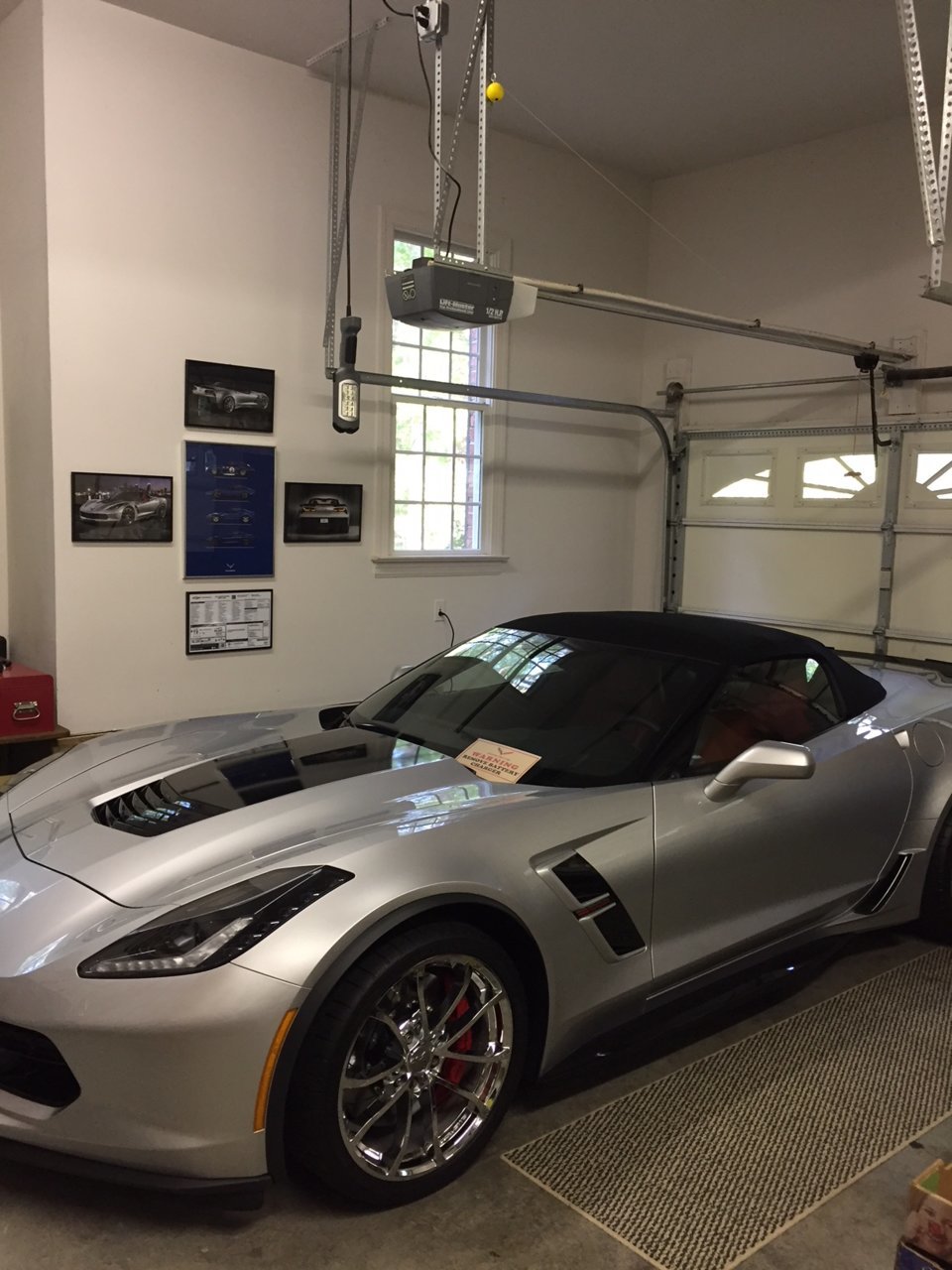

    I agree, there's a lot to be said for the simplicity of a hanging tennis ball.
    Got mine rigged to garage door so that ball is down when garage door is up and retracts up and out of the way after car is safely parked in garage.
