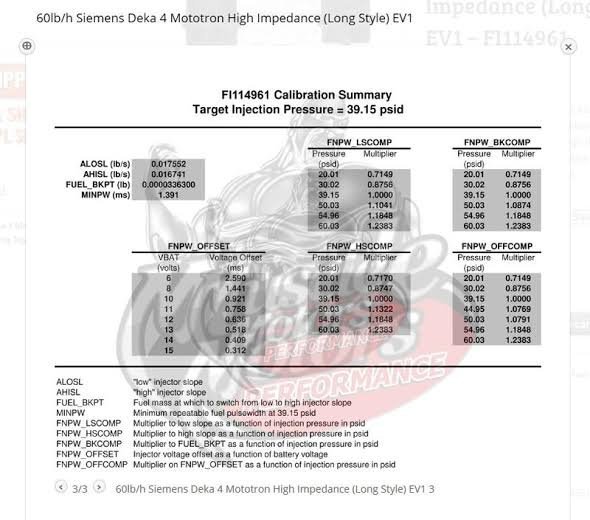

    800cc Siemens/Deka Injectors URD Fuel Pump Upgrade Haltech Elite 2500 Custom Power Fab Precision Turbo 6676 @8 PSI 3" Custom Exhaust from turbo out
    VERY IMPORTANT!
    These parameters are for a 39.15 psi. Our trucks are 43 stock so you would need to do a little math using the FNPW_OFFCOMP to get the correct parameters for the given fuel pressure.
