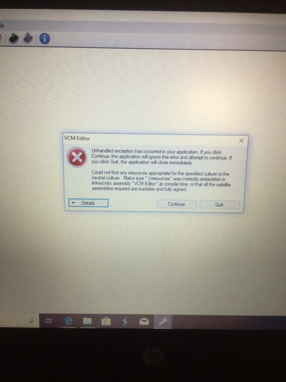

    Magnuson supercharger, 2.6 quick change pulley, 76mm throttle body, Doug thorley long tubes, urd y pipe, wot box with 2 step, 170 thermostat, airaid intake, urd short throw, djm 3/4
    Anyone know what this is and what I do? I’m not good with computers. Just cars lol
    Norton and loginfailed like this.

    800cc Siemens/Deka Injectors URD Fuel Pump Upgrade Haltech Elite 2500 Custom Power Fab Precision Turbo 6676 @8 PSI 3" Custom Exhaust from turbo out
    Ask them if you flash to the TRD I gave you, if that one IS supported?

    Ogden, UT
    CLT is Coolant Temp
    BassAckwards[QUOTED] likes this.

    Ogden, UT
    Beta or Full
    Tell us how you got to that point

    2014 DCSB 4WD
    Uninstall VCM Suite
    Install VCM Suite - Full Version (not beta)
    Run VCM Editor
    Install VCM Suite - Beta Version
    Go play
    I’ll fix you up via TeamViewer if you want.
    Once I open “vcm editor (beta)” it pops up.

    Brian Crower stroker kit, Carrillo pistons moly/ceramic coated, BC sportsman rods, arp s2000 head bolts, Darton M.I.D sleeves, Kelford race cams, Magnusson supercharger, hp tuner tuned, 650cc flow matched fuel injectors, CSF radiator, Walbro 255 fuel pump. pulleyboys quick change pulley with 2.3", fpr mod, NST crank, water and alternator pullies, 160° mishimoto thermostat. Puma On-board air, Radflo CDC ext coilovers with 14" 700# springs, extended length rear Radflo shocks with CDC, Dakar leak pack, Brute Force Fab front bumper galvanized and powder coated, DTRL mod, yellow fogs, fog anytime mod, relocated rear differential breather, synthetic fluids, custom airbox, tundra sized intake. 76mm throttle body, secondary air filter removed, Airflow snorkel, 4x innovation sliders powder coated, URD equal length headers, DT y-pipe, Aero-Turbine 2525xl exhaust dumped over axle, seat belt chime disabled, Warn 8000i winch, 1- 20" slim light bar in grill, 42" curved roof light both with custom brackets. Mesh grill, Brute Force Fab rear bumper with extra reverse lights, u bolt flip kit, SS extended brake lines, hockey puck bump stop extension, AT shackle flip kit, Light Racing UCA's, 4crawler 1.5" bodylift. custom built front and mid skid plates, re-geared to 4.56s, windows tinted 25%, Sony stereo, 8" skar sub-woofer, 1000 watt mono amp, retrofit headlights with legal demon eye, Kryptek Marathon seat covers. North Star agm 27f battery, Helo 791 rims, 315/75/r16 Mt/r ARB front air locker
    run full version once in before trying the beta version.

    2014 DCSB 4WD
    Yes I forgot that part. Edited.

    2005 xrunner swb
    I downloaded the full version and works normal now. Do I need to download beta too?
    I see you rocking my fix from HP Tuners forum. I'm glad it works for others...
