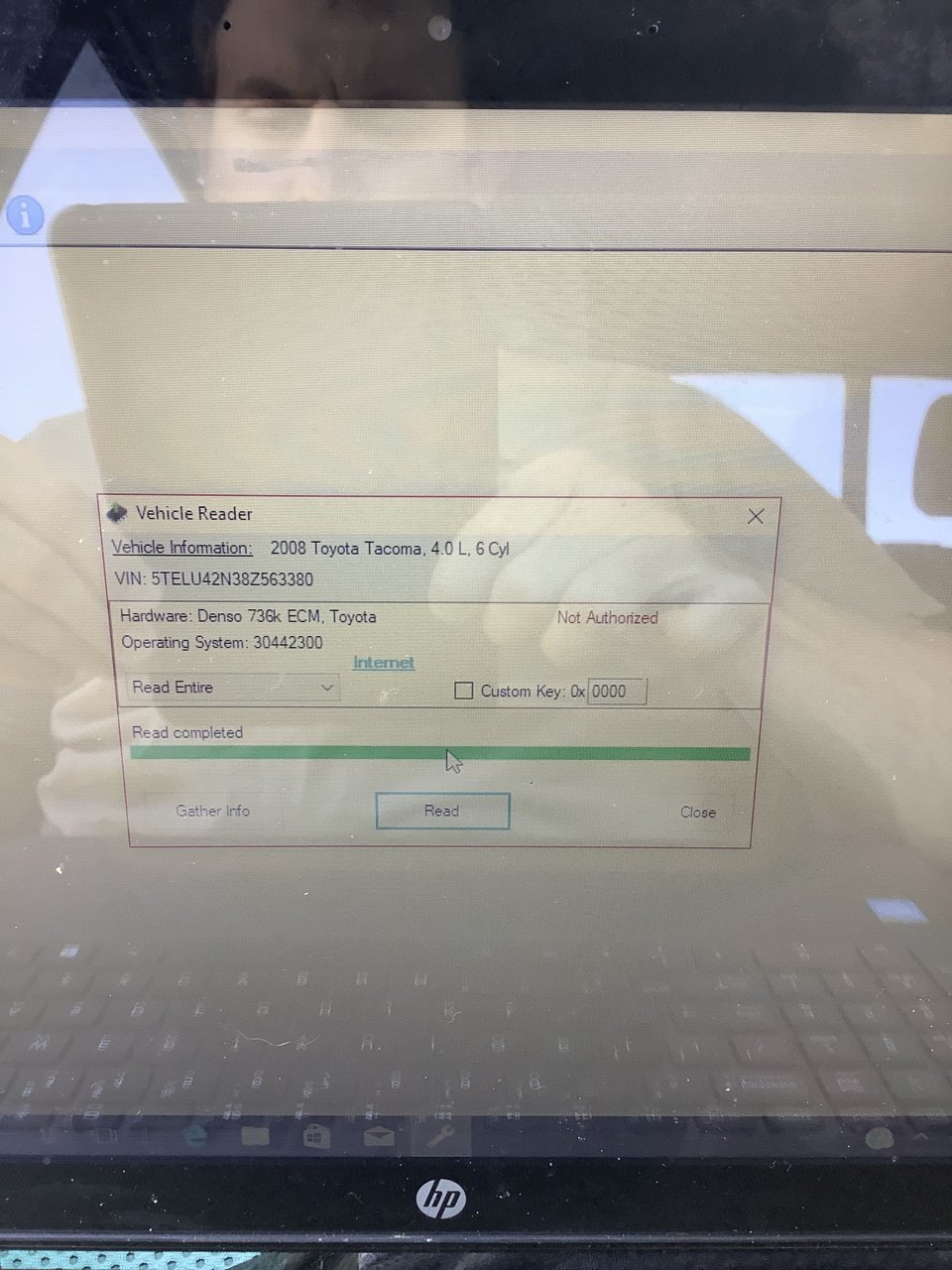

  18. Apr 25, 2019 at 11:53 AM
    #2138
    DiamondW
    DiamondW Stockblocker
    Feb 1, 2019
    #281480
    2,206
    Kent
    Gonzales Co. TX
    ‘06 AC SR5, ‘17 Tundra, ‘14 GX460
    Ok gurus, what did I not do right?
  19. Apr 25, 2019 at 11:57 AM
    #2139
    DesertRatliff
    DesertRatliff Well-Known Member
    Jan 14, 2012
    #70618
    2,463
    Mt. Hood, OR
    Mas Tacos Por Favor
    ^^^Did you download and use the Full version or download the Full and then download and use the Beta?
    EDIT: We need to be using the Beta. This happened to me when I used the Full version.
    DiamondW and JustDSM like this.
  20. Apr 25, 2019 at 11:58 AM
    #2140
    DiamondW
    Feb 1, 2019
    #281480
    2,206
    Kent
    Gonzales Co. TX
    Yes. Downloaded full then beta on top. But I had a feeling it didn’t overwrite it. Looking into that now, thanks.
