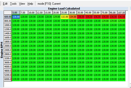

    Yes. Note, tables below are not from a Tacoma, just toyota.
    Also there are tons of MAF cal resources online. here is something from youtube
    https://www.youtube.com/watch?v=NmvQHXN4mkg
    tons more on youtube as well.
    For MAF, basic calibration >
    Take diameter of original tube, (lets say 85mm) square this value
    Take diameter of new tube (lets say 105mm) square this value
    Take new tube value divide by old tube value - should get around 1.39xxxxx
    Select your MAF scale G/sec, and multiply it by 1.39. Which should bring you near the necessary calibration.
    Check your fuel trims. In my opinion you do not want to make adjustments off your trims right away. You need to check your LFTs more than your SFTs (first)
    do a short drive, try to sweep between 10 and 100 g/sec over the course of 3-5 miles.
    Check your LFTs > check positive or negative trims. check where your LFTs change (from pos to neg, or one number to another), and check your G/sec range for this area. (lets say from 20g/s to 50g/s your positive trim is "+10%") then you can take these trims and reduce or increase these ranges by it.
    After doing this a few times you should check your combined trims and check that you're within 5-10% (10% being pretty high) either pos or neg.
    When you change camshaft timing, you may also notice changes in AFR. You should not make changes to your MAF scale to compensate
    Rather I've found it more effective to make changes to your MAF comp tables
    (these)
    (/128 for 1.0 value)
    This will change your calculated load and resulting fuel.
    You can also make fine corrections for valve angle with these, if needed (there are multiple of these in 4D sets)

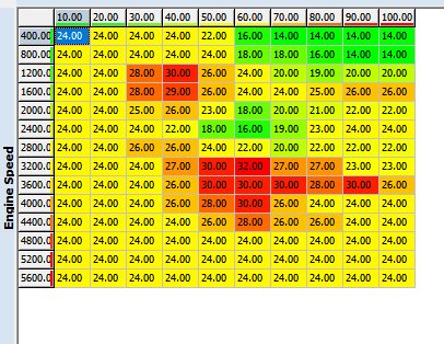

  8. Apr 25, 2019 at 4:14 PM
