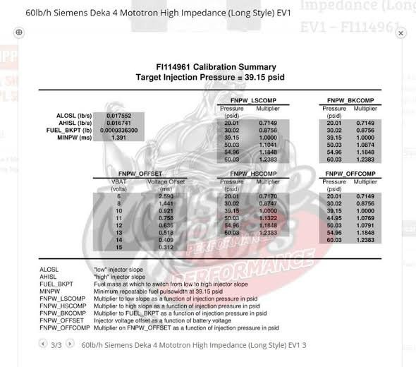

    @Roostfactor you have these injectors also. Did you see this?
    Thank you @Hacktacular

    The data in that sheet is all that I need to get those injectors dialed in.

    Don't you have these injectors as well, or are they a different size. If they are the same, I might still have the chart that we used for your tuning. Maaaaybe. 43.5 psi.
