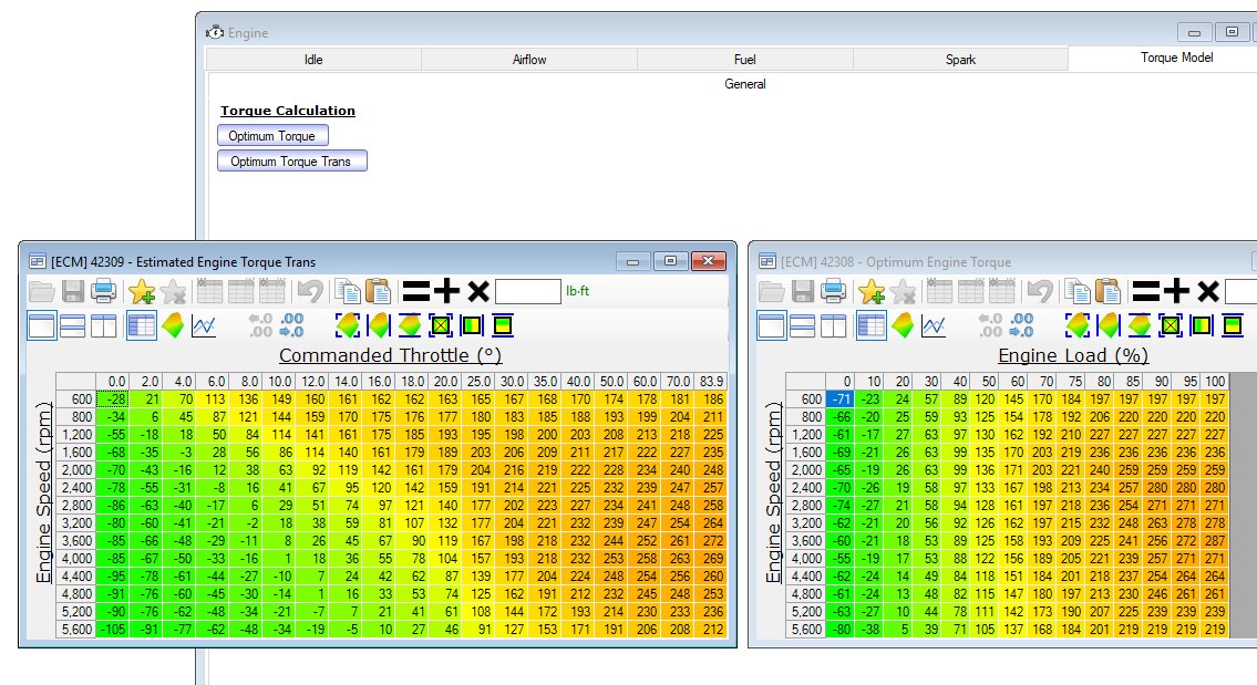

    Is anyone (maybe @HPTuners ?) able to shed some light on what exactly these do?

  9. Apr 30, 2019 at 3:50 PM
    #2369
    OVTune
    OVTune Well-Known Member
    Mar 27, 2017
    #214557
    8,112
    OVTune
    left side used for calculations controlling transmission shifting (firmness / shift related)
    (higher values - firmer shifting , rough shifting can happen)
    Right side used for calculations for Engine Torque (throttle control, among many other things)
    (higher values - changes torque calculation, can cause throttle reduction)

    Appreciate the overview. :thumbsup: I may tinker with the left one a little bit to try and mitigate a 4-5 shift flare that happens on occasion.

    OVTune
    Log the throttle position and engine speed where the flare occurs, then increase values on the map in this area.

    I have a couple logs where it occurred, digging through them now trying to find the right ones. I appreciate the guidance!
