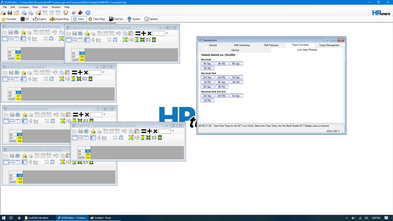

    Also, currently running JustDSM's v1 tune till the weekend to get a baseline, truck is running good, feels more peppy and responsive for sure. Then going to switch to his v1 with some adjustments to VVTi angles probably on Sunday.
    I am working currently on some changes to trans shift points to essentially raise shift points of lower throttle openings by 3-5mph, as well as alter when 5th lockup occurs. (To try and mitigate some hunting while driving around at slower speeds).
    Im a little curious about the 5 windows on the left in the picture below (found under the general tab of torque converter). Weird to see a negative value for Hot mode disable trans temp. This is the only way I can make sense of the apply/release tables pictured. Looks like they define the trans temp limp mode value? Currently under normal running only 4th and 5th will lockup. But "Normal Hot" allows lockup in 3rd as well (2nd gear values all have driveshaft speeds that far exceed what 2nd gear will ever be able to do) and all the values in the hot tables (Normal hot, Normal Hot D3/D2 are all the same) are at a lower output rpm than Normal.... meaning it wont let as much heat build in limp mode.
    Am I thinking about this wrong? I feel as though there are still "missing" tables within the auto trans, as mentioned above the adaptive functions as well as "cold" functions, I know the trans wont do torque converter lockup at all and may not even shift to 5th when real cold.

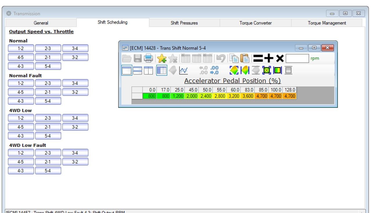

    For the AT guys with 4-5 shift flare, I did a log and captured the flare twice yesterday. It occurred at around 3300 RPM and 17% throttle angle. I added 10% to these cells and so far I have not experienced it again. Will continue to monitor it for the next few days.

    Nice work! :thumbsup: Do you have a shift kit installed such as the ratiotek? I very rarely get the flare these days but every once in a while... I'll give this a try too.

    10% is kinda huge, you may want to consider doing some interpolation around that. But glad you got it sorted!

    I started with 5% and it still did it a little bit so I bumped it up to 10% and it seems to be cleared up. It may surprise me later on and do it again, but so far so good.
    :fingerscrossed:
