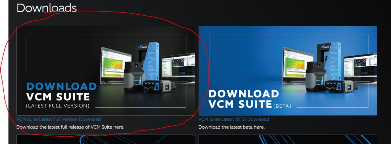

    So, Tonight I downloaded and installed the full version.
    But, I should've picked the beta. Just my luck.
