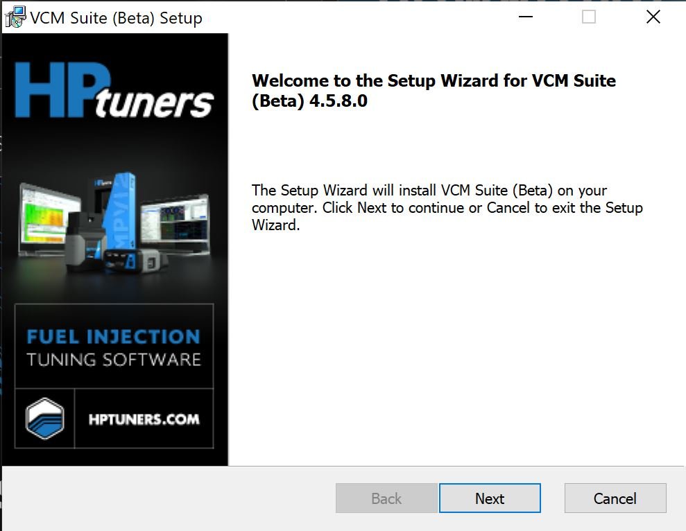

    Just install beta over top of it.

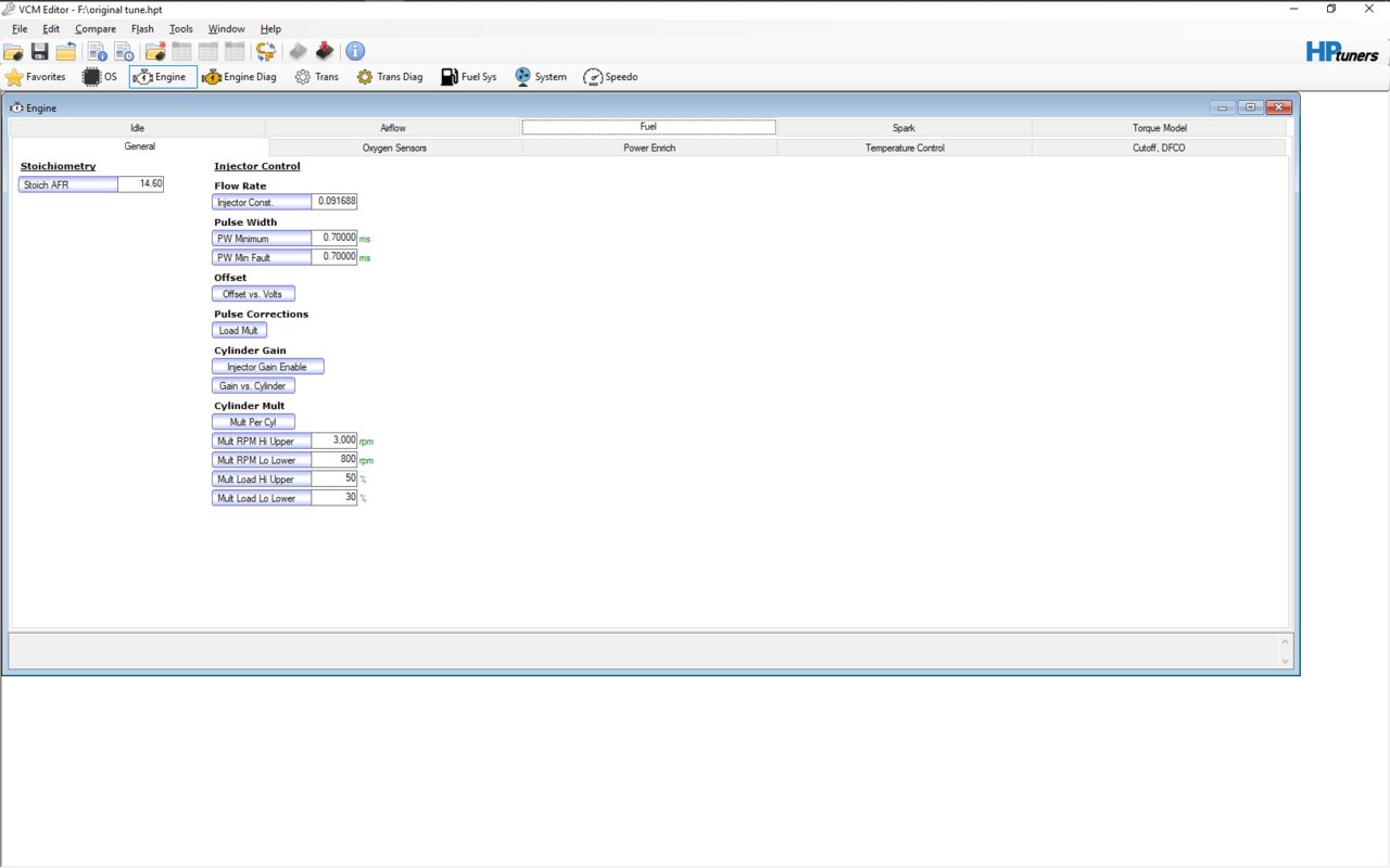

    OK. I'm in! Snatched the file off my laptop via the included flash drive and loaded it up in the desktop. Much easier on the eyes.

    Thanks for the clarification, but it would be really nice if your downloads included a version number, rather than just Digital Signature dates. (Let me know if I'm missing it someplace obvious.)

    When you try to install it, there's a version number that shows up.
    I get what you're saying, though. If the number was posted then you'd know whether to download or not. Me, I just download it and see what the version is.

    Been there, done that.
    I want to know what I'm downloading before I download it.

    That's why I said (under the picture) I get what you are saying.

    It's proven tricky to automate version number publishing via the website in our build environment. I agree it would be nice!
    You can go to Help -> About and see if there is a new update available and the version number.
