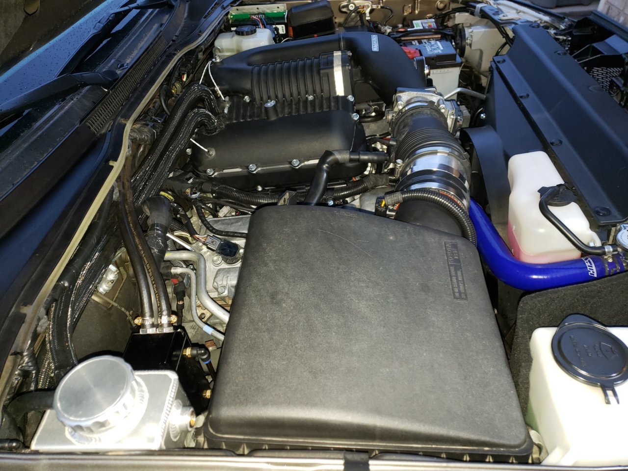

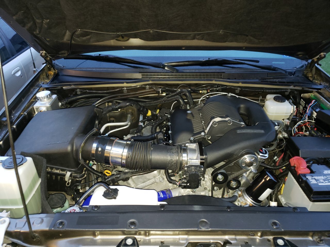

    I actually looked into this about a year and a half ago but never got the parts. Now I am ALMOST positive if you get any dvvti 1GR-FE intake, TV, and adapter, it will bolt right in. Copy paste the MAF tables and you are good to go except one major thing! The dvvti maf's are different than the vvti mafs most of us have so wiring up a pigtail for the new maf is still required.
    I think intake opening is 3.25". The Tundra is 3.5".
    So I bought a plastic welder, cut the Tundra intake at the bend (also where resonator box is), massaged some material and plastic welded it back together.
    I didnt clean it up at all but someone with plastic skills could make it look very clean. I'm not worried about it as it is still a temporary intake that I will use until I get caught up with some exhaust work!
    Thanks again for your patience!

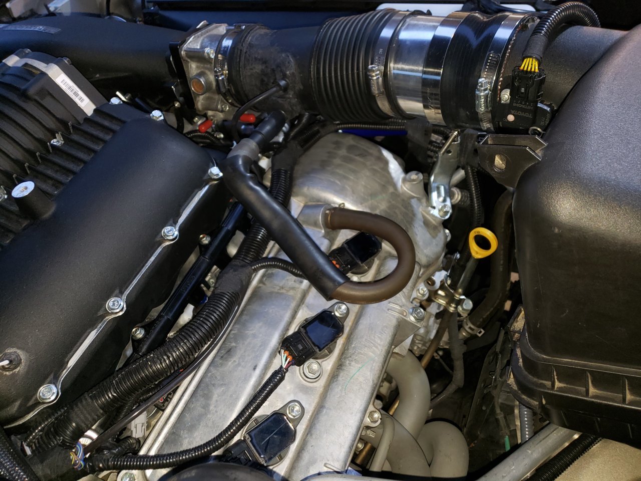

    Also note I removed the SAI valve mounting studs and replaced with bolts for a cleaner look.

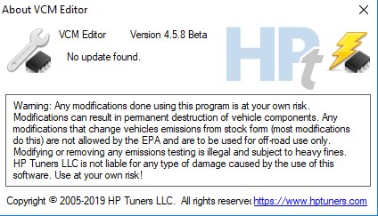

    Seeing all this progress makes me sad that I spent $1200 on the i0tech tuning suite in February and still haven't gotten it working... All I want is to get rid of the rev hang on the manual trans. That it all

    And yes! Rev-Hang! I'm all over this new software trying to figure out where it's hiding. Can't find it yet.
    Is there another version that has those tables?
