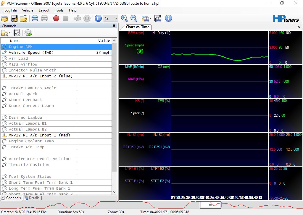

    So, I’m out and about driving the truck and taking logs. Using @JustDSM list of pid’s to scan. As soon as I start recording, everything blanks out. All I can see is vehicle speed. Is that normal?

    I get a screen full of stuff. Would be nice to be the passenger to watch all the things on the screen as it’s happening.

    You’ll need to re-configure your gauges, graphs and charts to use the new PIDs. Since you’re no longer logging the SAE PID lists you’re stuff is set to display PID’s that are no longer being recorded.
    All the data is still there, so the logs are “good” and useful. Even if the data isn’t displayed graphically.

    The grayed out pid's totally disappear when actually recording.
    Am I missing some sort of authorization for the software or something?
    Poking around in the editor, there seems to be a lot of missing stuff.

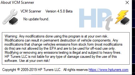

    Looks like you might be on a early version of beta or full. Go to “Help” and then “About” and let me know what version you’re running.

    Crap.. looks like they missed your calibration id. What is it? Tag @HPTuners and let them know.

    Please open a support ticket. I don't see anything immediately wrong as 3YWG2800 is in our database.
    Please include:
    - VCM Suite Info while connected to the vehicle
    - debug.dat
    - a scanner log file that doesn't work
