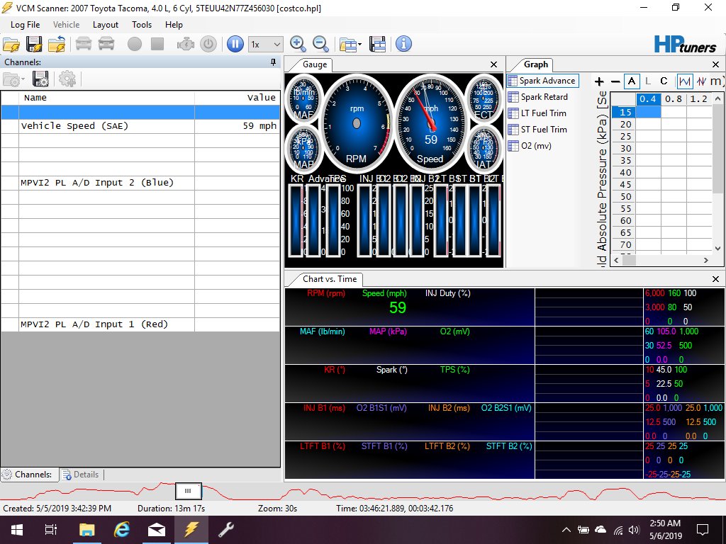

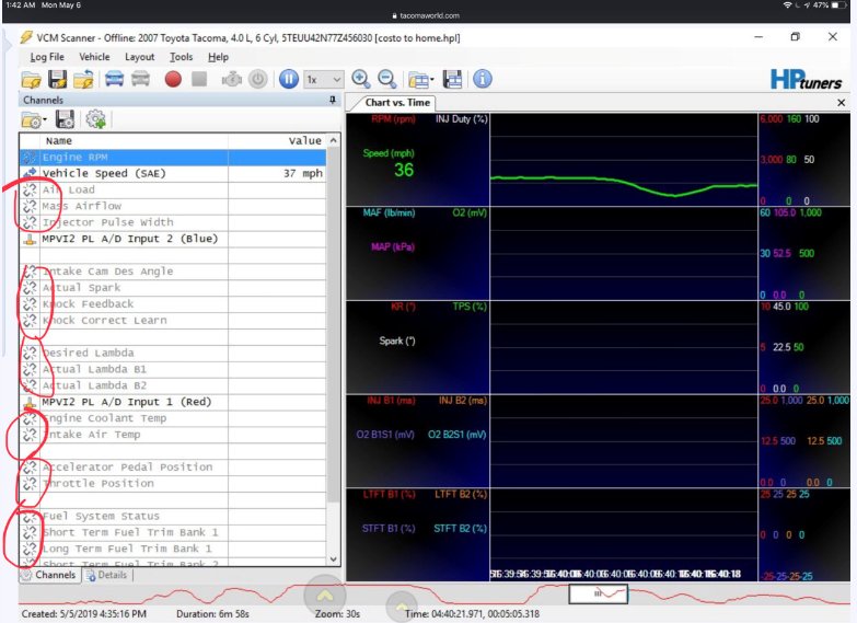

    So, @JustDSM
    It seems as if the PID’s you’re asking for are unavailable.
    On my scanner, the only PID’s available at all for scanning are the SAE ones. That’s what had/has me thinking that I’m missing some sort of authorization.
    I guess I’ll open a ticket. I just don’t want to be bothering them if it’s just me being a dumbass. How does one go about opening a ticket anyway? :confused:

    My shit is all stock.
    When I hit the space bar to record, The PID's vanish! All I'm left with are SAE vehicle speed and my two un-configured inputs. Which btw have no bearing on this issue. I've tried it with and without.

    Ogden, UT
    Unfortunately something odd is happening with your specific Cal ID or something. Please follow HPTuners suggestion to file a ticket (if you have not done so already), and get this resolved. The resolution gained from using the non-SAE PID's is worth it.
    I know they'll get you taken care of. They've been absolutely phenomenal in their efforts to keep us on track and running.

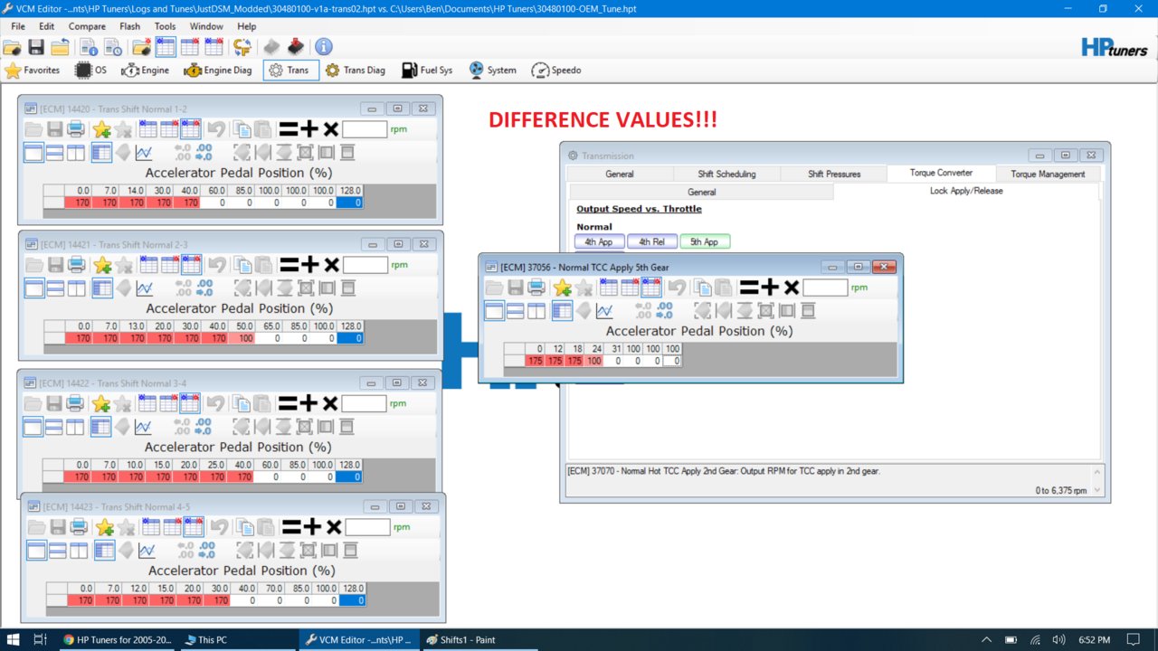

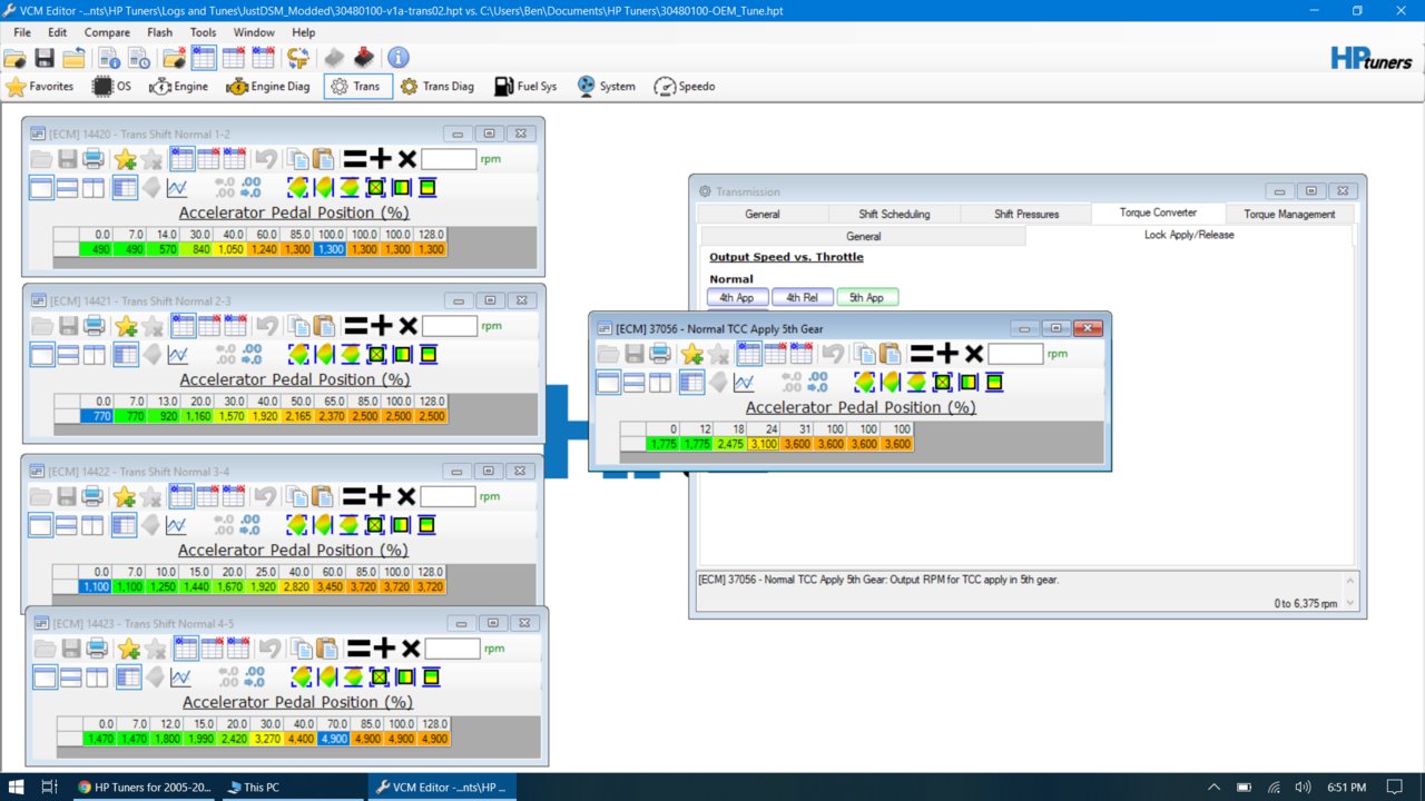

    Somebody wanna rub my nose into these tables plz ? I can't find anything in VCM editor.

    Ogden, UT
    The table referenced above was not “disable rev-hang” table as we had hoped. We’re still looking into the cause (as well as other things).
    I can assure you all that as soon as I’ve got news regarding rev hang I’ll be the first to update you all.
