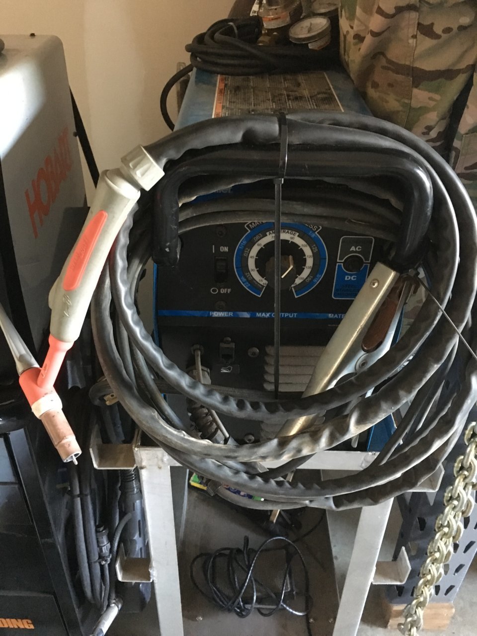

    I am going to get started on an aluminum intake with heat shielding (3.5” all the way to my Tundra throttle body). I don’t like the plastic tubing and am going to cover the aluminum in firewall heat shielding. Now I mount the MAF where I want it with a clean flow of air and picking up the intake inside the cowl for no snorkel. I have the 2.5” pulley setup but am avoiding any hard pulls yet without changing out the new injectors from FIC.

    Nice welders :thumbsup:

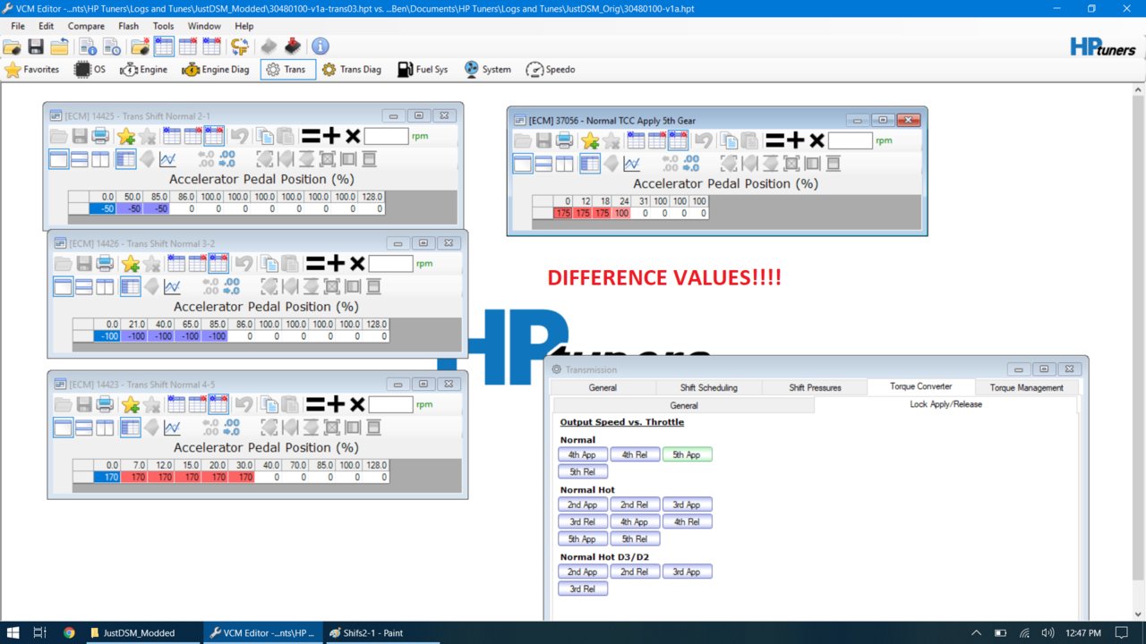

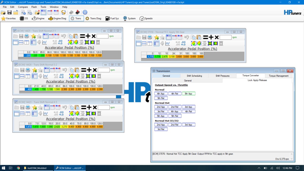

  18. May 8, 2019 at 12:52 PM
    #2578
    nd4spdbh
    nd4spdbh Well-Known Member
    Oct 7, 2013
    #114055
    14,598
    SoCal
    13 DCSB TRD OR v6 Auto
    Flashed the following changes before going on a short drive to lunch. Results seem good but I will need more time for sure. Decided to go about the low speed hunting in a different way by changing downshifts rather than upshifts to keep smoothness of my grandpa truck.
    The goal here was:
    • Reduce propensity to have to downshift (hunt) back to a lower gear between gears 1-3 at lower throttle openings (hence decreasing DS output rpms of those downshifts)
    • Increase vehicle speed at which the trans shifts to 5 / 5th locked, hence increased 4-5 shift / 5th tcc apply values.
    Essentially trying to decrease hunting during slower speed around town maneuvering and race to 5th feeling of the trans.
    Mech_Eng and JustDSM like this.

    Speaking of welders. I'm selling my Multimatic 215 if anyone here is interested. It's about a year old.

    I have a 215 and love it! Good luck with the sale. Back to tuning.......
