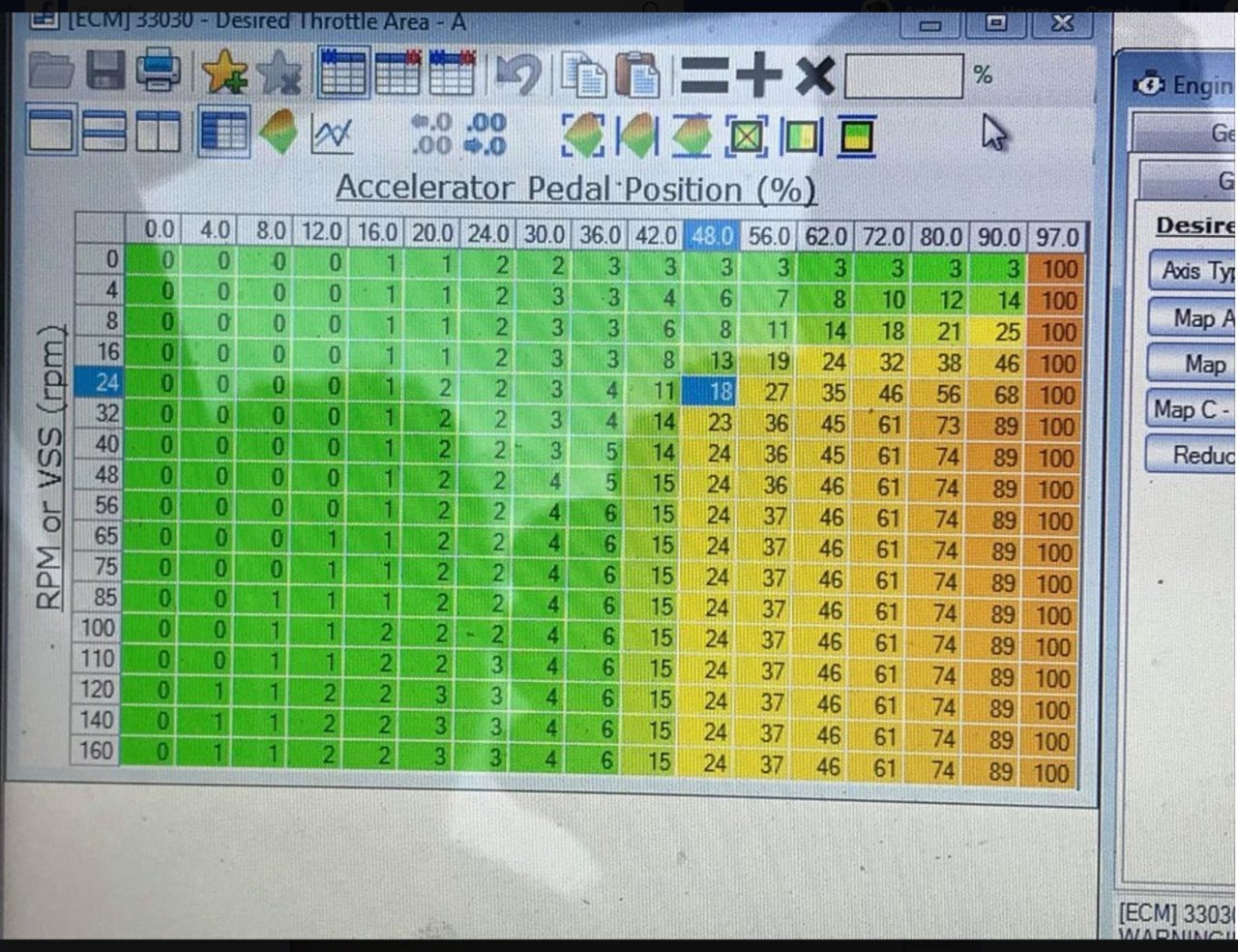

    This is a throttle map from my brothers Saab 97-x with the 5.3L. It’s so bad from the factory

    You really have to stab the throttle in that thing!

    Over 33% pedal position at 6% throttle opening! Wow! I know every engine is different but it really makes you wonder how the OEM driveability engineering team came up with those values?

    Some of that may be for when the EPA did MPG tests. Less likely to guzzle fuel if you have to stab it so far to get to WOT. Just spitballing.
