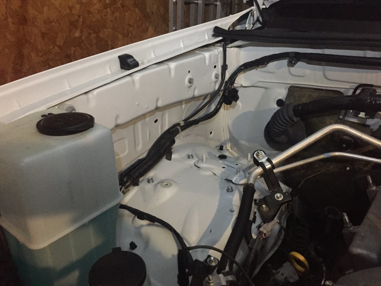

  14. May 8, 2019 at 5:42 PM

    What did you do with the hole in the intake box?

    Hole in the airbox? One is for the crankcase breather and the other for the FPR. Both are plumbed exactly back to OEM locations. I still run a modified stock airbox fed directly with the Volant scoop.

    Disregard, I thought you had a Volant airbox like me. That has the pump integrated in the box and leaves a hole that needs a cover.
