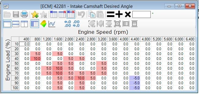

    I didnt want to post the difference map on here as you were the one that provided the tune. @JustDSM again showing some awesome help and support to the cause with this!

    I very much appreciate you guys not sharing the maps openly. I'm happy to give you complete access and the freedom to see what you're getting from me, but I'd very much appreciate the maps I provide be kept off open forums.

    ABSOLUTELY! This is your work, not something for me or anyone else to share specifics on, as always you have been amazing explaining changes and showing where you made changes on a one on one. Again, THANK YOU for everything!

    To piggy back off VVTi tuning, I wonder how ACIS plays into this (considering ACIS is ONLY activated stock in a medium rpm range ~2200-4100 at higher throttle, which also just so happens to be where a good amount of VVTi angle is and has been added above). @Torspd In the stock intake, does the ACIS actually increase intake runner length or simply change acoustic properties to make things better for NVH numbers?
