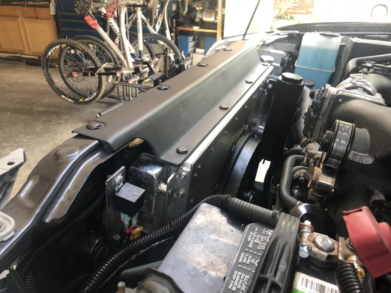

    I wonder if the intake scoop will interfere with my DIY radiator shroud. I’m thinking it shouldn’t since the stock plastic cover fits.

    If the stock cover fits, the scoop should fit no problem.
    The top of the scoop attaches to the same place that the top of the cover does, and the bottom part slides over the top of the radiator, to pull air from the grill

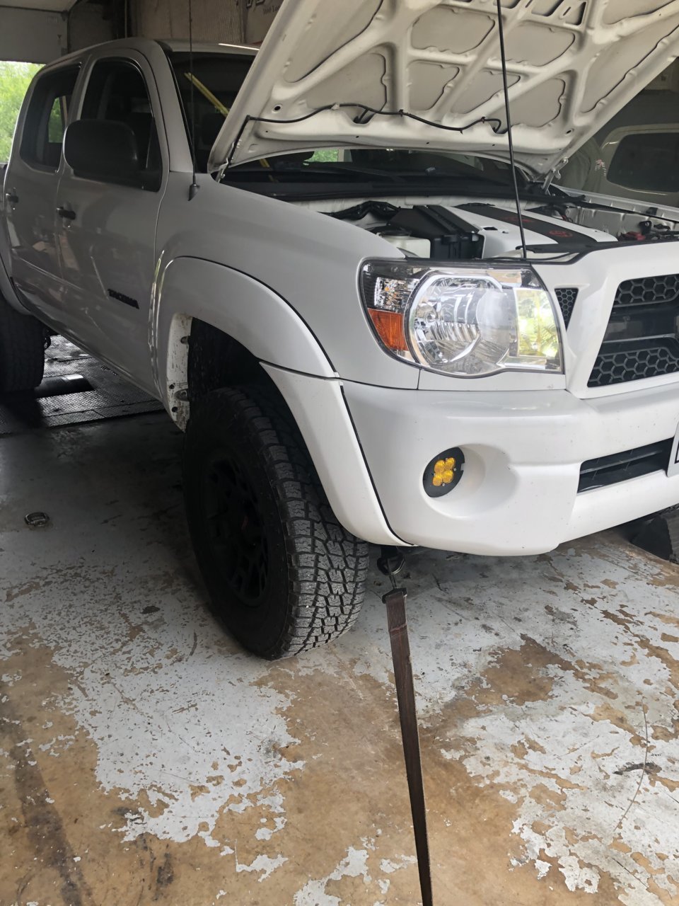

    @DiamondW did they let you do the runs or did they drive your truck on the dyno?

    Doh!!! And maybe someone can chime in, but is it normal to start the runs at such a high rpm? I mean it doesn’t matter for peak power, but because of where these were started and how inconsistent the starts look, I’m seeing 50+hp losses in the 3250-4000 rpm range on the tuned runs. Could be my phone making it hard to differentiate colors, but that cannot be right.

    If the dyno operator is trying to prevent a downshift they start runs at high rpm.
    You kind of need a map to lock the gear if you want to test maximum potential, but it's not comparable to stock form cuz youll never see it stock form.

    OV nailed it, shocker :) That’s why he is I’m the business. We were having an issue with downshifting.

    The owner did it. He asked how I wanted it done though. I was I’m the passenger seat trying to datalog.
