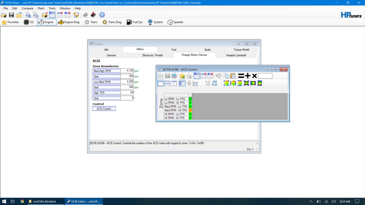

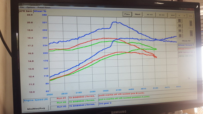

    ACIS definitely works.
    My "problem" is the way it works on the dyno vs the way im interpreting it within HPTuners is saying two different things.

    A camera never hurts. Just don't reference the blue graph. That is when the Haltech is controlling the engine functions.
    The prior chart is the one for best reference, as it has all three states of operation.

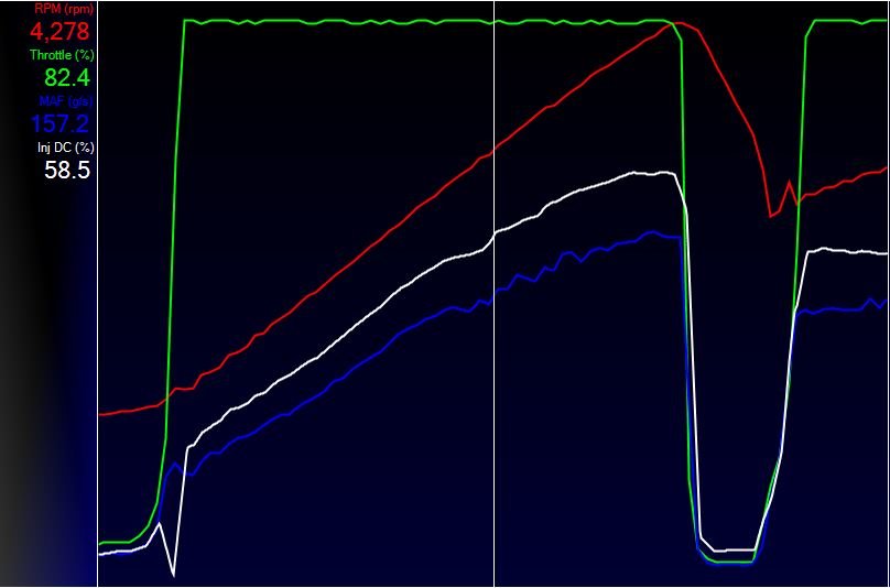

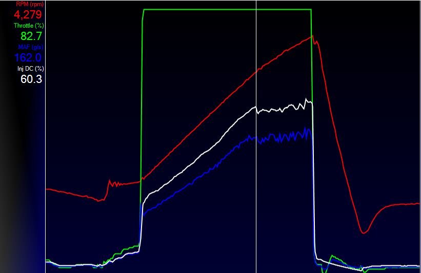

    **The screenshots below are from a non-standard ACIS switching point of 4250 (Stock is 4100)**
    Don't have time to explain, but I think these graphics of simply changing the ON/OFF are quite noticeable.

    Re-uploaded the images to make them more "apples-apples".

    Would you agree that what we are seeing in HPTuners vs how it actually works / what the dyno charts show is different?
    This is true, anyone with a TRD cal, poke your head in there n see if its available.
