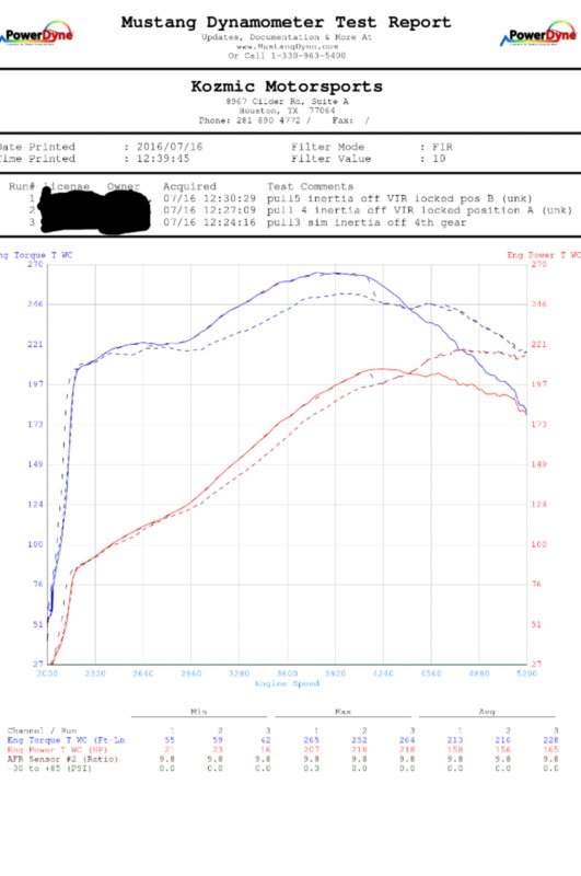

    I know nothing about tuning. I’ll pay someone to tune mine whenever I get my exhaust! :spending:

    BassAckwards Well-Known Member
    May 3, 2016
    #186002
    27,954

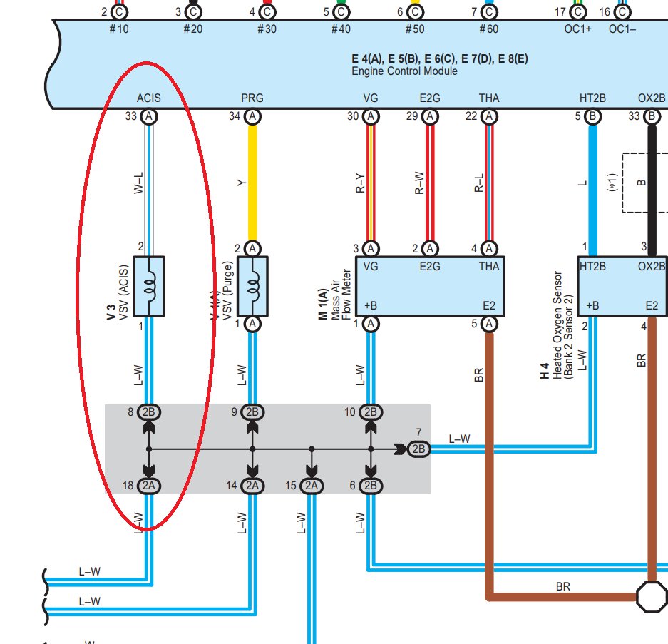

    Im guessing this is the plug near the passenger rear side of the blower?

    In regards to power made above the ~4100RPM switching point I can say without hesitation that the difference is observable in feel, and visually in the datalogs. There is a pronounced boost in output with the ACIS "Off" above ~4100RPM.
    Here's what I see in the dyno results posted by @Torspd and how they relate to what is defined in the HPT VCM Editor. These were done with an aftermarket EMS or at least done with control of the valve independent from the stock ECU. I surmise that the 4100RPM switching point was known, and thus used in this test to show the effects of the ACIS valve in a constant "On" and "Off" state and one run transitioning from "Off" to "On" at ~4100RPM. Obviously these tests were all done at WOT on the dyno, so it can be assumed that the throttle is open >60°. So the charts posted here are not representative of results obtained how the ACIS system is configured from the factory.
    In stock configuration the ACIS is configured like so:
    RPM/Throttle Angle
    Low/Lo: 0
    Low/Hi: 0
    Med/Lo: 0
    Med/Hi: 1
    High/Lo: 0
    High/Hi: 0
    RPM: Low = <2200RPM, Med = 2200-4100RPM, High = >4100RPM
    Throttle Angle: Lo = <60°, Hi = >60°
    Knowing this, It's clear the ACIS operation in factory form (at least from >2200RPM)does correlate to the tests performed by @Torspd. Below 2200RPM, though, the factory configuration is set to have the truck run with the ACIS "Off" (or in Short Runner) mode. To exactly copy Tor's results, you'd want the Low/Hi to be set to "1", to put it back into the "On" position (Long Runners) to boost the torque gained from that (as shown in the dyno).
    I hope this helps.

    Not sure if the UCON passes that signal through, but if you were to intercept the wire pre-UCON, yes the stock N/A ECU would still output that signal (and thusly could still "tuned" via HPT)

    Any idea what kind of voltage this plug would show if it was functioning? I can do some testing with a multimeter to see if mine is alive
    When does this even function? If its at wot then i wont be able to test the connection lol

    I don't have the schematics in front of me at work (@loginfailed?). But generally the ECU triggers a ground to actuate solenoids like this.

    Like JustDSM stated its an ECU switched ground. The Blue with white stripe is a switched constant 12v, the white with blue stripe goes to the ecu and gets grounded when the ecu wants to move the ACIS valve.

    I "tested" that in Mexico yesterday evening, and it's noticeable. I was going to update all N/A cals, except yours.. :p
    Thanks @Torspd for providing the dyno sheets. It confirmed my observations via datalogging.
