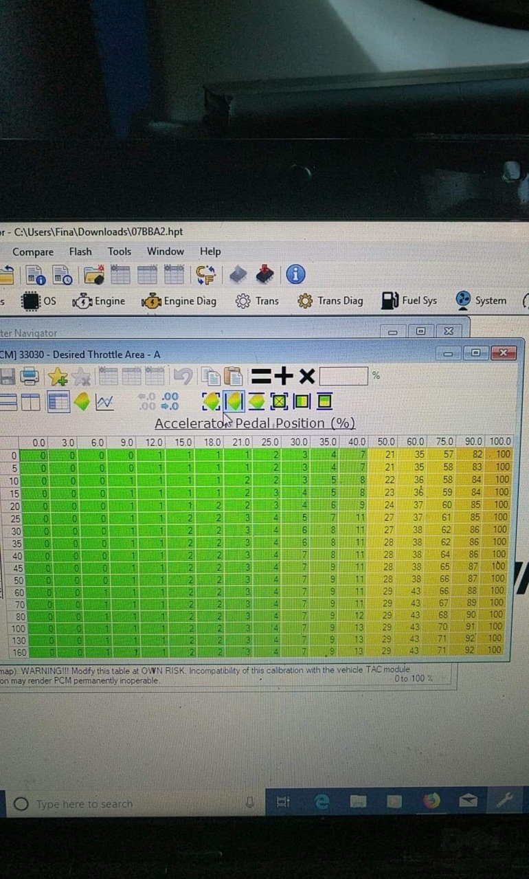

    Here is the simple and beautifully executed line graph for modifying the APP to TB, on the Haltech Elite. This was taken before adjustment.

    I uploaded a rather aggressive throttle map (nearly 1:1) with some lag on the lower end of the spectrum for drivability at low speed/throttle input.
    It certainly wakes the truck up and it's EAGER to get going. It's amazing.. I'd wager a $1.00 that adjusting the throttle mapping alone and leaving the rest of the tune stock would make more difference in seat of the pants feel than $2,000 worth of bolt-ons.
    I'm going to return my throttle mapping back to a less aggressive version as this would be WAY too much for off-road use, and my truck does get used in that capacity so it's not all "race truck" for me.. (boo, I know..) But I do have a very workable aggressive throttle mapping strategy.
