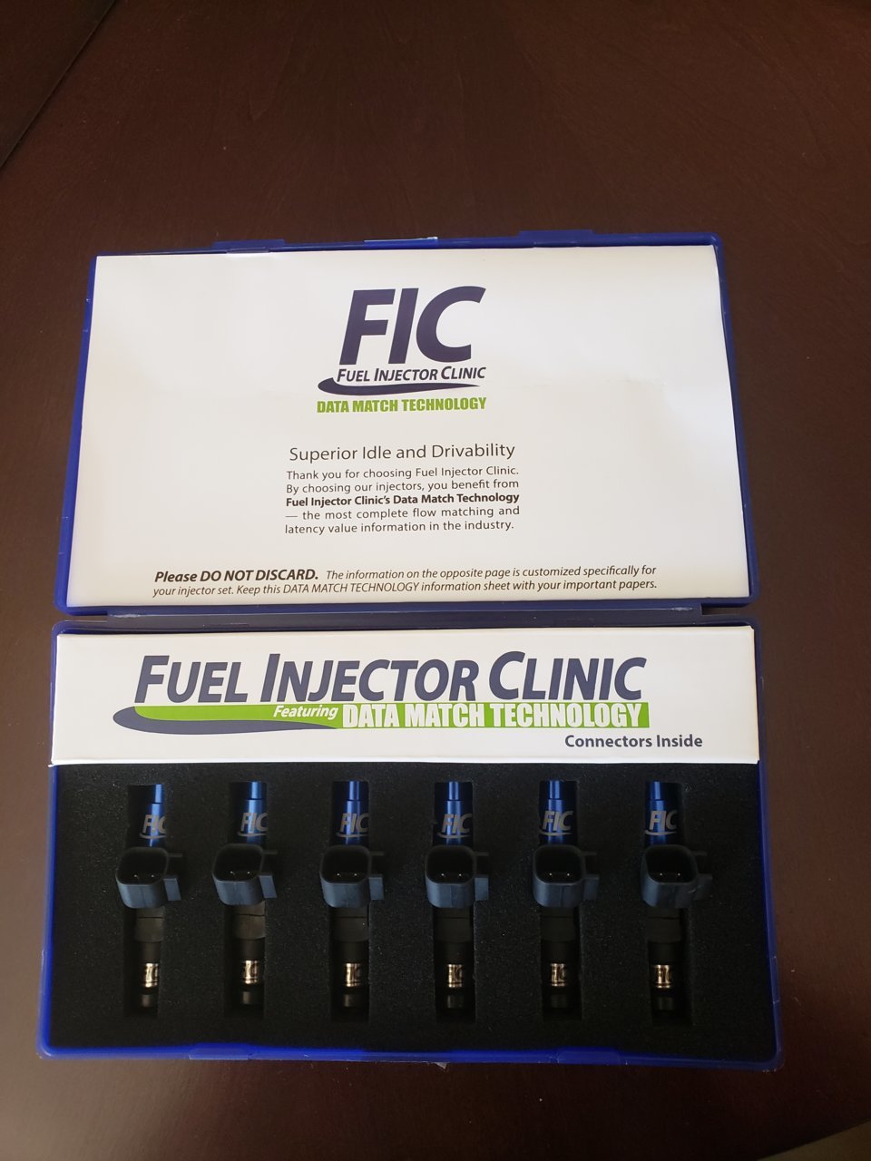

    welp just got some FIC 650cc injectors. i have a bad stock one (me thinks) and figured what the hell lets get some good replacements.
    also going to be putting on my quick change pulley to play with different size pulleys.

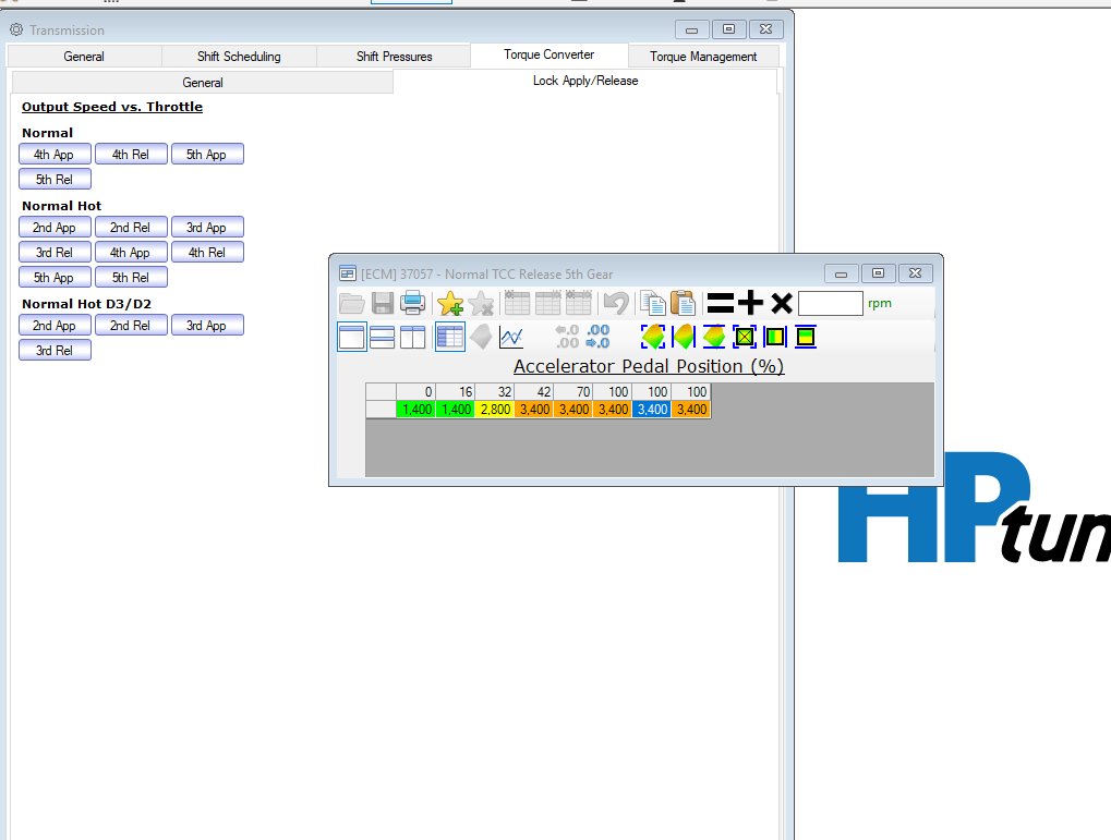

    am i reading this table correct? at 1400rpm it takes 16% throttle and it unlocks? at 2800rpm it takes 32% to unlock? etc.. engine rpm or driveshaft rpm?
    also do all these tables that say pedal percentage really mean tps %? because in cruise the pedal reads constant

    anything regarding trans shift points and tcc apply and release all relates to OUTPUT rpms (driveshaft). As far as pedal % im not sure. Id imagine being drive by wire, on cruise control, the ecu "simulates" a pedal %. Ill grab a datalog on the way home of cruise control to confirm this, also TPS% dont go to 100, typically around 80-81

    Yes it is pedal %, always transmission shift/TCC etc. tables work based on the drivers "intent" regardless of what the throttle blade is doing (sometimes the drivers demand is converted to a torque value instead of pedal. You are almost correct for cruise. Cruise commands a certain amount of throttle angle when active, the code chooses the highest of cruise commanded throttle and the driver (pedal) commanded throttle. That's how you speed up when you hit the gas when cruise is enabled and when you lift off cruise continues.
