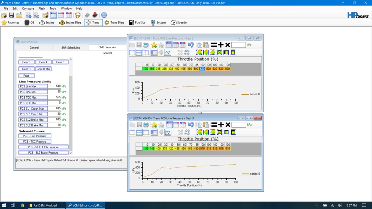

    Next, in my spelunking into auto trans tuning. I found it rather odd the shift pressures of 3-5 gears (which are all the same values) have a high pressure spike at the 20% throttle position. Im wondering why that is.
    FYI gears 1 and 2 have the same values
    Also would I be correct in thinking that upping values of say 100% throttle position would firm up WOT shifts? (obviously no higher than 540)
    Roostfactor and 1slow4.0 like this.
