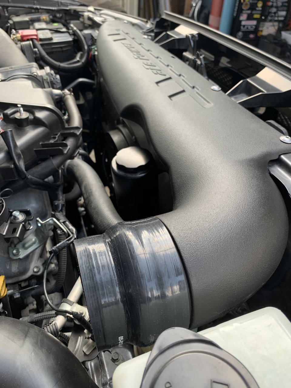

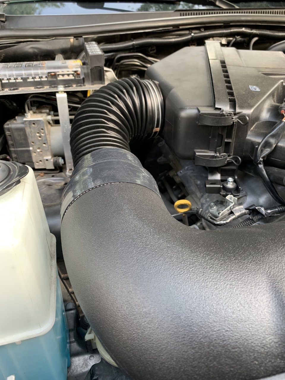

    loginfailed
    loginfailed Well-Known Member
    Aug 29, 2016
    #195923
    5,156
    Dwayne
    Houston, TX
    2014 DCSB 4WD
    The AFe comes with a 4” to 3.5” reducer. I might order different parts later so it can be 4” the whole way.
    Still waiting for my other pieces to arrive, but the scoop is on and it’s outlet appears to be pointing in a good direction.

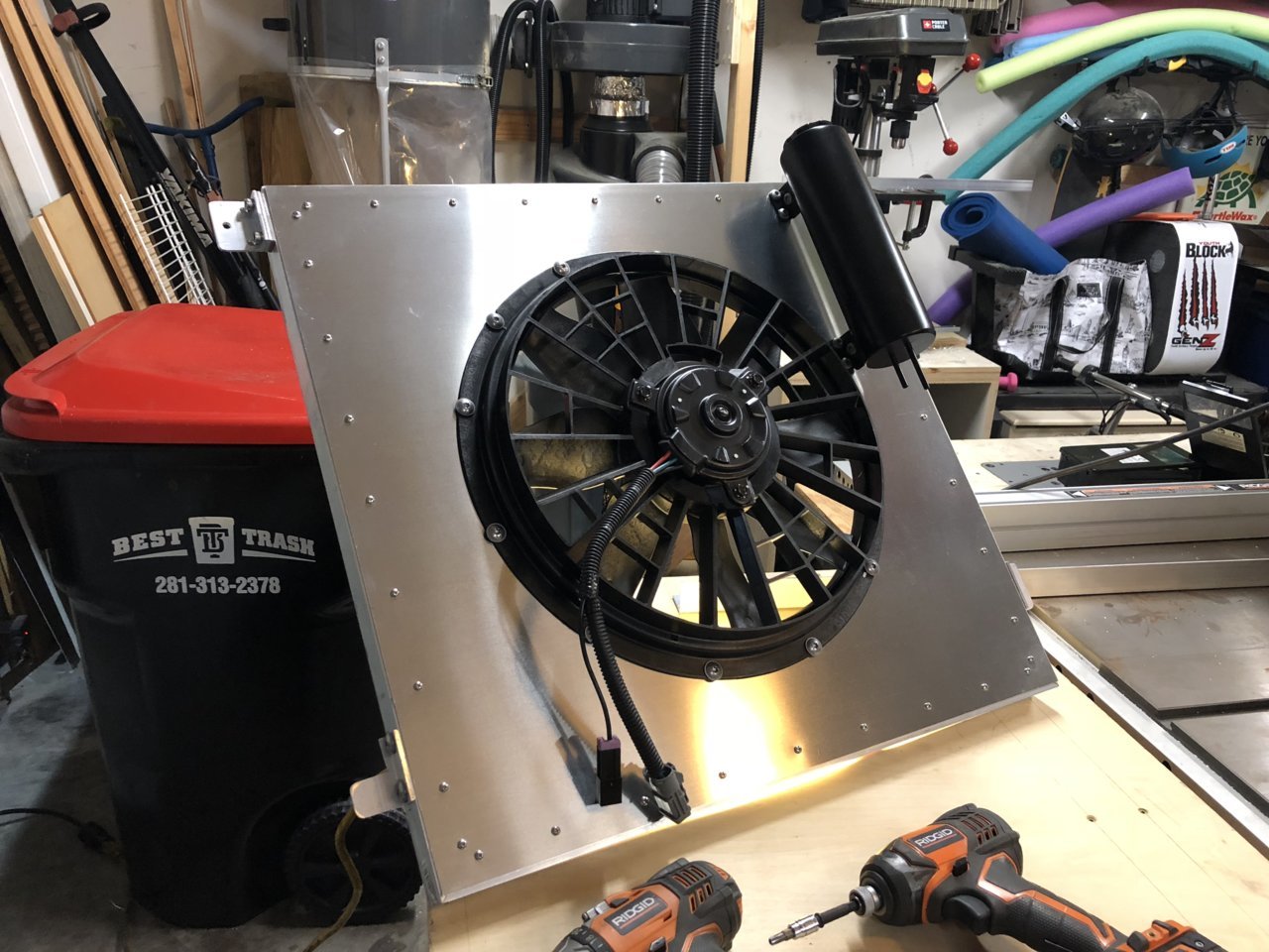

    Any fitment troubles with the FJ shroud/radiator?
  16. May 16, 2019 at 3:38 PM
    #2856
    loginfailed
    Aug 29, 2016
    #195923
    5,156
    Dwayne
    Houston, TX
    2014 DCSB 4WD
    Nope, the only interference I ran into was a bundle of wires I ran from the driver side to the passenger side. I only needed to reposition them slightly.

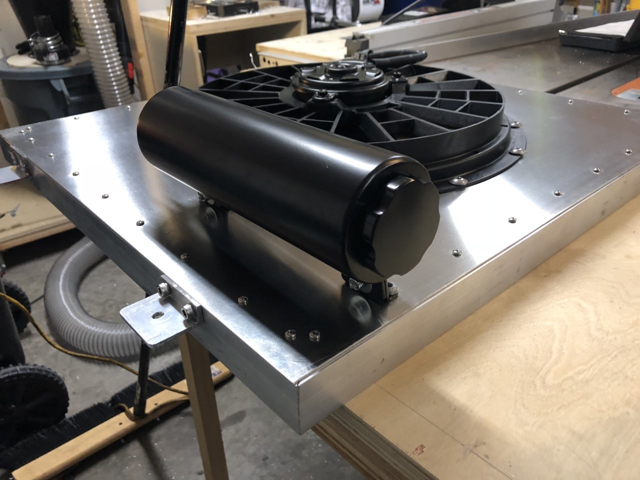

  17. May 16, 2019 at 3:49 PM
    #2857
    loginfailed
    Aug 29, 2016
    #195923
    5,156
    Dwayne
    Houston, TX
    2014 DCSB 4WD
    My shroud and reservoir are sort of custom. The reservoir is mounted lower than the FJ and doesn’t interfere.
