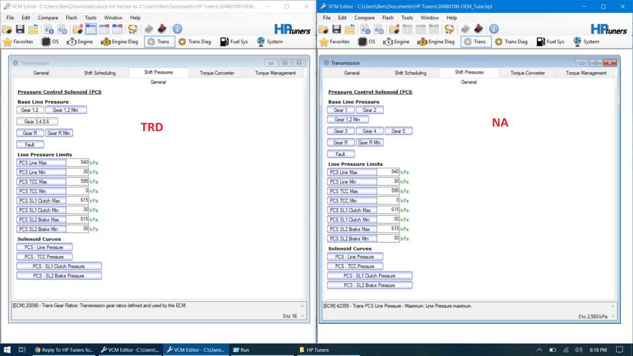

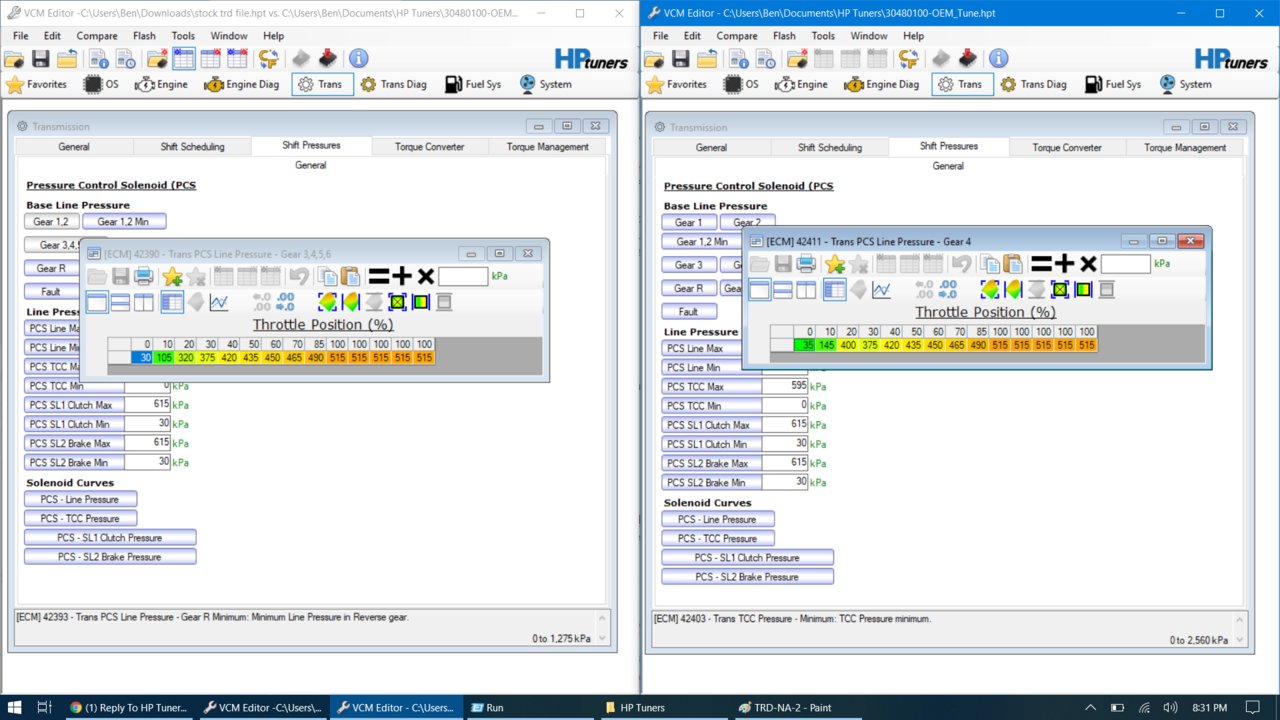

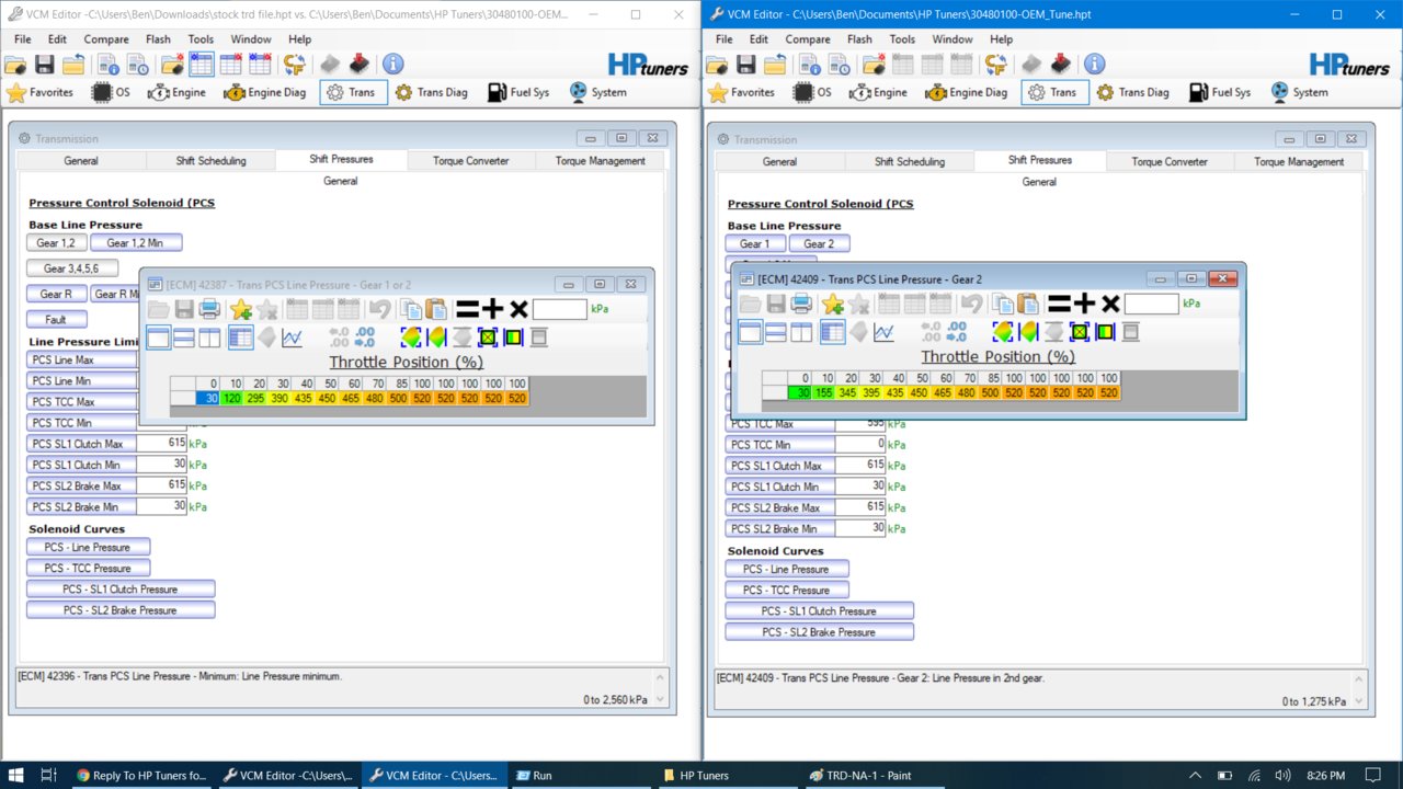

    Nope, OD is 5th gear.
    Shift scheduling says nothing about a 6th gear, nor does trans gear ratios on the TRD cal, but you are right, in the throttle pedal mapping there is a 6th gear reference ... WTF?

    RPM and Speed are used to *estimate* gear (as I understand it). All cals are setup for 6 gears in the throttle mapping.

    No shit.... just opened up my OEM NA cal and sure enough it has a 6th gear for the throttle pedal mapping lol. But no other mention of 6th in the spots that i have found that i mentioned it showed up in the TRD cal.

    Some tables are vestigial from a "master cal"
    There is also a table that has individual cylinder fuel trims, and has 8 cylinders in the table.
    just like how the TRD cals have 2 MAF sensor scales, or how the IS-F has like..4 MAF scales

    Haha, yup, lots of take cookie cutter programming, and make it work for this application. I cant blame toyota for doing it, makes sense!

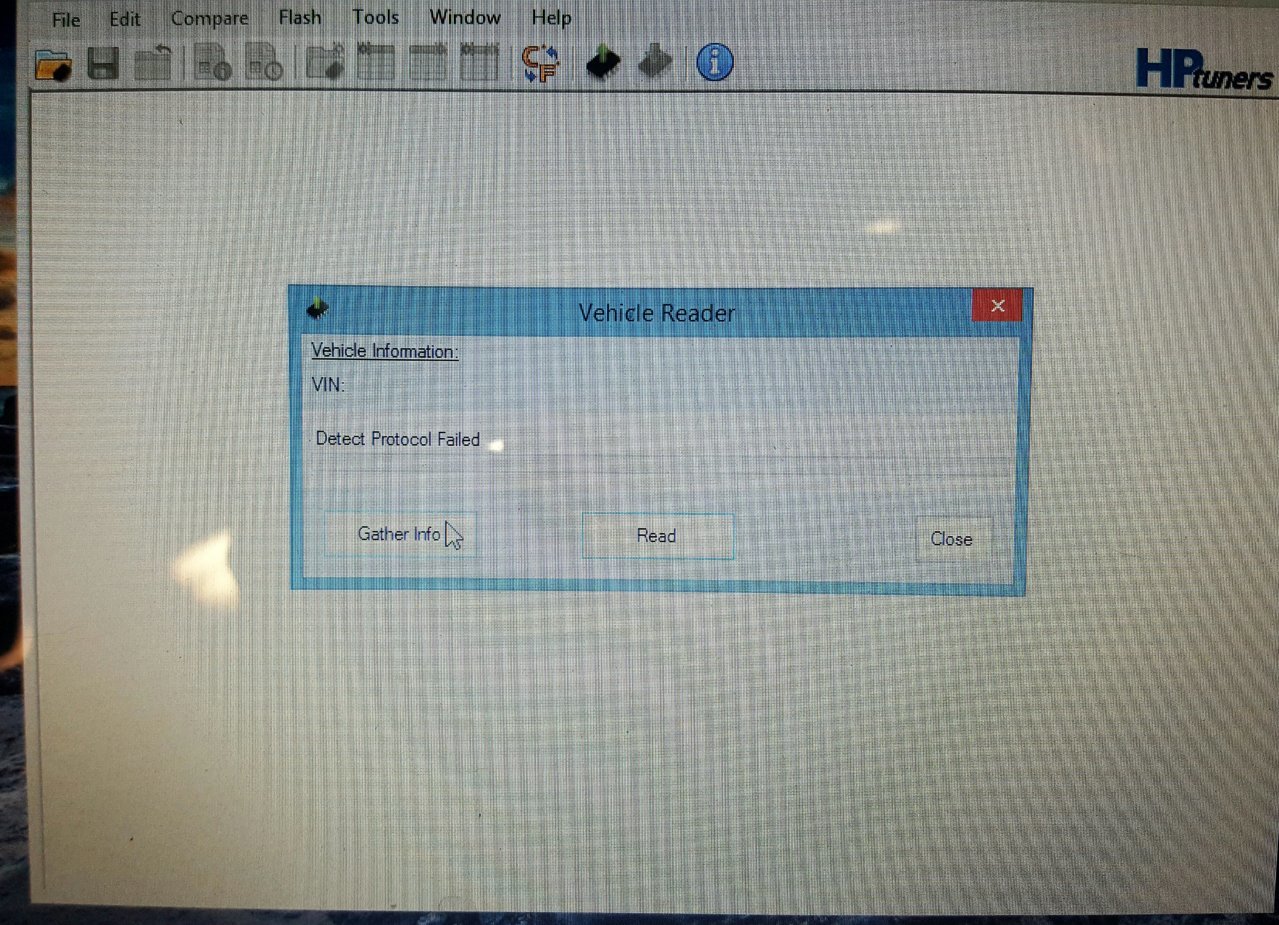

    Has anyone had issues with their obd2 port shorting out? I must have a loose wire or pin in the connector because I get intermittent power issues.
    Have not attempted to write any files to the ECU until I figure this out.
