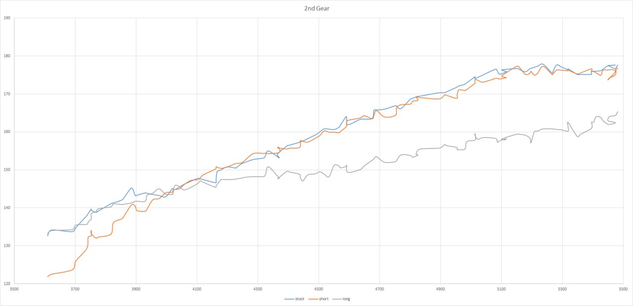

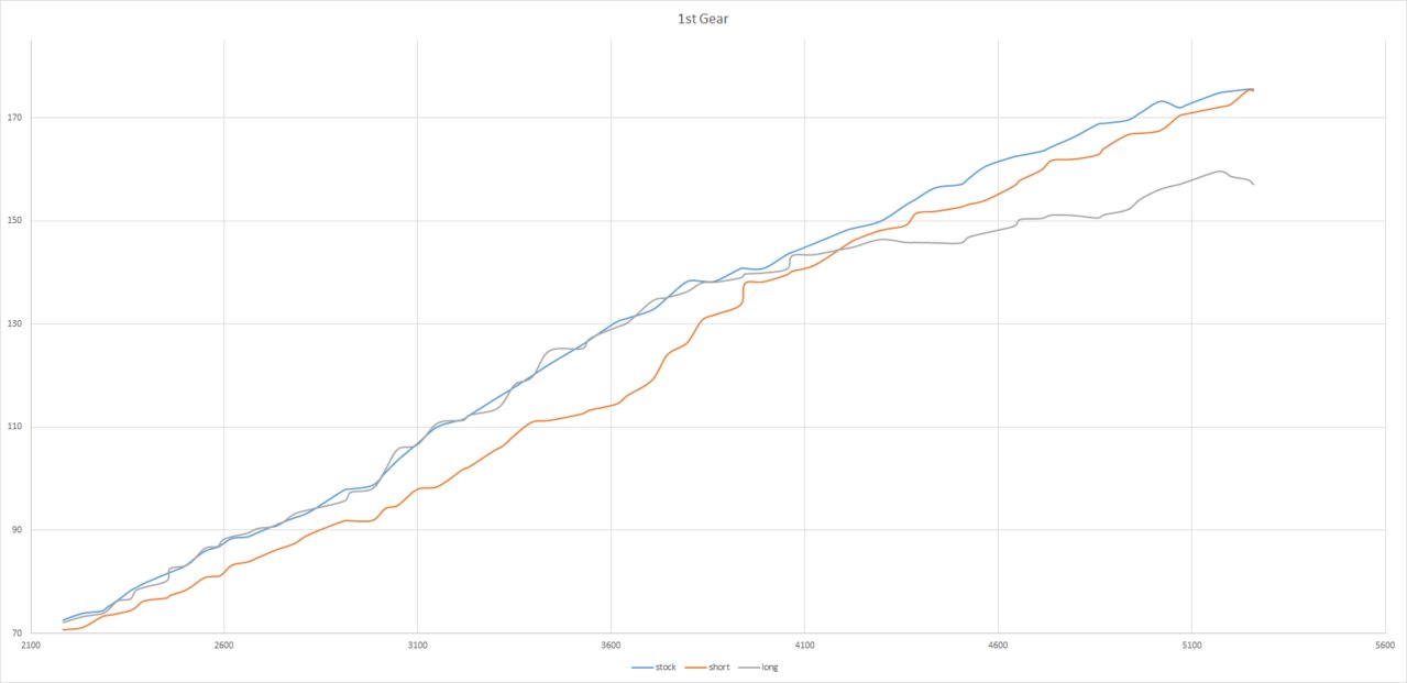

    To continue on the following post of mine
    I did some more testing today with regards to ACIS functions at less than WOT.
    Overall takeaways.... even with a stepped throttle mapping (so i didnt have to flash seperate 25% throttle at WOT pedal and 50% WOT pedal) it was hard to get the smaller 25% step consistently, I was able to do ~33% but minimal %age changes yielded radical maf number changes at those low throttle openings. But after some exponential smoothing of data you can see VERY similar trends to WOT, a tipping point of around 4100ish RPMs is where you need to go back to short intake runners for top end airflow efficiency and ~ 10ish% more MAF numbers in the mid range rpms. Needless to say ACIS does its job.
    Now, acis tuning. I dont know if id go as far as say what JustDSM did and have it always on in the medium rpm range, mainly for 2 reasons, 1. acis solenoid life (the lil solenoid will spend A LOT more time energized), but mainly for #2, will it stay open? is there enough vacuum source to always hold it open regardless of throttle position in the medium rpm range?
    Also, how will having acis ON (increasing MAF airflow) at a cruising speed of 2200rpms (~70mph) affect MPGs?
    SO MANY QUESTIONS, SO LITTLE TIME TO TEST!

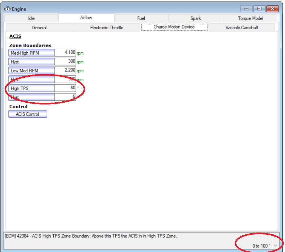

    For now I am going to leave ACIS settings stock (i might move the point of "high tps" down to ~40% from 60 at a later date) and continue my auto trans shiftpoint playing.

    Also @HPTuners is the High TPS a % or angle? unit says degree angle, but range is telling me %

    Very nice write up @nd4spdbh. In regards to your question of the ACIS having enough vacuum to stay open through the entire midrange as @JustDSM has it, I have a vacuum gauge installed between the vacuum port and solenoid and it never looses vacuum once ACIS turns on.

    Good to know! I know the vacuum source comes from what looks like an appendage on the inside curve of the intake plenum (aka surge tank), wasnt sure if it has a one way vacuum valve inside to hold vacuum during times of low vacuum.
