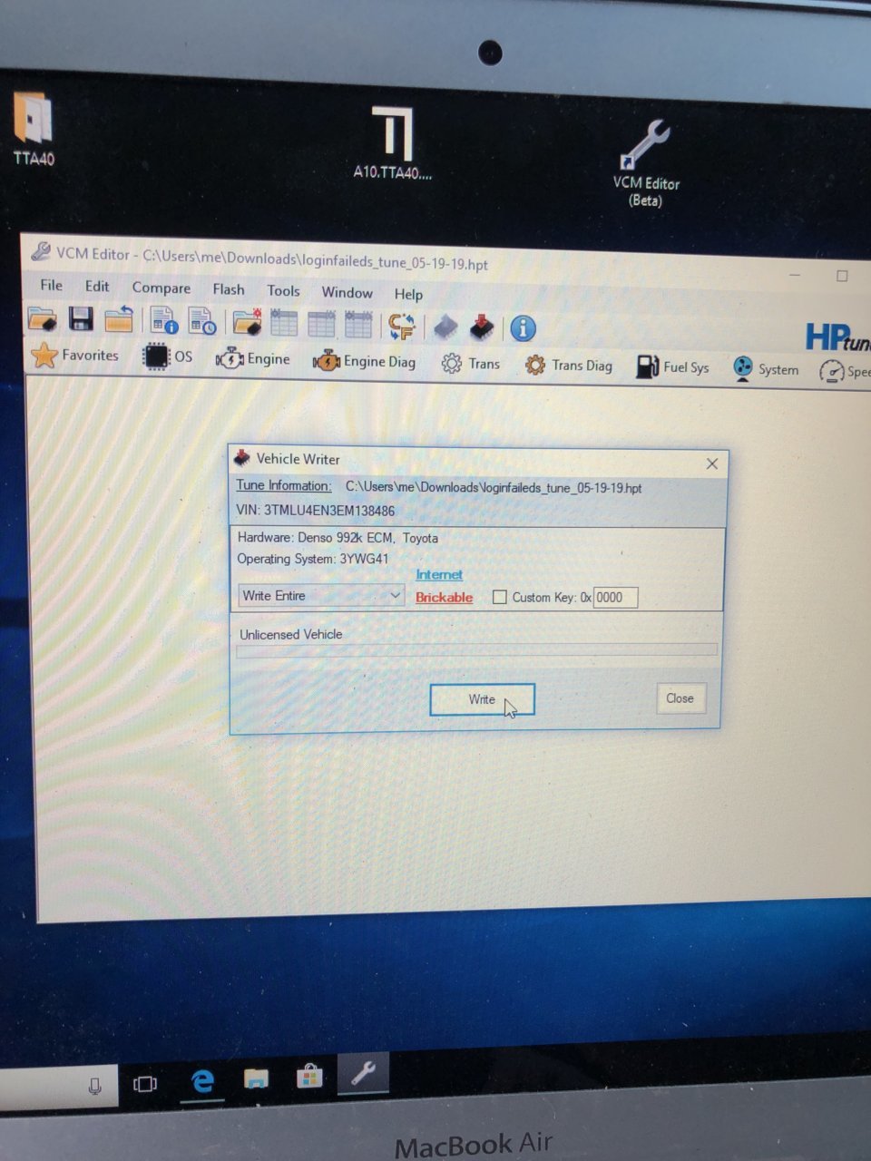

    Just started messing with it today. Wont load Dwayne’s tune. Says its unlicensed but I registered the device.

    I was able to read my ecu and I saved that file. Then I had the issues

    You can’t load his tune directly unless you pay an additional 2 credit “fee”.
    You’ll have to manually copy/paste the modified values into your stock map, save that as “your tune”, then load that file.

    As in every single thing or just one go copy and paste?
