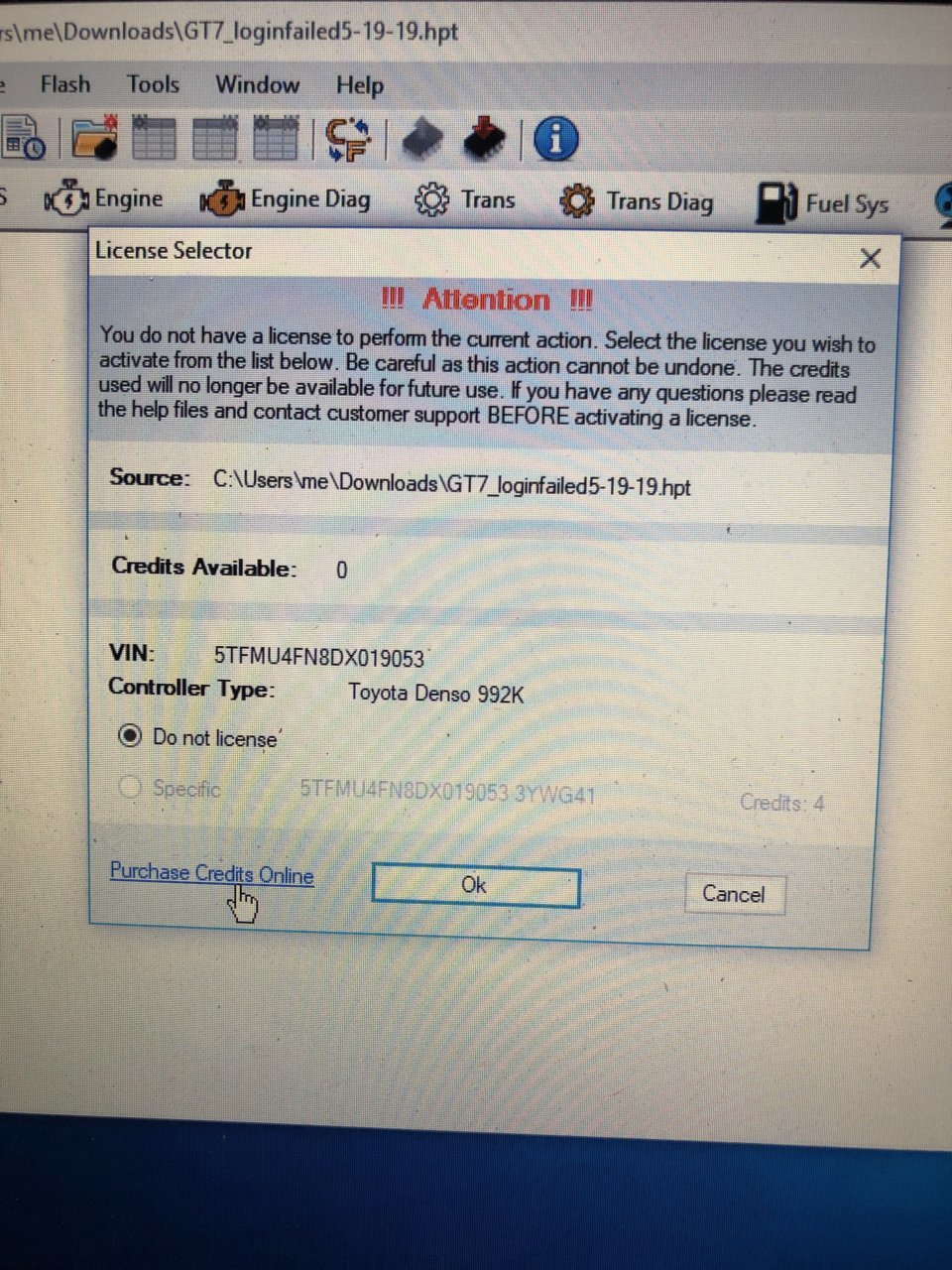

    What’s the ticket for?

    Wont let me write the tune because Im not licensed. But my vin and credits are there but greyed out

    You can’t write my tune directly you have to copy my values to your read file.
    Edit: never mind, I see Justin helped you merge the data over. Don’t worry, @HPTuners will get it sorted for you pretty quickly!

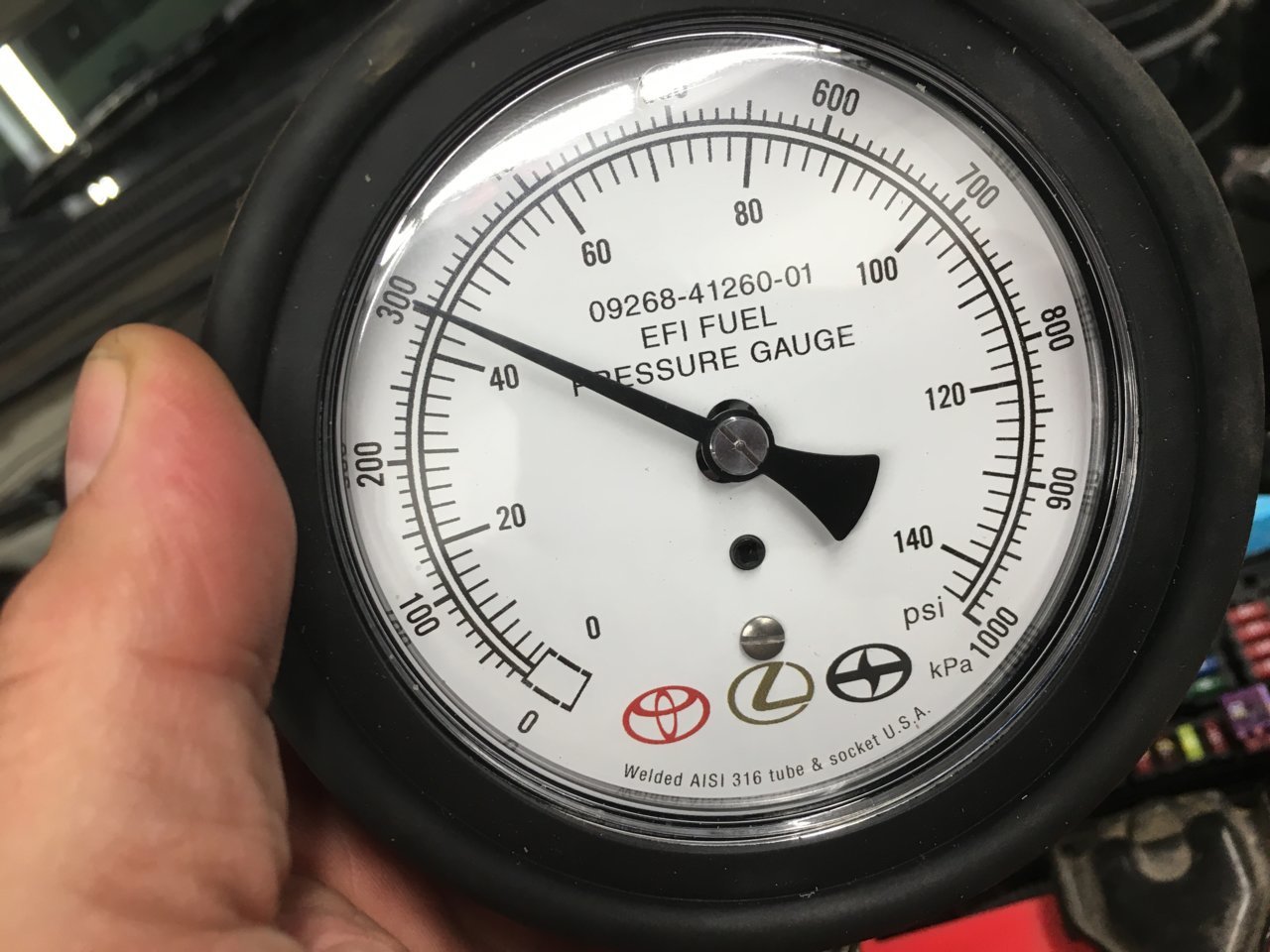

    Hey everyone. I could use some help chasing down what has proven to be an elusive problem. And, I can’t really get on board with tuning until it’s resolved.
    What I’m up against is high fuel trims (20%) in the higher vacuum areas. Idle and off throttle decel mostly. I’ve searched exhaustively for vacuum leaks. I’ve clamped every hose there is (Pcv, brake booster, evap, bypass actuator, even the boost pressure port that runs to my gauge.) I've gone hunting everywhere with brake cleaner looking for vacuum leaks. Nothing. Throttle body gasket is good, I checked that too. @JustDSM had suggested a dirty/bad MAF. So, I cleaned mine. No difference. So, I replaced it with a brand new OE part. No difference. I figured there could be a fuel delivery problem. So, I checked fuel pressure. It’s perfect. I’ve even handed it off to a Toyota master tech to have a look at. He tested the a/f sensors as well as the rear o2 sensors with their fancy techstream computer. They’re fine.
    I’m really just stuck. Anyone else seen something like this before?
    The truck runs fine. I should mention that. Aside from The programmed in faults with the trd tune. Which I’d like to fix.
