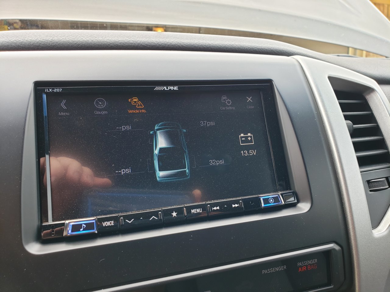

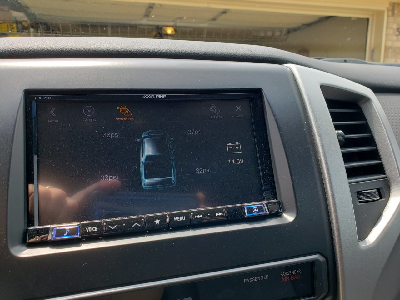

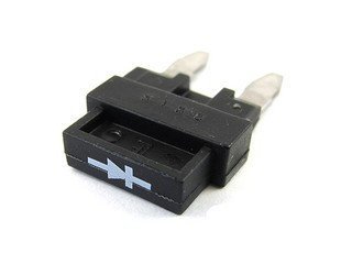

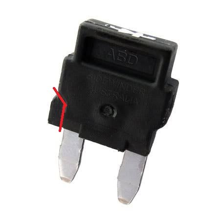

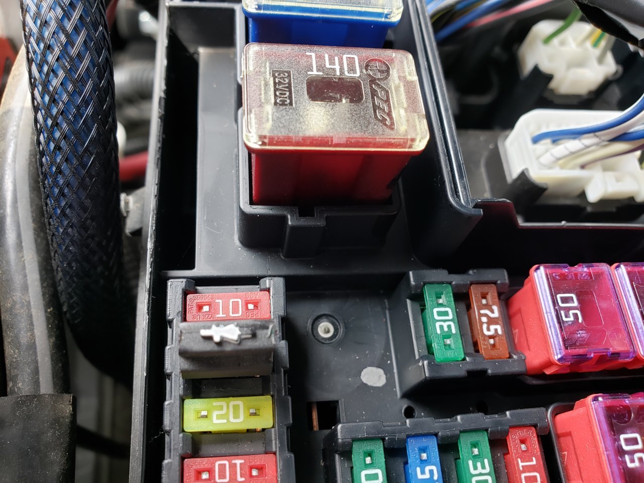

    I used a diode that looks like this http://www.sidewinder.com.au/page159aa.html
    I cant find where I ordered it from and it doesnt have the part # on it. Grrr. It was only a few bucks.
    The best way to install it would be to use an inline add-a-fuse connected in series to the alt-s circuit and install the diode in the add-a-fuse. That way voltage gets boosted but the circuit is still protected with the OEM fuse.

    Off topic, but does the 2015 show the TPS for every tire on the screen? I'm jealous if that's true.

    Nope. Aftermarket stereo

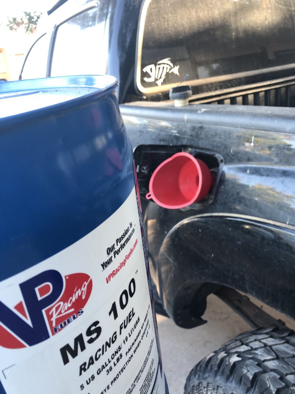

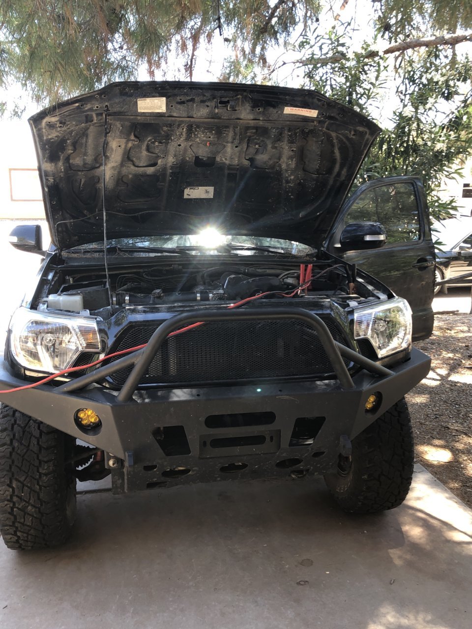

    Got off early and writing the tune! :bananadance::bananadance:
    Edit: the rear passenger tire got nice n warm. Need a trutrac like whitelightning said or a locker

    That looks exactly like the 1 amp I posted, probably the same. I took a file to the plastic on the one side, slipped right in

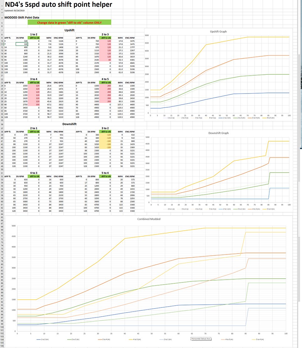

    BACK TO TUNING.
    See attached for my current auto shift point helper excel doc.
    Note: I work off of difference values as its easier to see how much has changed (using a compare file - stock cal - in HPTuner software). Difference values noted in the excel doc are my latest changes that are currently on my truck. Only thing not shown in the excel doc is the TCC apply and release graphs (ill add these over the weekend or next week if i get a chance)
    Paired with the changes to shift points in the excel doc, i have also changed:
    • 5TH TCC Apply = +125 @ 0 to 18 and +75 @24
    • 5TH TCC Release = -300 0 to 42
    Notes on the doc:
    • Upshift and Downshift graphs have "ghost lines" of the stock data points
    • 3rd graph is MODDED shift points only ("ghost lines" proved WAY to many things going on)
    • Changes ABOVE a difference value of zero will result in that cell getting highlighted in RED
    • Changes BELOW a difference value of zero will result in that cell getting highlighted in YELLOW
    • 2nd sheet provides all the raw stock data and interpolated data that lots of the values and graphs are made from
    • Stock shift points for NA and TRD cal are the same from what i have seen.
    Any questions, explanations, or additions feel free to hit me up!

    VERY NICE WORK!!

    Did you get arrested? No follow up pics.

    Didn’t see a single officer. I haven’t driven my truck in like 3 weeks and I had in the garage so I thought why not give it some good stuff

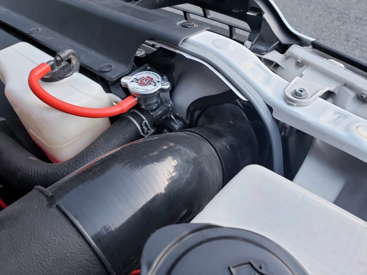

    Custom oversized intake tubing installed going to an afe stage 2 air box and a tundra 76mm throttle body. Recalibrated maf tables to match with a tundra maf sensor. Will post more pics and go over what I did when cell service is better. 20190525_154459.jpg

    Man that looks sweet. I am hoping to do the same although with the gt momentum intake the large oval opening makes it challenging to find the correct fitting reducer. I did something similar to the front port of the airbox.20190503_195017.jpg

    Well that is rather interesting. I like that.

    Looks good. Why the MAF extension wire though? Does the tundra MAF have a different female plug than tacoma?
