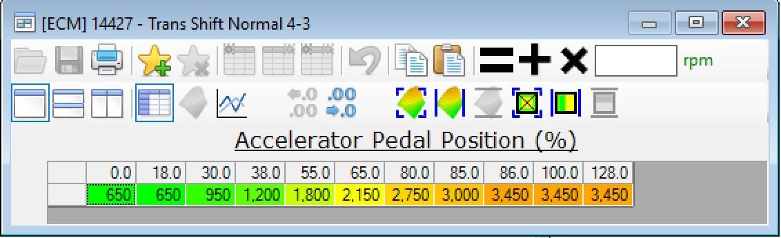

    I think you can make it hold 4th longer (delay downshift) by adjusting the 4-3 table.

    If you look at the table, the top row is pedal position and bottom is driveshaft RPM. I haven't put much thought into it because I've had several adult beverages today, but I think if you increase the RPM in the bottom row it will take more pedal for it to downshift. More smarter and more sober people can correct me if I'm wrong!

    Unfortunately NO, not how the auto trans logic is setup in our trucks, now if it was a 3rd gen 6 speed you probably could, as their logic is completely different, I know lexus vehicles like a GS350 when put in manual mode will hold a gear when you mash it, you can lug the vehicle in 7th no problem haha.
    But like stated you can hold onto 4th gear longer, by LOWERING the values in the 4-3 table. You have AP % and then associated Driveshaft Output rpms (just like every other shift table). But for the downshift tables you have to think of it opposite as the upshift. That is, for downshift the driveshaft rpm has to be below the value for the AP % for a downshift to occur, if its above that value for a specific throttle input a downshift wont take place.
    For upshift tables, driveshaft rpm has to be ABOVE that driveshaft value for a specific AP % for the upshift to occur.
    If you take a look at my big Auto shift point Tuner excel document you can see the changes I made to upshifts and downshifts. 2 to 3, 3 to 4, and 4 to 5 have all been raised at lower throttle openings to raise shift points 2-5mph, and the 3-2 downshift values have been lowered to reduce some hunting in the 2 and 3 gears.
