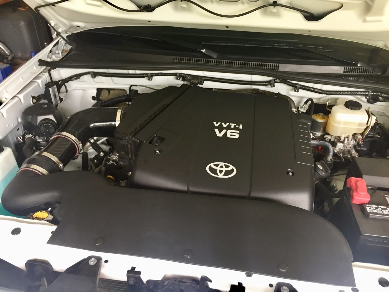

    Nice! I'd done that several years ago, but it wasn't nearly as purdy as that. I ran it for quite awhile trying to see if it ran cooler IAT numbers, but it wasn't significant, a couple degrees when running down the road over stock. Then I ran some 1/4 mile numbers with it against my G-tech and it didn't show any improvement over stock. So I sold it, got my money back, went back to stock and eventually went with a URD intake.

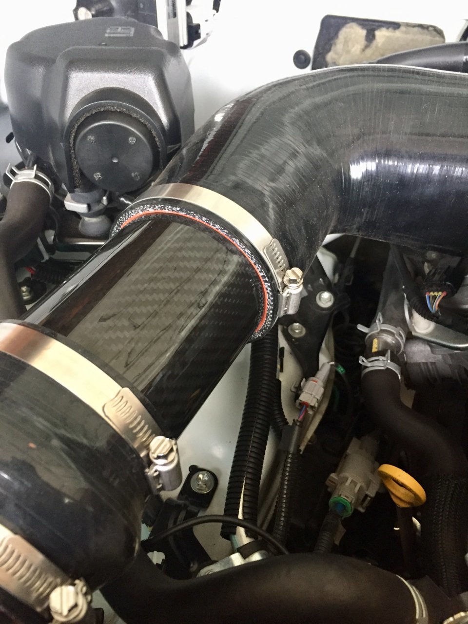

    I went into it not expecting much, and you could say I wasn't disappointed :) It gives the truck a little extra at speed that the totally stock intake didn't have, but I'd say it's just like all the others as far as performance goes. The look is clean and it keeps the intake at 3.5" rather than necking down to ~2..2.5" like the stock tube. I'm pretty certain I'm going to push the N/A boundary to see what I can get out the 1GR now that a viable tuning option exists to see where we can go.
    I actually acquired a spare airbox, and hacked it up, removing the resonance chamber and secondary air filter too.

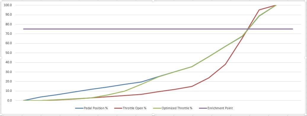

    I really want to see the old trucks calibration now. This is interesting. I've created a spreadsheet to compare and help visualize the throttle/pedal relationship (2015 stock throttle vs. aggressive mapping). Here's a screenshot of that utility.
    Blue: Pedal Position
    Red: Stock Throttle Output
    Green: Optimized (aggressive) Throttle Output

    Is the green Optimized over your initial experiment?
  12. Apr 5, 2019 at 7:15 AM
    #312
    JustDSM
    JustDSM Oderint Dum Metuant
    Jan 16, 2015
    #146525
    3,278
    Justin
    Ogden, UT

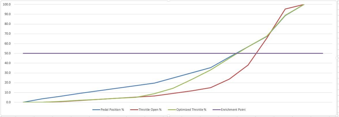

    Yes. Initially I admittedly went a little too aggressive and it was a bit of a pain to drive in town. I'd feel pretty comfortable giving someone that throttle mapping (chart above this post, not the one posted here) as an "aggressive" mapping. I intend to tame it down a little bit more for those who might use 4Lo and need a bit more forgiving throttle for control at lower pedal input. Originally, what I tested (see below) was more closely related to 1:1 from about 15% pedal and up. Again, much to aggressive considering where the pedal is during normal driving.
