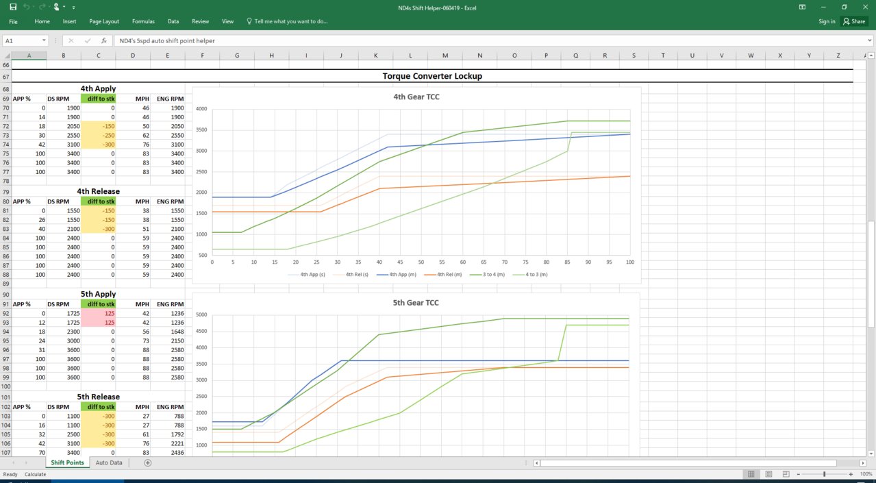

    SoCal
    13 DCSB TRD OR v6 Auto
    As promised an update to this!
    ND4's shift helper doc NOW With added TCC 4th and 5th charts with stock data point ghost lines! Upon making the charts I revised my TCC apply for 5th (its nice to be able to see how things interact graphically), and have started to play around with TCC apply and release in 4th gear. I am currently on my 9th revision of trans tuning that has been flashed to the truck. The goal here with playing with TCC values is to get 4th and 5th to be in a state of lockup more often, without making the truck awkward or behave in weird ways. Stock I often find myself when going up a hill dropping to 4th, getting my speed that i want then having to back off throttle for a bit so TCC locks then I can get back into it. This keeps trans temps WAY down, the changes i have made SHOULD help with this, as well as rolling on in throttle without having it pop out of lockup so easily in both 4th and 5th.
    Note: Even stock there are some things that you might look at and go HUH? Like a TCC apply value LOWER than a value of a shift up to that gear etc etc. From what I can tell the logic of the trans is to NEVER allow a shift occur with the TCC locked. Also, and this has already been pointed out but im going to bring it back up, lockup can only occur in 4th and 5th during normal non fault driving.... really wish there was a way we could get lockup for 3rd, but o well.
    At this point I feel pretty confident in the actual shift point changes, so ill likely NOT be changing anything there for the foreseeable future. TCC apply and release values are obviously still in the works!
    All the data is there in the attached excel doc for anyone wanting to try out my shift point changes with whatever tune they have going on. If you are having trouble, questions or simply want me to input the numbers into your tune just let me know!
    (NOTE: I have formatted the excel doc to be useable at 100% zoom on a 1080p screen at 100% dpi scaling, most desktop computer monitors will display it perfect as far as width, laptops with 1080p or greater displays will likely have some greater dpi scaling so you might have to zoom out to see everything width wise)
