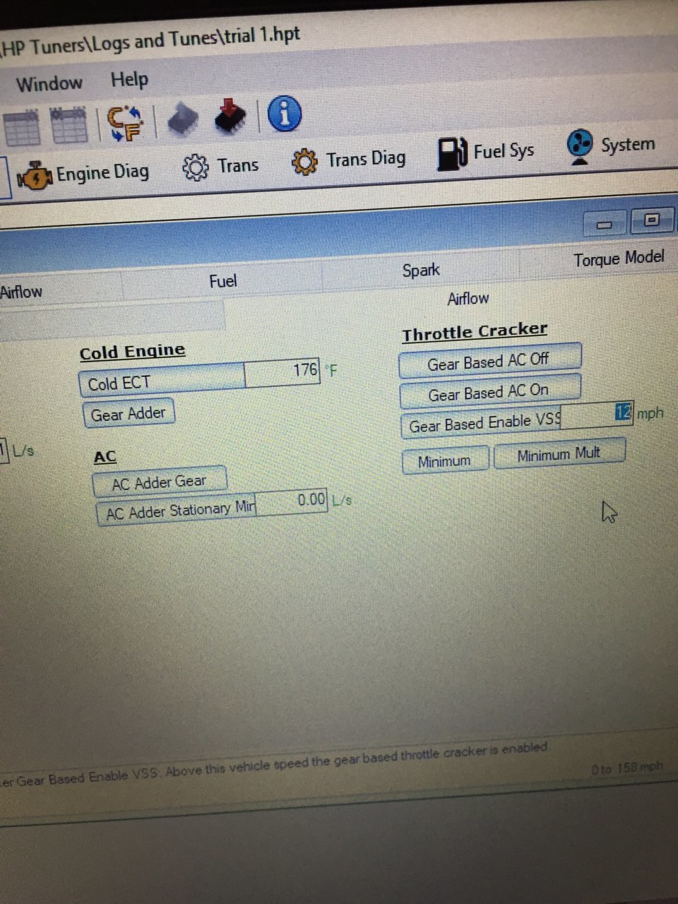

    Let me know what you think and if you make any changes to what I posted up as im always curious as to what others think / could implement those changes on my truck ! Glad the excel doc made things easy, and I hope it made sense as far as using difference values.
    FYI still rocking the changes I posted in post #3223 https://www.tacomaworld.com/threads/hp-tuners-for-2005-2015.600793/page-162#post-20781692 for the last few weeks and am loving it, The extra throttle input you can give now in 5th and keep it locked is SO NICE, and now with 4th locking sooner, hills are a breeze. Probably doing a mammoth snow ski trip this weekend which will be a good long distance test of that exact trans tune.

    To follow up on the rev hang tune, it's great. I never had rev hang from 1st to 2nd, and 2nd to 3rd, only 4th and 5th, which is gone now. I am going to leave mine exactly how it is now as the revs drop perfectly for me in the higher gears.
    I have a hard time believing that the stock rev hang was for smoother shifting or for less shock for the drivetrain because, why didn't my truck have that rev hang in the most critical 1st and 2nd gear?

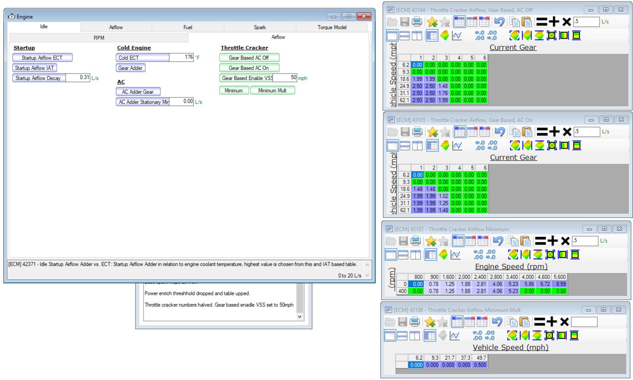

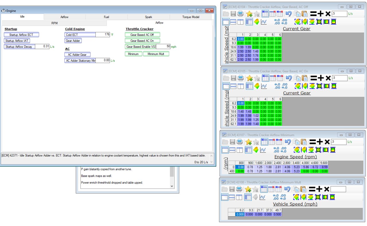

    Thank you Chris!!! You're my hero!
    So, I went ahead and halved all the numbers in the tables and then upped the gear based enable to 50mph.
    Haven't flashed it yet. Anyone see any glaring errors here?
    What changes have y'all made?

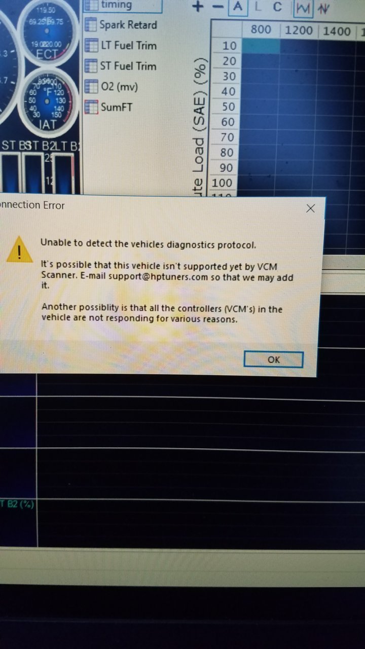

    mightytacoman
    mightytacoman Mighty-known Member
    Apr 3, 2013
    #101270
    2,412
    Kel
    4.5L 1grfe
    Brian Crower stroker kit, Carrillo pistons moly/ceramic coated, BC sportsman rods, arp s2000 head bolts, Darton M.I.D sleeves, Kelford race cams, Magnusson supercharger, hp tuner tuned, 650cc flow matched fuel injectors, CSF radiator, Walbro 255 fuel pump. pulleyboys quick change pulley with 2.3", fpr mod, NST crank, water and alternator pullies, 160° mishimoto thermostat. Puma On-board air, Radflo CDC ext coilovers with 14" 700# springs, extended length rear Radflo shocks with CDC, Dakar leak pack, Brute Force Fab front bumper galvanized and powder coated, DTRL mod, yellow fogs, fog anytime mod, relocated rear differential breather, synthetic fluids, custom airbox, tundra sized intake. 76mm throttle body, secondary air filter removed, Airflow snorkel, 4x innovation sliders powder coated, URD equal length headers, DT y-pipe, Aero-Turbine 2525xl exhaust dumped over axle, seat belt chime disabled, Warn 8000i winch, 1- 20" slim light bar in grill, 42" curved roof light both with custom brackets. Mesh grill, Brute Force Fab rear bumper with extra reverse lights, u bolt flip kit, SS extended brake lines, hockey puck bump stop extension, AT shackle flip kit, Light Racing UCA's, 4crawler 1.5" bodylift. custom built front and mid skid plates, re-geared to 4.56s, windows tinted 25%, Sony stereo, 8" skar sub-woofer, 1000 watt mono amp, retrofit headlights with legal demon eye, Kryptek Marathon seat covers. North Star agm 27f battery, Helo 791 rims, 315/75/r16 Mt/r ARB front air locker
    Anyone else have this problem and find a resolution? My other scanners hook up just fine.20190618_055020.jpg
  14. Jun 18, 2019 at 1:33 PM
    #3434
    HPTuners
    HPTuners Well-Known Member
    Apr 8, 2019
    #289489
    74
    Try resyncing your interface (Help -> Resync Interface). If that doesn't work please open a support ticket and include the debug.dat file (Documents/HP Tuners/Settings/)
