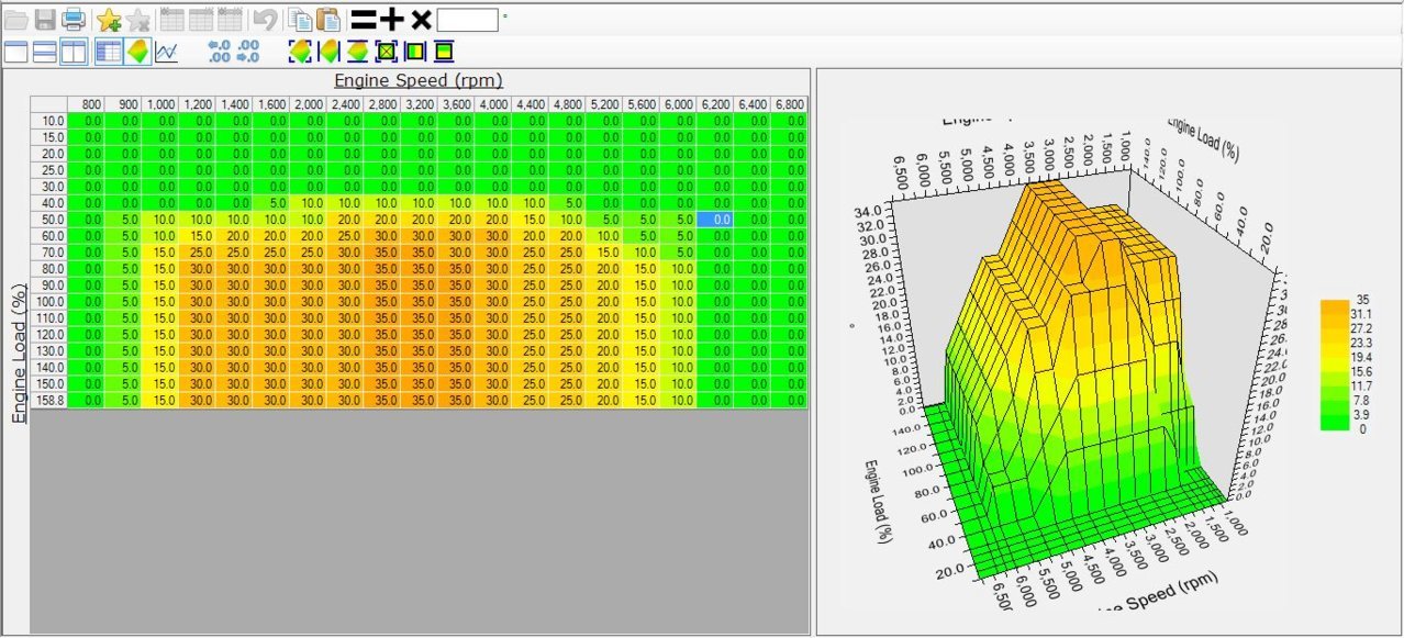

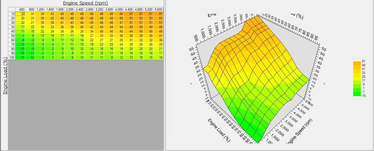

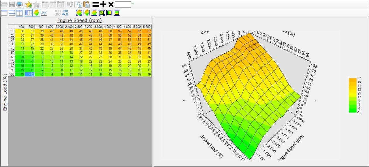

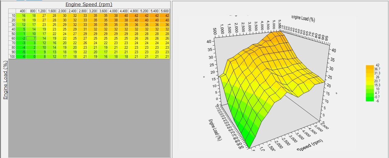

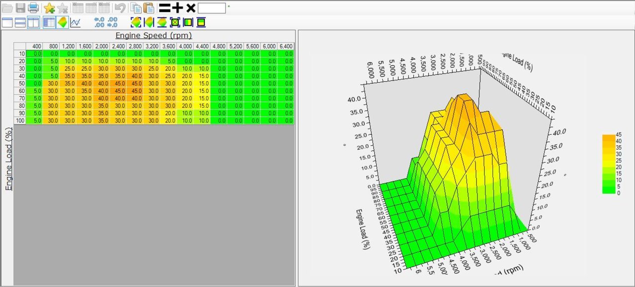

    Here are the main differences. There are a few others, but the stuff of interest is likely going to center around these:
    TRD VVTi
    TRD Base Ign Timing
    TRD High Octane Timing
    N/A VVTi
    N/A Base Timing
    N/A High Octane Timing
  16. Apr 6, 2019 at 4:00 PM

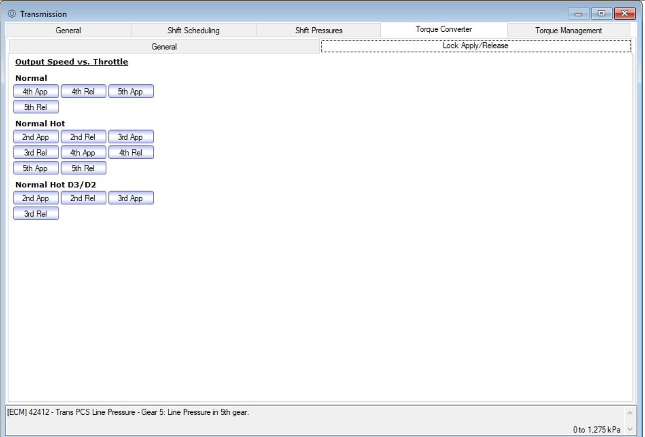

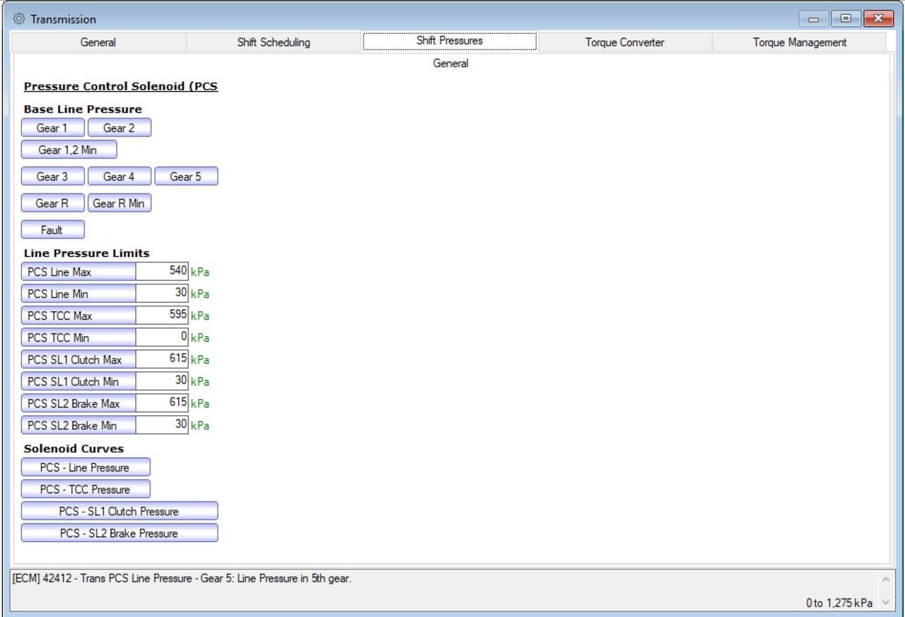

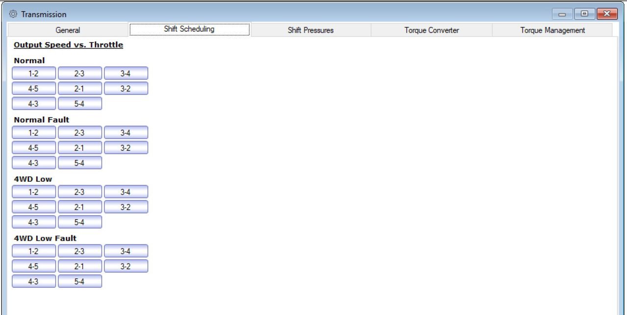

    I don't have an auto vehicle that I can mess with, but I can assure you that the tables available (posted earlier in this thread) do what they say they do. Currently shift time isn't adjustable/defined, but you can increase line pressure and other things to firm shifts.
    If I can get a calibration from an earlier truck and confirm the shifting algorithum or throttle mapping is different, you can apply those values into the newer truck and get that feel. I think you can improve things, I don't think the Toyota transmission has quite the complexity so adjustments are somewhat limited, but perhaps we'll see further refinement to the definitions in VCM Editor which enable us to make changes which are not at this time possible.

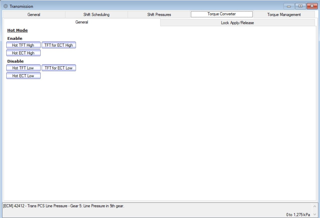

  17. Apr 6, 2019 at 4:10 PM
    #357
    loginfailed
    loginfailed Well-Known Member
    Aug 29, 2016
    #195923
    5,156
    Dwayne
    Houston, TX
    2014 DCSB 4WD
    Here's a peek.

    You 100% certain that the TRD High octane map is not accidentally a duplicate photo of the N/A timing map?
    Since the TRD High Octane screen shot only has 100% load, but the TRD VVT-I map goes to 150%, as well as the low Octane.
